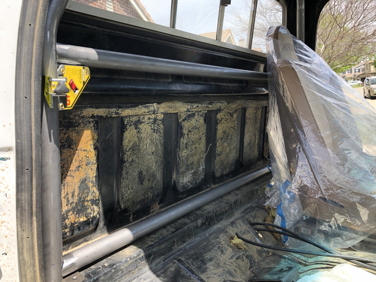

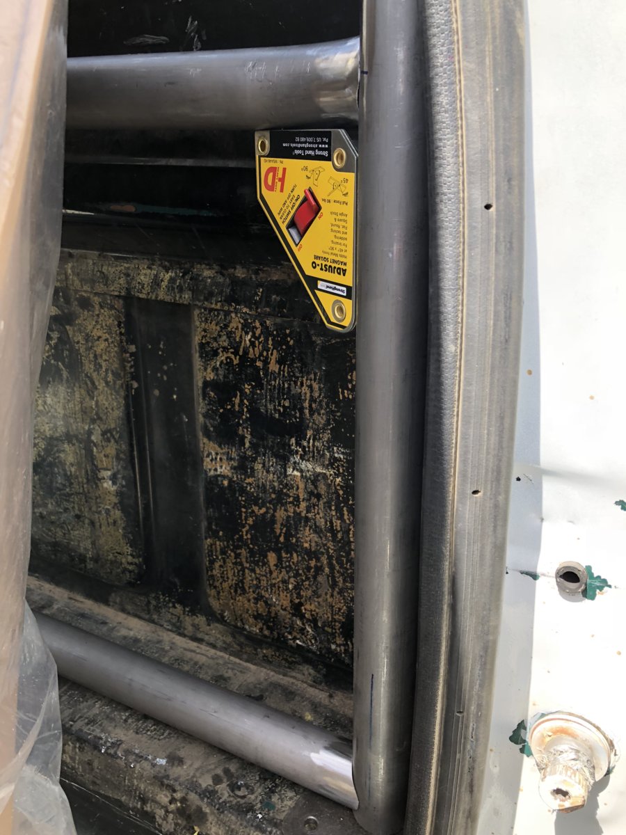

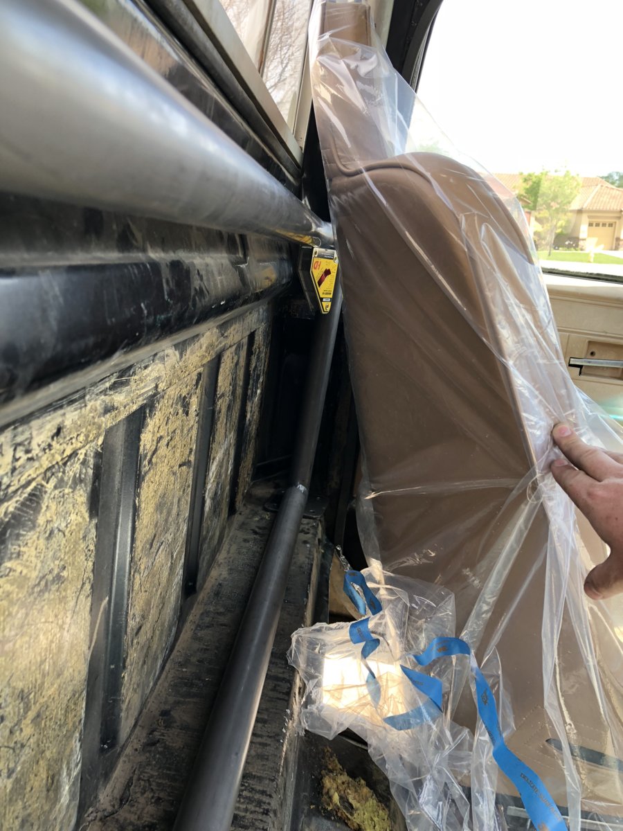

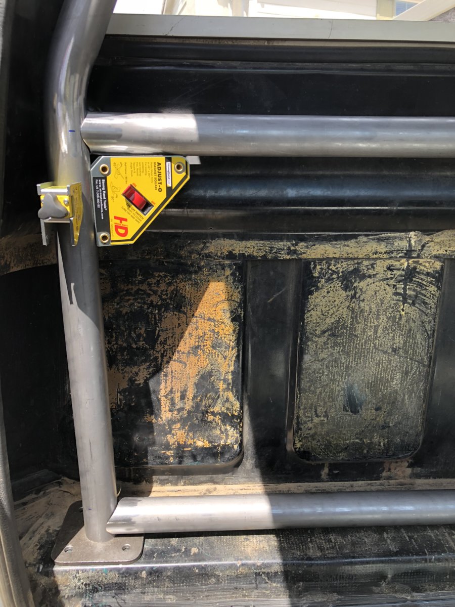

I put a couple 35 degree kicks on the harness bar so it hugs the back wall a little better. In these pics the B pillar is leaning forward a bit, I didn't notice that until after I took these pics.
