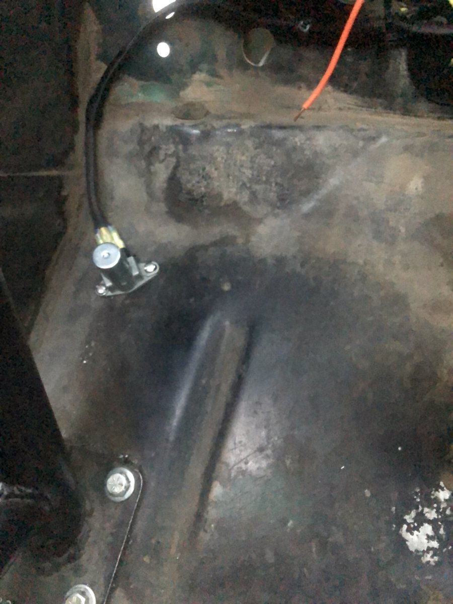

Painless switch installed on the floor, it's officially an old school square now.

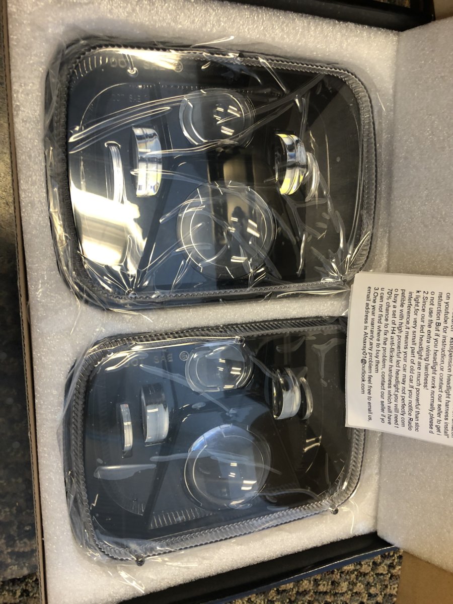

When I was testing the headlight wires making sure I had the right High/Low beam wires I found the high beam on the DR light was not working however the PS worked fine. After installing the switch I found both high and low came on together on the PS :dunno: Voltage checked out fine with the one leg hot so it must have been something fubbard in the headlights. After some research I found several complaints about the lights I had so I bought another pair with better reviews. Hopefully this fixes it....

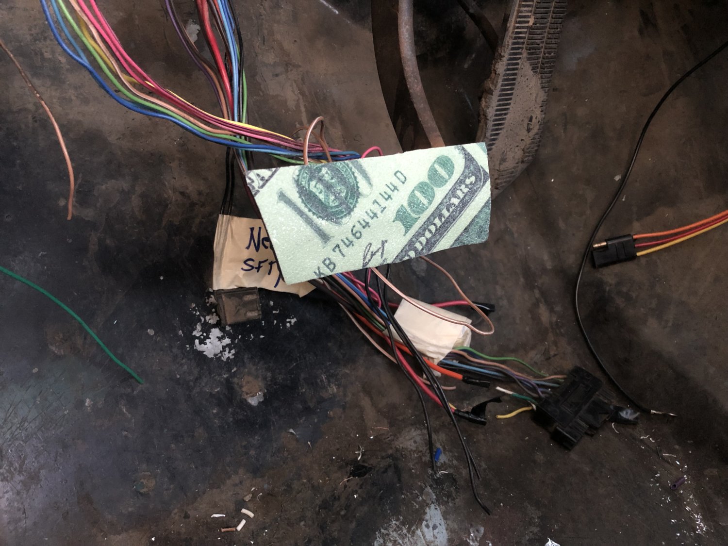

Pretty much all the wire is pulled back to the control panel so I need to spend an hour or two plugging in wires, terminating a few and running power/speaker wire for the stereo. Getting close.....
At first I thought you just had some random $100 bill lying around. :haha: I still prefer the foot dimmer switch.
would be funny to catch some idiot trying to reach through my tube doors for that bill :rotfl:
