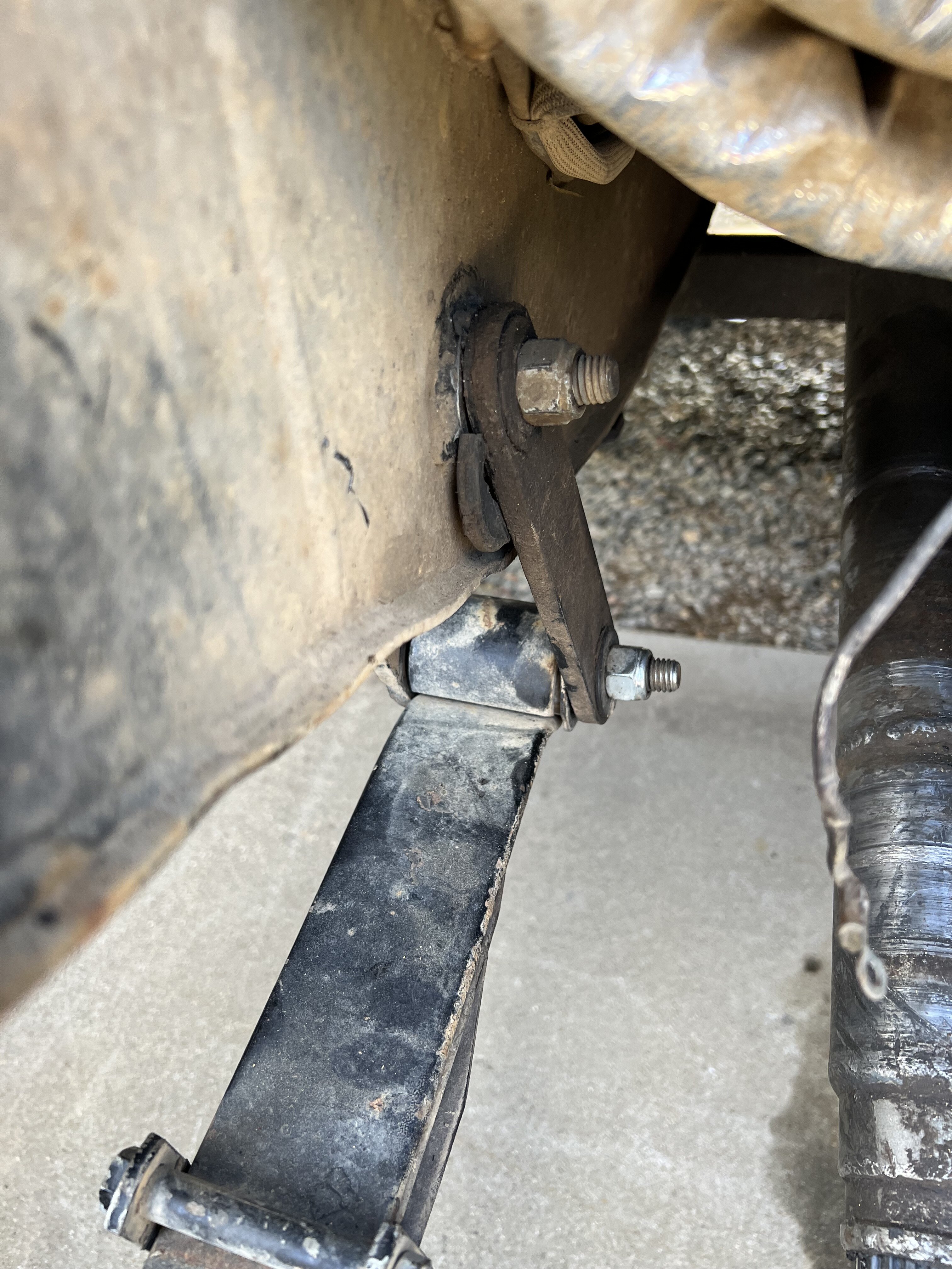

For some reason I used torque converter bolts without a flange so I'm not surprised they came loose. I ordered the correct bolts yesterday along with header wrap (protect the transmission), 3" collector gasket for the 2 to1 merge, O2 bungs (need to add an oxygen sensor on the passenger bank). I also placed an order with ORD for FUSH/leaf bushings, 6" front shackles and bolts. Both shackles are bent and the bushings are toast.

Pictures of the bent shackles and destroyed bushings. I'm hoping I have better luck with ORD kevlars and their hardware.

I've been using 3/8" x 2" strap for shackles.
I think you're gonna have yours running before I get mine going.
I think will be my 3rd set of 6" shackles, all have been 3/8" steel. Not sure on the width.
Lot's of little $hit to do still, we'll see.....
I forgot you boxed the frame on this, kind of crazy it still blows through the bushings.
It's cool to see the frame is holding up however that might be why I need to swap bushings at least once every spring. Frame flex would remove some stress from those bushings.....I would think :thinking:
I've used ruffstuff and DIY4X bushings in the past and I don't think I've used the ORD kevlars yet on this truck so I'm interested to see how they do. I beat this truck pretty hard, even more so when I'm trying to keep up with all my buddies on links and coilovers.

Pulled the Fitech wiring from the truck and tagged the fuel pump and fan signal wires. Opened the box of ORD parts and realized I purchased the wrong bushings and hardware. I run 9/16" bolts, not 1/2" so I swung by ruffstuff for the correct bushings and hardware. Drilled out the ORD shackles to accept the 9/16" bolts and swapped everything over. Also did some paint touchup while the engine was out, some areas around the hoops had little to no paint.
