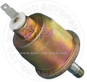

Got the engine set down in the truck today. Layed the wiring harness down across the engine to start finding where things go and have a mystery plug. It goes down the drivers side of the block to just above the oil filter. There wasn't anything there on the engine we took out but it looks like the engine has been swapped before. I was wondering if anyone could tell me what went there?

It has two wires going down, light and dark green I think (been a couple of hours and I'm pretty tired). Large round black plug that looks like it would go onto two male spade terminals. I'll try to get a picture of it tomorrow. I've found the knock sensor wire, oil pressure sending unit wire, temp wire and it's not any of them.

Here's a few pics of the plug. I was mistaken, the wires are two blue wires and one pink/red?

That kinda looks like a glow plug controller plug to me...:dunno:
Rene
this is for low oil pressure switch
it is either located beside the distributor
or right above the oil filter
in out cars we have two oil related sensors
oil pressure sender ( usually one wire )
sends signal to the oil pressure gauge
sends signal to oil light in the dash
GMC500, what does the switch do? I don't have any warning lights or anything turned on on the dash board and the 305 would start and run.
it will let the oil light go on if there is no oil pressure
