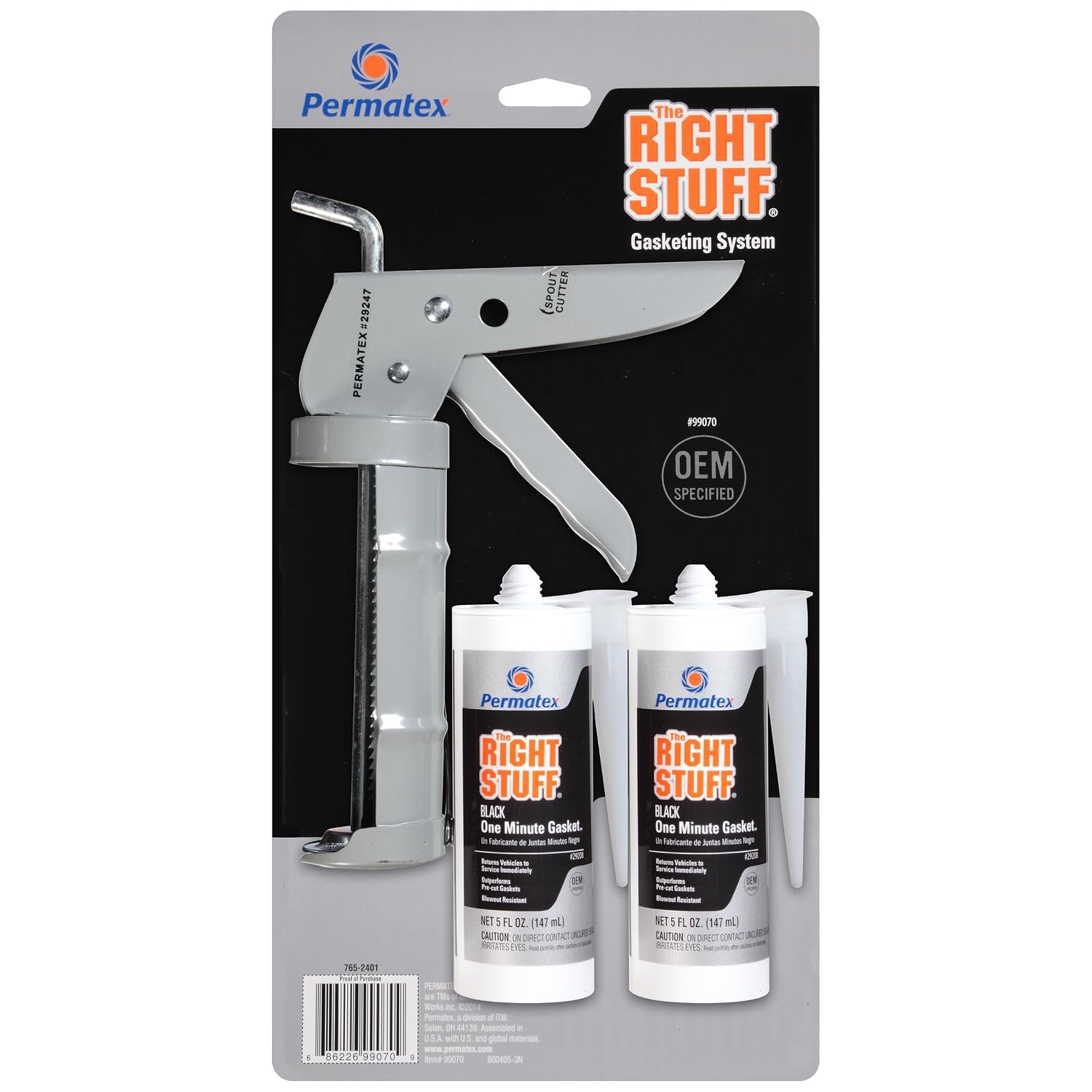

Use The Right Stuff for everything. https://www.amazon.com/Permatex-99070-Right-Stuff-Gasket/dp/B000HBM6PE Not cheap but it never will leak and sets up in a little while. I get this kit at my local parts store but it's probably more than on Amazon. You can also get it in a regular large caulk tube but then you risk it drying up before you use it all. I like the half size tubes. Ford 7.3L oil pans use only silicone and you put it on close to 3/4" thick on the ends and 1/2" thick on the sides and never an issue with this stuff.
