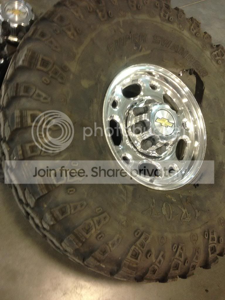

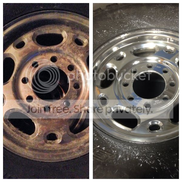

1. Started off with a harsh acid wash letting the acid sit for 30 min or more
2. Applied paint stripper to clean off what ever clear coat was left
3. 500grit on 3" DA
4. 800grit on 3" DA
5. 1000grit tri-zac 3" DA
6. 3000grit tir-zac 3" DA
7. buff/polish with 3' buffer
