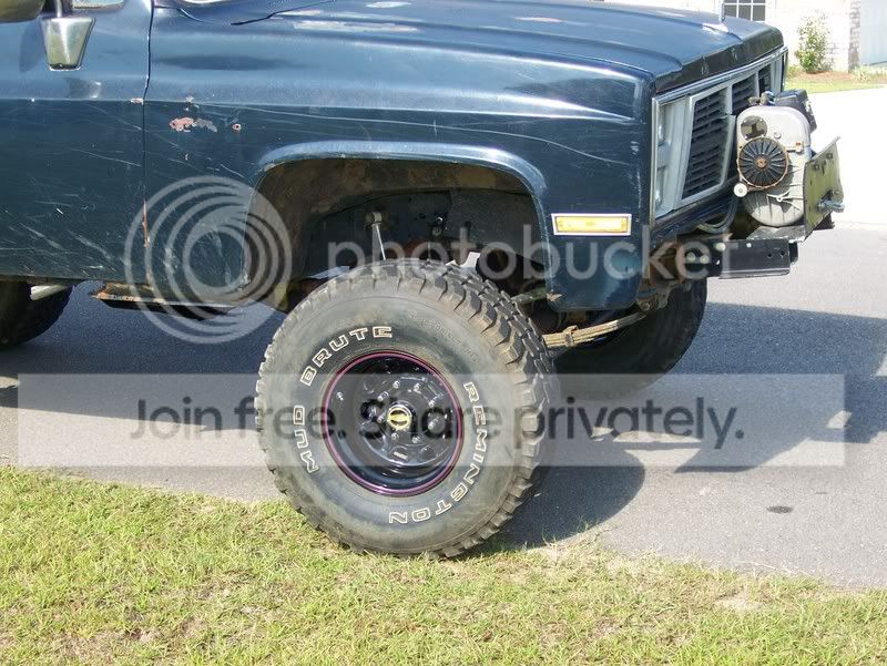

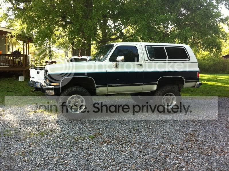

I started with an 85 GMC Jimmy that had a 4" block lift, (yes, even the front had blocks) 35" tires, a tired 305, 700r4, np208, and 10 bolts with 3.73 gears. I bought the truck on 31DEC2005, here is a picture that's probably the weekend I drove it 2 hours home.

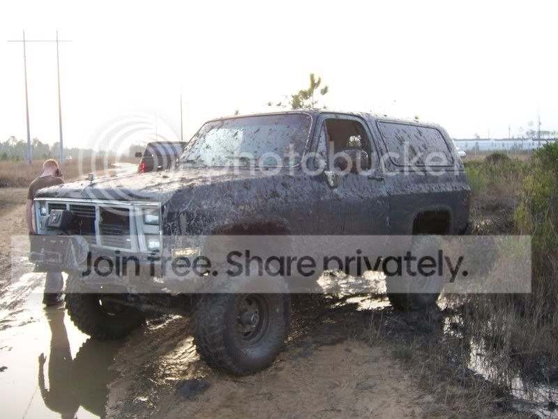

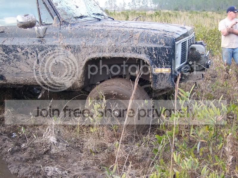

Here are some other random pictures from back then.

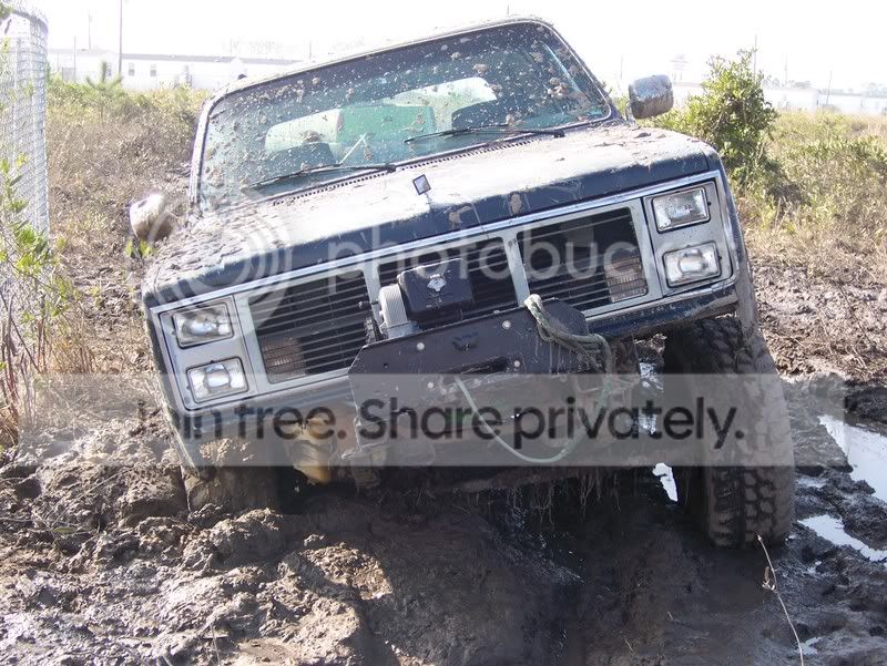

Shortly after installing them I went to bootcamp for the Navy and between bootcamp and A-school I saved some money and got some 6" tuff country ez-ride lift springs for the front, 2" lift springs for the rear, and a shackle flip kit from DIY4X. I also got a Warn 8274 and a center section of a warn bumper and installed them.

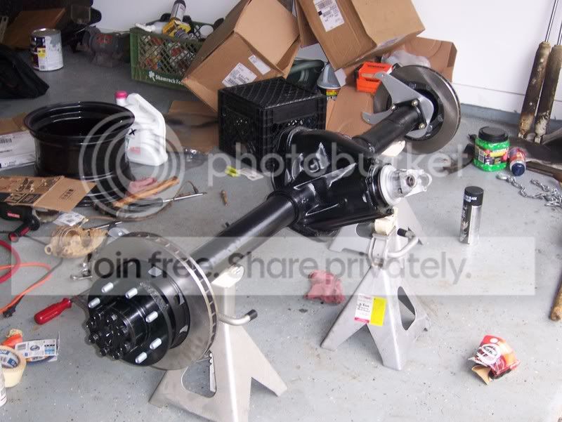

After playing with it for awhile like that, I installed a lock-rite in the front 10 bolt and started looking for a 14bff b/c I didn't want to upgrade the rear. I ended up find one for a decent deal and as a bonus, it already had disc brakes on it. So I got a Detroit for it, then I...

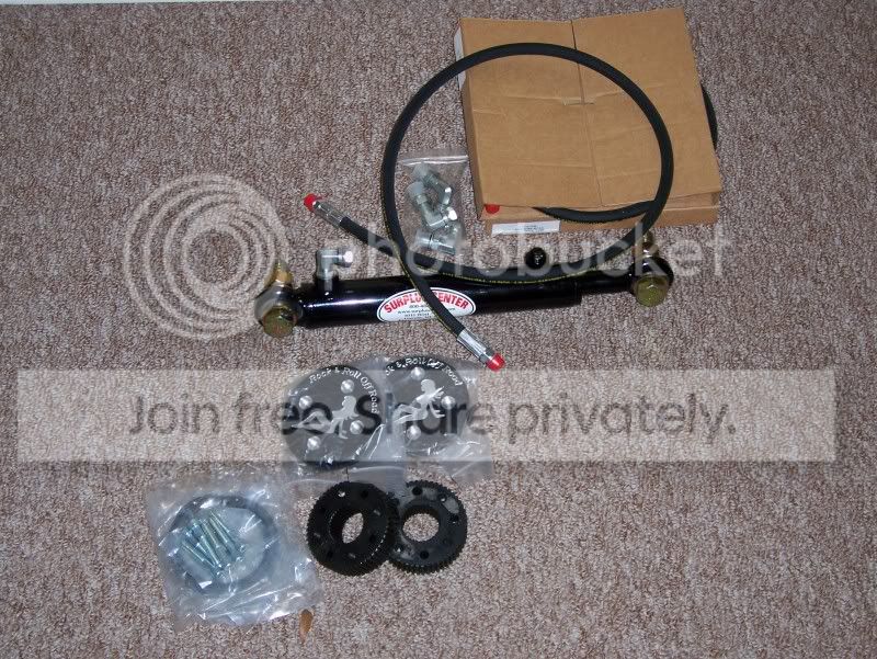

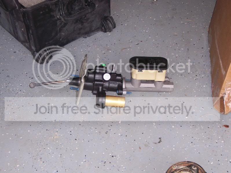

While I was in Afghanistan I started collecting some parts. I got the stuff to swap in hydroboost, a soft top, and a few other odds and ends. Then once I got back I put everything one, along with installing the 14 bolt and converting the front 10 bolt to 8 lug.

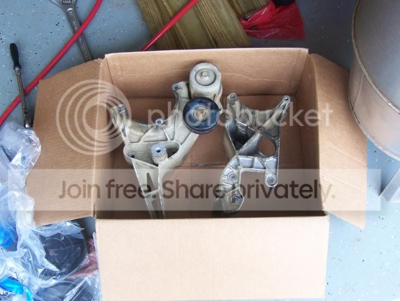

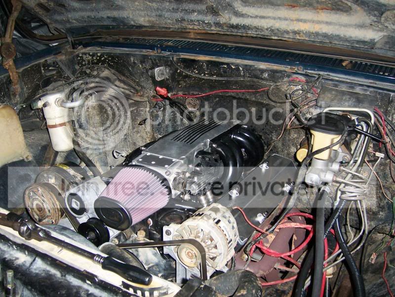

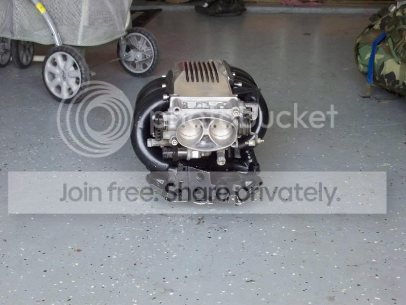

Back when I originally got the crate 350, I decided that I was going to install TPI on it, because I was tired of having a carb. The whole time I had been slowly collecting parts to swap it into the truck.
URL]

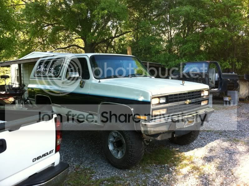

Then I found this 91 Blazer that had a blown up rear end and a bad transmission.

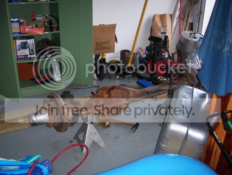

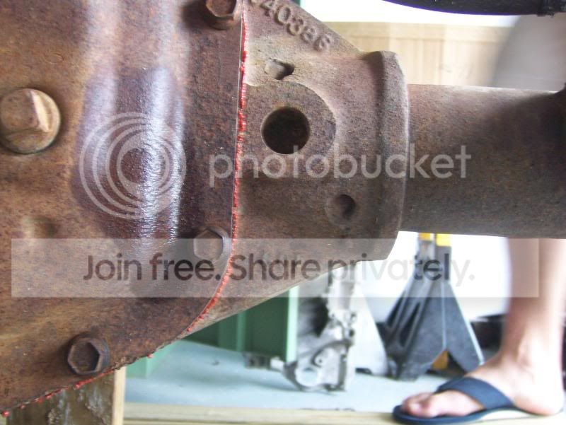

And I also picked up a Dana 60, after breaking a number of 10 bolt axle shafts. It also has 4.56 gear, so I got some gears for the 14 bolt that was under the truck already.
Then started cleaning it up to be installed.

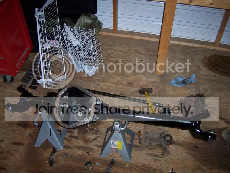

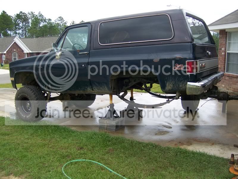

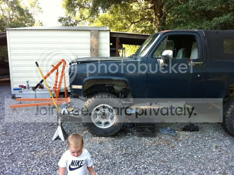

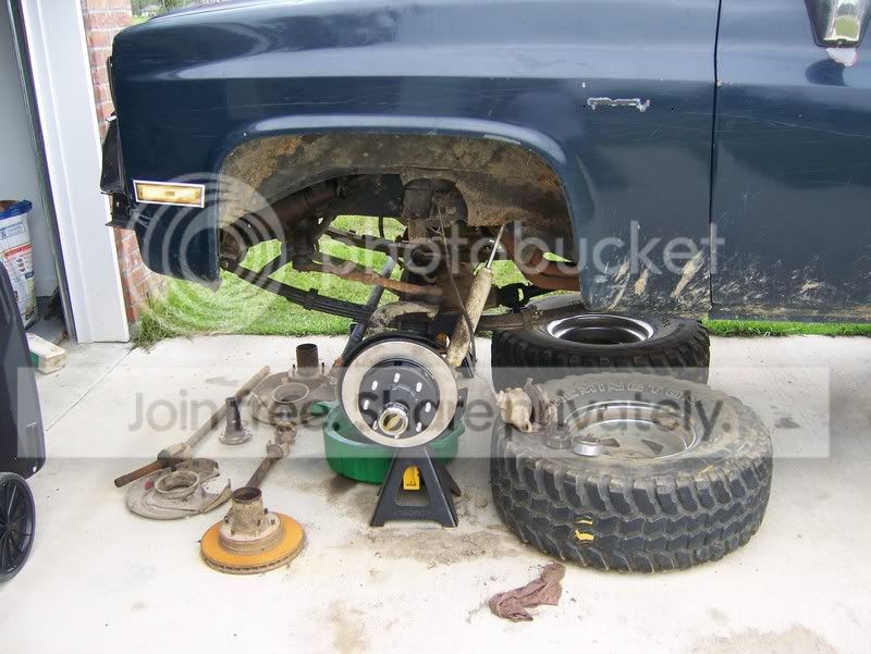

Once back from Guam I took the front 10 bolt out and started installing the Dana 60. While I was at it I installed some 52" springs to try to get some more flex.

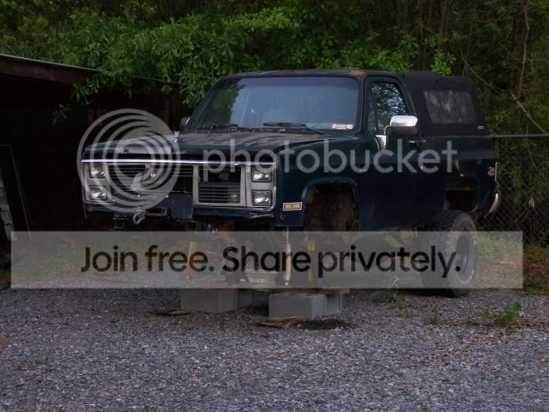

After getting the 60 up front, I took it for a ride and had terrible death wobble, so I checked the caster and it was way off. I ended up swapping from 7.25" shackles to 6" shackles to get the castor correct. I also burned up a fusible link, so instead of chasing it down and fixing it, I decided to put the 91 to use. I had to choose to either swap the bodies, or swap the chassis. Because of the amount of rivets I would have had to deal with I decided to swap the body. :popcorn:
I also seem to do all this work by myself. If I invited friends over to help they'd just drink all my beer while I worked by myself, so I had to build a frame to maneuver the bodies around.
Then I lost interest and let it sit for awhile. After hearing my wife bitch about it just sitting there, I got back on it and finished up the body swap.

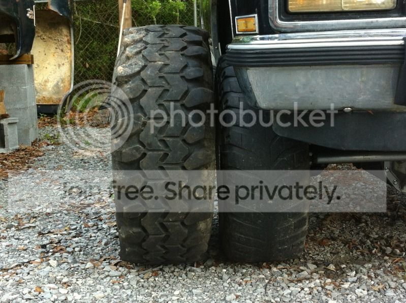

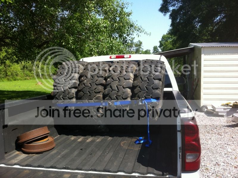

I found a deal on some 39.5" TSL's so I went and got them and mounted them on some 8 bolt hmmwv wheels.
trimming some fenders.

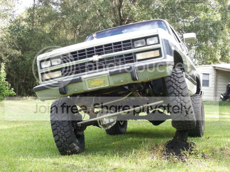

Before I got the tires I didn't know that they had some pretty bad dry rot in the sidewalls, so I decided to swap on my other wheels. I also wasn't happy with the 52's in the front. They felt like they allowed the front axle to move side to side under the truck while turning. So I swapped the old lift springs back in. Then I got some 24 bolt hmmwv wheels with 37" Baja t/a's along with some PVC inserts, so I broke them down and installed the inserts, then put them on.

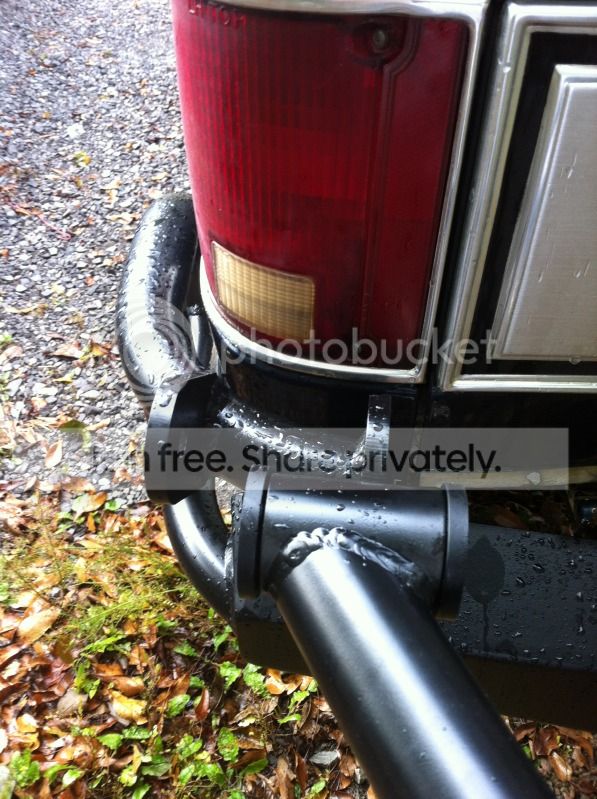

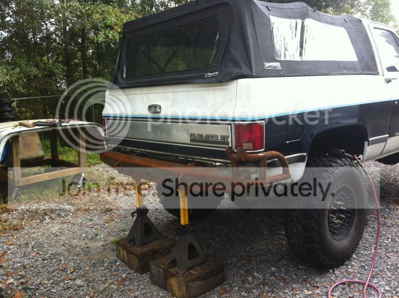

during my backyard flexing I found that my front shocks were limiting my flex, so I got some ford shock towers and some 15" BBCS's from Jek and installed them. I also got and old BlazenOffroad rear bumper that was made for a Suburban, so it didn't fit quite right. So I cut off the tubes that didn't fit, moved them were they needed to be, and welded them back on.

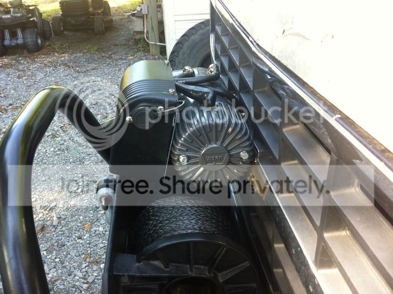

I also rebuilt my old Warn 8274. Instead of getting a stock replacement 2hp motor for it (the old one was burnt up), I got a motor for a Warn 9.5 which is 6hp, I also got a new 8274-50 cover and the industrial solenoids to get everything to work.

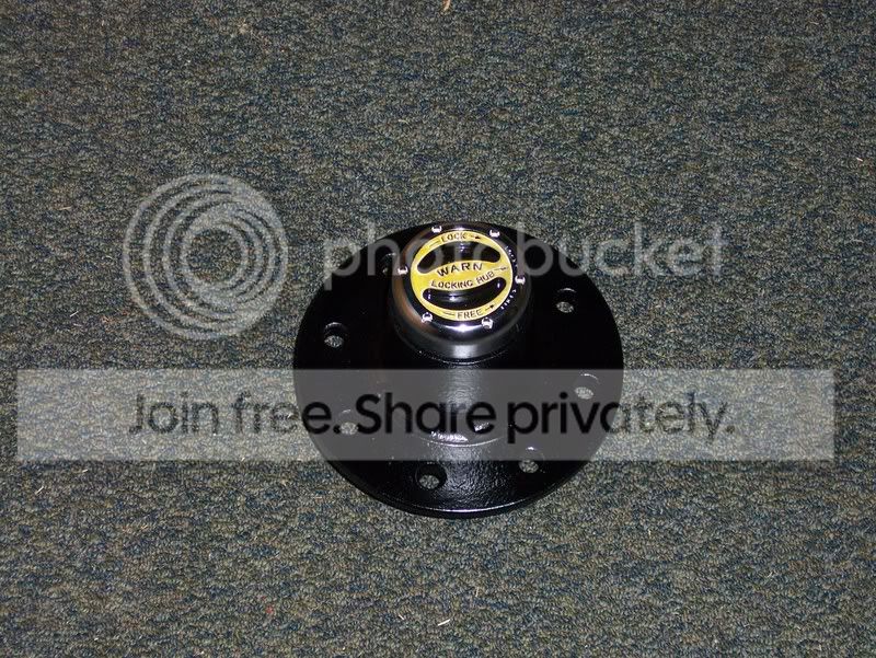

That's where I am right now. Although, I just replaced the drive flanges with some Yukon hardcore locking hubs.

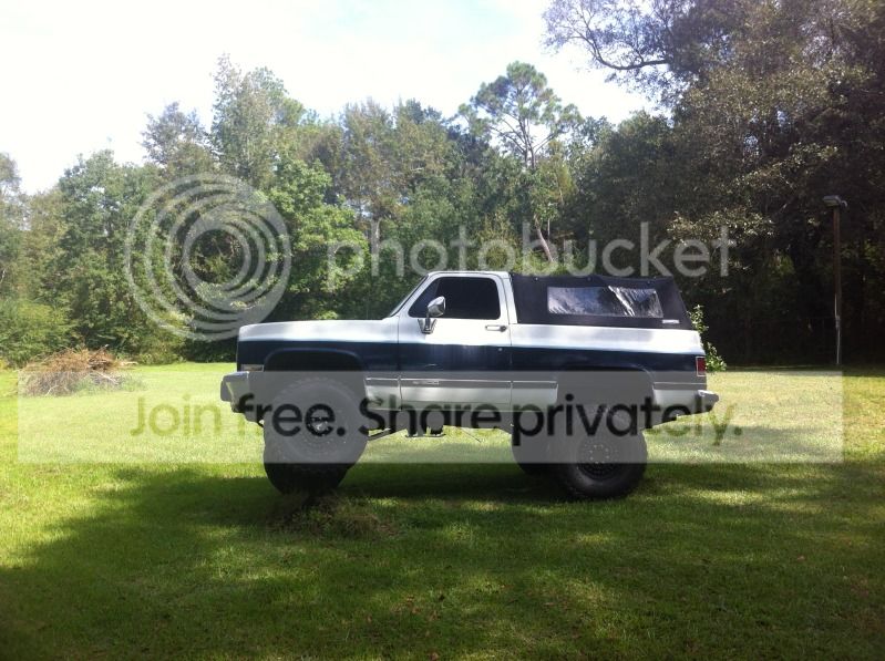

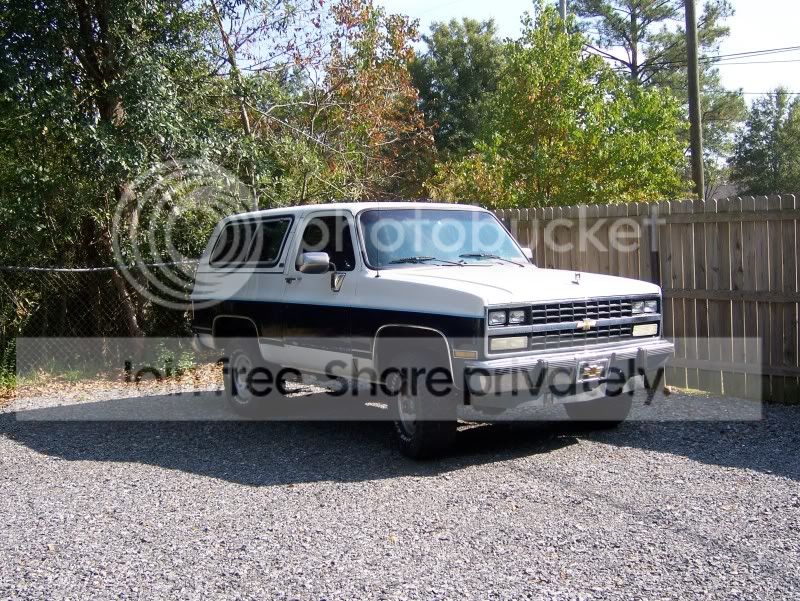

No real update, the wife wanted to get some pictures of the kids. So I decided to bring them out to a place that I used to go hunting. I did notice that a vibration that I had, that started around 50 mph is now gone. Either the new transmission mount or maybe putting in the driveshaft 180* from where it was must have fixed it.
I do need longer brake lines though, the front left is stretched tight in this picture.
