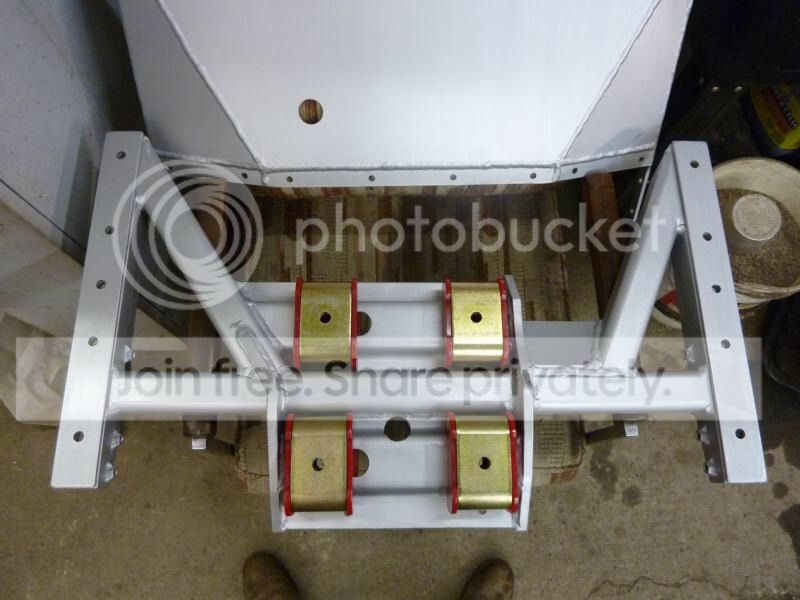

Anyway, I got the doubler in tonight. I'll get pictures when it's light tomorrow. I need to start making a crossmember.

Don't get it too heavy in one giant piece that you can't take it on and off w/o a forklift. Make it in multiple pieces if you need to.
