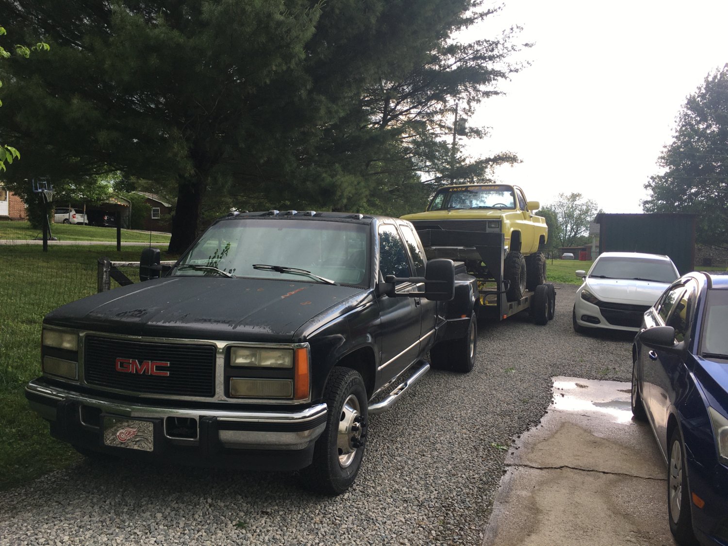

Been working on this again. Got tired of trying to work on it on weekends I can make it down to my other house. So I got me a 93 6.5L Dually with a gooseneck so I can haul this around. I think this set up looks really good. :pimp:
I was happy that the truck fit really well on the gooseneck and it towed real easy on the 150 mile ride home.

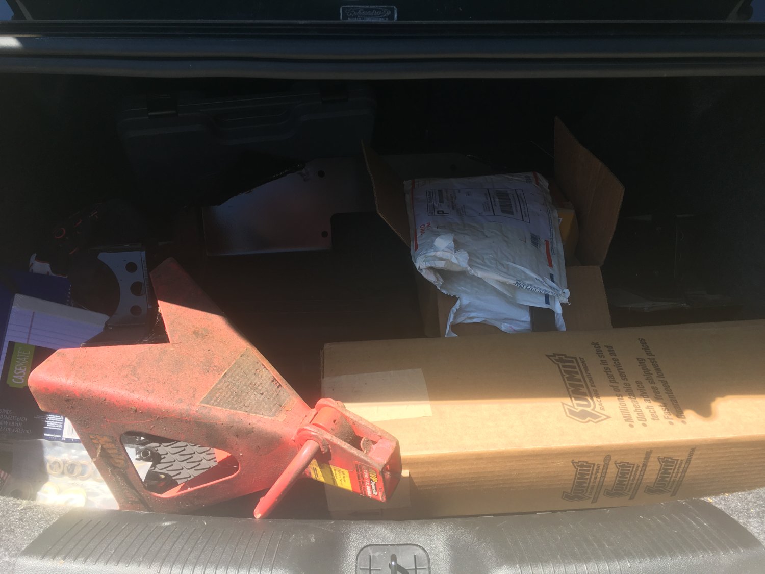

Had to go back and grab a trunk full of parts and tools for the front revamp. Bumper and the homemade hydro assist

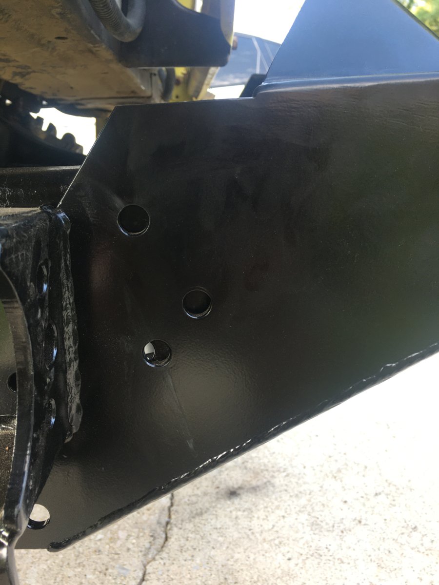

Next was time to move forward with the a bomb bumper. With much cussing and hand smashing I got the frame cleaned and painted ready to receive the new bumper.
After much frustration finally got to this point only to find the holes don’t line up.
it seems as thou I have a blazer bumper not a truck one. Gonna have to give Kurt a call and see what we can do about this.
Actually you got the wrong years.
There's two patterns on the front frame horns:
73-80 and 81-91
Yea did some research today and found out must have gotten an earlier one. Figured it out when I saw the bushing hole. So after some searching and figuring gonna drill the new holes needed in the frame and get a set of early model core support bushings and run it. Bought the bumper over a year ago so just gonna live with it.
If that doesn’t work I’ll just run big fat welds lol.
After some more research and looking it appears that there is too much difference for my liking to make the abomb bumper work. So bolted the old mount back on and went forward with more projects. I have another bumper on order but big back order time. Will be selling my current abomb but this will be after the other one shows up.
