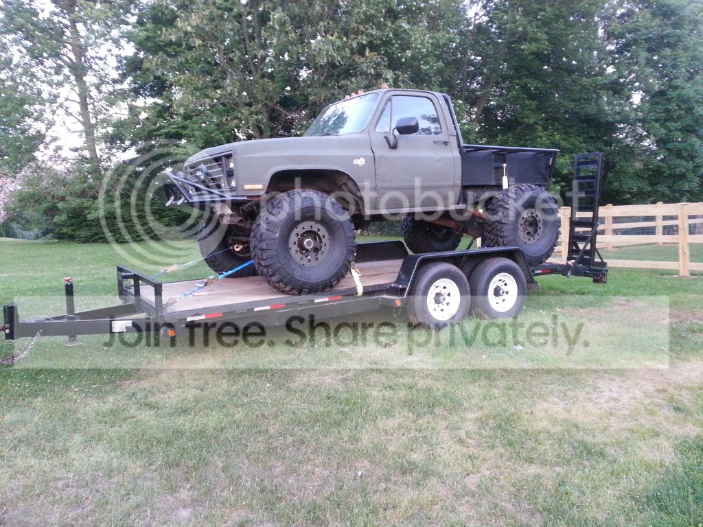

A little pic whoring :D. Loaded up and going to my shop for some more tube, trimming and other odds and ends.
Oh it is a bit wider now, it rubs the inside of the trailer tires now, used to clear by an inch or so

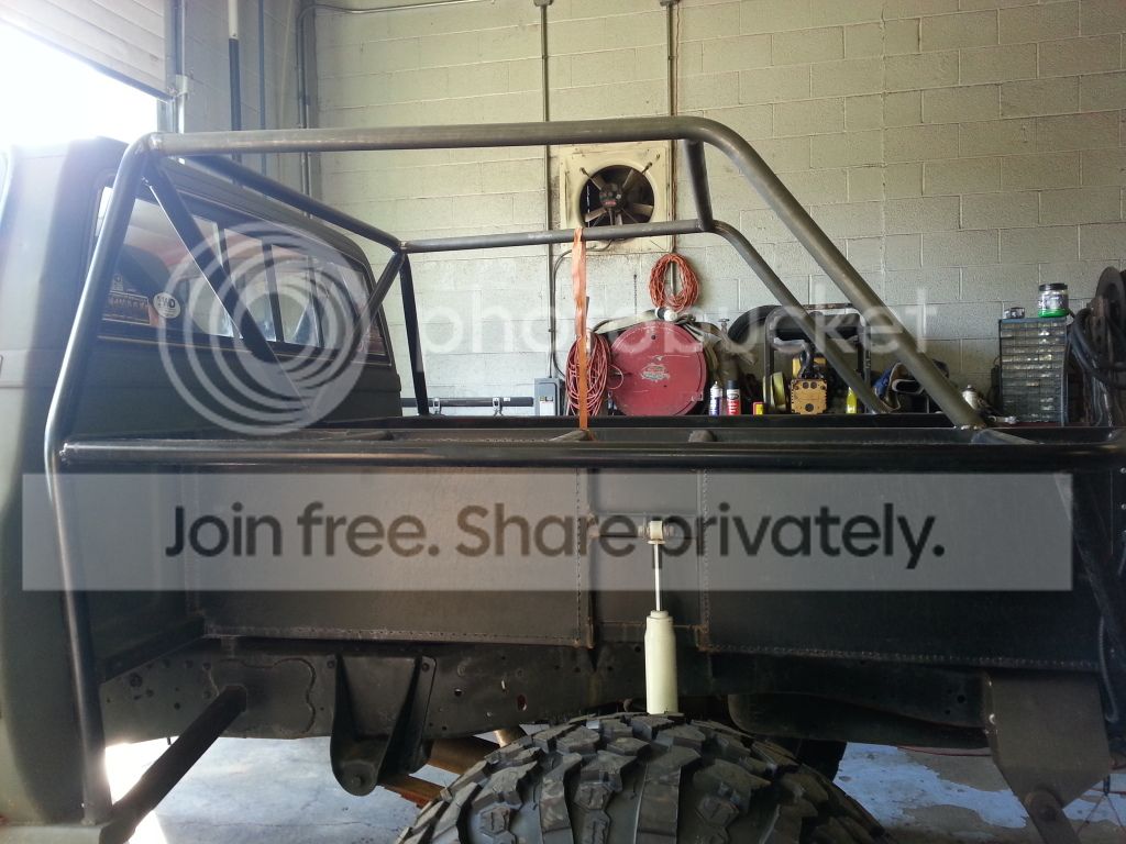

Started on phase 2 of the bed :D, lots more to do but now im motivated :waytogo:
Need to pick up more tube as I only had one stick (17'6") and I used all but 18" on that.

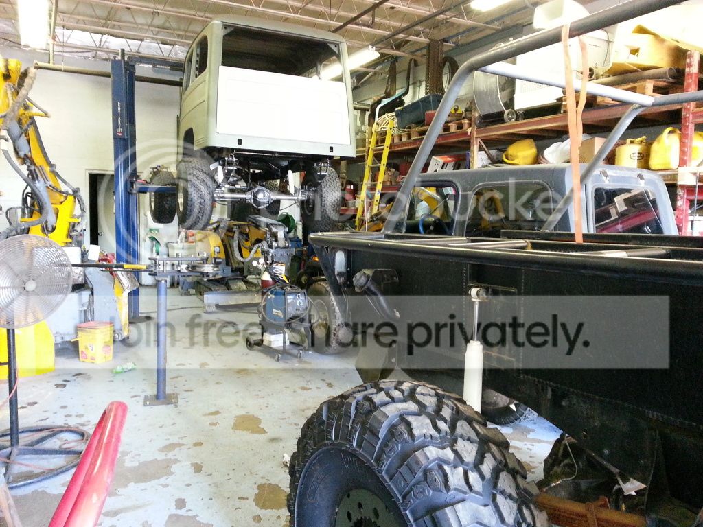

The shop is a bit crowded right now too, I have 3 machines there, dads Willys on the lift and my buddy Ben's CJ there also. We pulled it out of the weeds and will have it ready for the Raush Creek trip on the 22nd, it hadn't run since 02, bit it does now

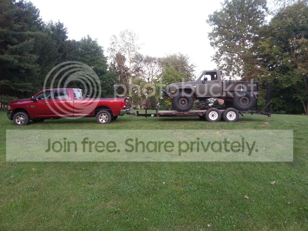

I guess since I already messed up a trailer fender, I need to make removable or hinged ones. I also need to modify my overload springs. The silver dodge has about 4" lift. The over loads, top or bottom pair were not touching in this pic. I beleive one set needs to be touching. Its ass is draggin to much for my liking!
Rick
It would be sweet to have a cummins powered sarge tho....
Your not helping..........already
Rick
On the fenders, I made mine removable, it's already annoying :doah:, I've got an idea on a hinged set up, just got to figure out a quick yet strong lockdown setup. If mine weren't as high as they are I would really consider a mod to make them drive-overs, I've seen a few that other people have done and it doesn't look too bad to do, I've only had the rig on the trailer 1/2 dozen times or so and I'm already tired of the fenders :doah: :dunno:
I just cut the 3" out of the inner side of the fender, straighten the messed up sections, and going to hinge it. It may need some stiffening on the remaining fender. I'm only going to do one side for now until I screw up the other side.
Rick
Gotcha, I made the whole thing removable, and it's a PITA sometimes. With the new tire/ wheel combo I'm rubbing the insides of both tires, but hinging "half the fender" wouldn't be that bad.
