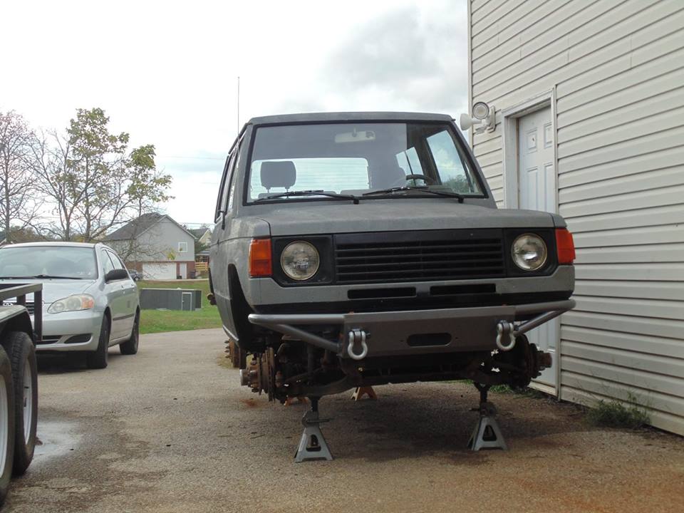

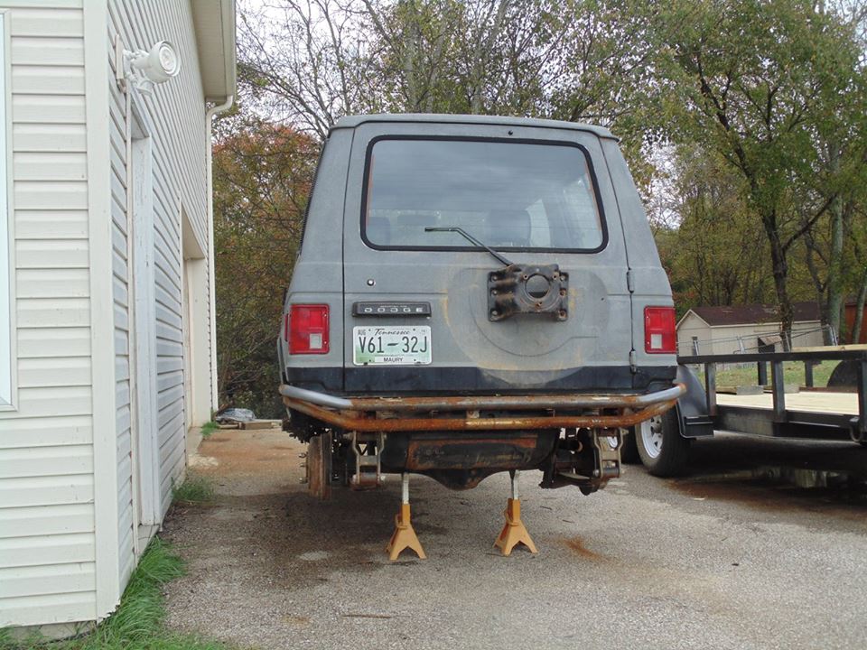

Update: Sold the roof basket and winch, combined I broke even on those. I am going to make my own basket later on when I am done with motor swap and I will just buy a new winch instead of storing the other one. Selling wheels and tires tomorrow. Still undecided about whether to keep the old axles or go to something else. Part of me would like a blank canvas to start with and part of me wants to keep it on stock axles. The stockers are geared 4.625, are probably comparable to yota axles in strength, and I had recently bought a bunch of brake stuff for them like drums, pads, hoses, etc before the motor blew. Don't know if I would be able to find a buyer for them at a decent price or if I would wind up having to give them away. So, for now this is how the Raider sits.

From what I've seen there aren't a ton of them around in good condition at this point and they aren't very good engines to start with. Not much power for the displacement, carb'd, and prone to overheating issues. In my mind, if I am pulling the motor then I am going to make it worth my while. Why not get 3x the HP, fuel injection, better parts availability, etc?
