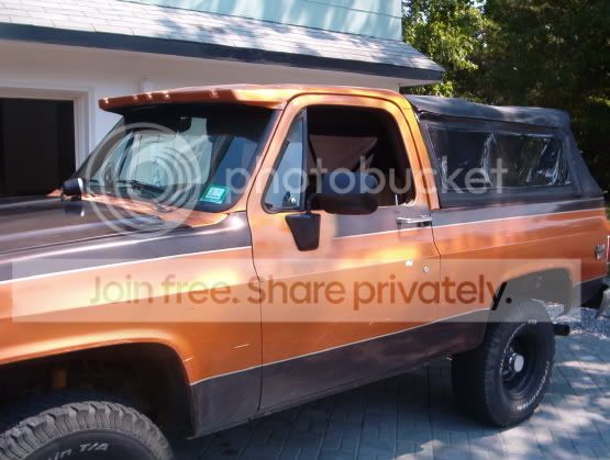

The only issue I've had is, that I can't seem to get the back corners to stay under the rail on the tailgate section, they keep popping off.. Seems like the hard plastic lip is too short there.. That and the rear window being a tad long and not clipping in...
Neither seem to be a big deal to fix... I'll have my canvas guy shorten up the window, and I guess redo the corner stitching to expose more of the hard plastic..
I'm not sure how the soft top really works there, but I wonder if it would be a good idea to extend the rear window bottom edge & sew in a tailgate-width strip magnet into a pocket so that it will seal up the rear window to the top of the tailgate without any fasteners or whatever.
Maybe impractical because I haven't ever seen one in person, just a thought.

interesting, thanks... actually, I'd have no clue where to look for a magnet strip that long.. :doah:
the stc has the channel that some hard plastic at the bottom seam fits into... it is a good setup... tho you do have the aluminum strip screwed to the tailgate, whereas the sides have it built into the bedrail...
i think it'll work well, if just shortened up an inch.. it really looks like the seamstress that day apparently partook in crack for coffeebreak, as the piece is obviously cut too long. you can see it compared to the corners....
really need to take it over to my canvas guy...

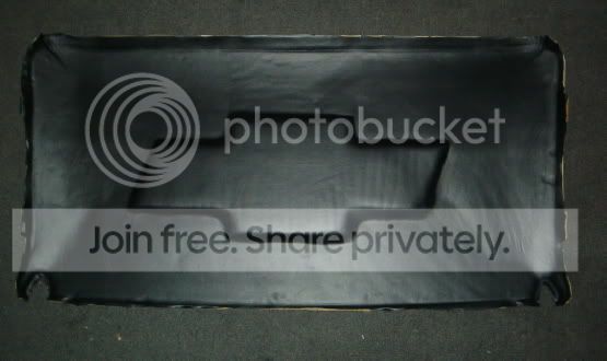

Here was last nights project.... Idea stolen from Minimull, thanks Christie! :D

Hahah, I did the same thing with my headliner last year went it finally dropped, except I cut the middle of the bowtie out too. Lookin good Paul!

The local Rag Shop was going out of biz, so I picked up some material...
it's coming together... get my floors and seats in, and the interior will be pretty close.. still need to do my ALDL port and ON/OFF switch for the timing in the ashtray, get the plexi over the circuit breaker panel, door panels, cb, yada, yada... :haha:
