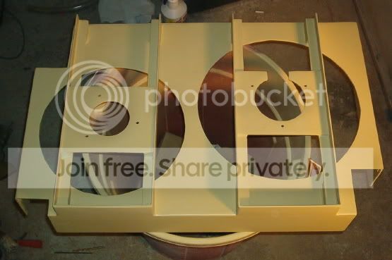

So, to update the status, the shroud is ready for primer, I'll get some shots up later...

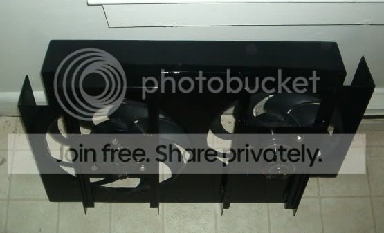

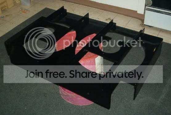

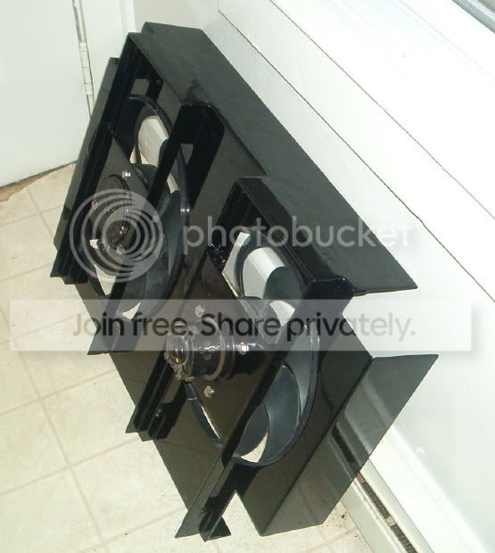

I'm such an a$$hat..... Forgot to put flattening agent in my Imron.... :doah: :mad:
So I'm gonna wetsand it out today and overcoat it with a satin version... :o
I'm very pleased with how it turned out structurally... Should cool like a mofo.. :saweet:
Now I just need to figure out how I wanna relay it... :wink1:

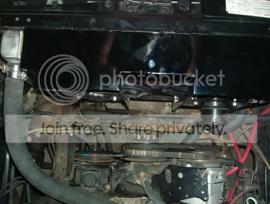

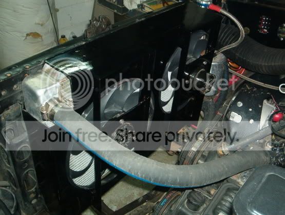

Some trial-fit shots..... Man, I need to dull that thing out! :haha: :eek1: :haha:
Anyway, fits good... frees up alot of space in there....
Hahah, yeah it definitely does. Maybe this could be the custom ryoken piece you could send me......:D Hahahh, looks good Paul.

Did you use composite to make this? That seems to be your material of choice.:D
Anywho, make sure you`re fully awake before you paint again.:deal: :D

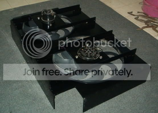

Yup, same construction as the other stuff... tho I'm really looking forward to some straight-forward mechanical stuff in the ways of running gear... But it's looking like the pile of steel on my floor, and empty wallet are dictating that i do my floor/slider project next... It'll be nice to do some welding again, as opposed to grinding glass.. had fun on the battery box, so fabbing up a floor and sliders should be fun........ and dirty! :woot: :weld: :grind: :saweet:
I can't believe how stable and strong the shroud is... I'd guess it weighs about 5 lbs.. amazing stuff, the ultimate in fiberglass... :bow: I just find myself going to it on many projects... Can't wait to do rear bedside panels and speaker stuff out of it.... I can't advocate the product enough... Apparently, cuz it's been at the cornerstone of many of my projects.. :rolleyes:

What`s the cost of that material? Figuring maybe I should just get some for the rear wall,and maybe for bedside panels, as well...
thanks again for the hookup Ben..
pm sent..... but for those reading this curious about the cost of the composite...
it gets pricey... i have a good hookup tho, my local distributor gives me killer deals on partials, scraps, etc..
it comes in just about every structural shape you can imagine.. angle, tube, square, etc... and the flat sheets come in 4' x 8' sheets.. running from 1/8" thru 1' and up...
a sheet of 3/16", which is what I have been using on most of these projects, runs in $150 to $200 range...
so that shroud is probably about $50 to $75 in materials with all the angle braces and epoxy...
