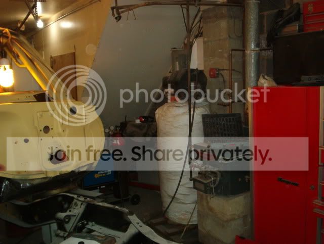

i have a decent spot under the stairs, next to the compressor spot for the second tank... i'm gonna build a small room for it when I get it...
I'll do a studded wall straight off the angled stairwall, with a door in it, then over to the block wall...

You probably already know this bit don't forget that if you box in what looks like your forced air system / water heater (they look like gas fired) that you need to provide a combustion fresh air return for safety. Not sure if your wall will be going that far or not.

thanks Rufus.... yeah, I actually had the same enclosure up prior, it goes between the compressor and furnace..... took that one down, the fire marshall wasn't happy with it being made of studded plywood... :doah:
this time I'll do a nice one, regular studded sheetrock construction with insulation to help keep the noise down.....

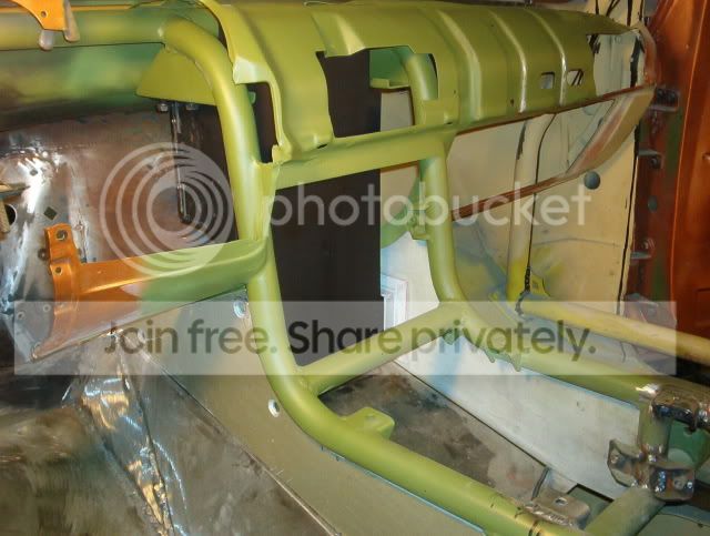

Hey Paul, was looking at the air box outlets made of the composite panels, and was wondering how your going to keep them from vibrating against metal? Perhaps use a pinchweld gasket along the edges?

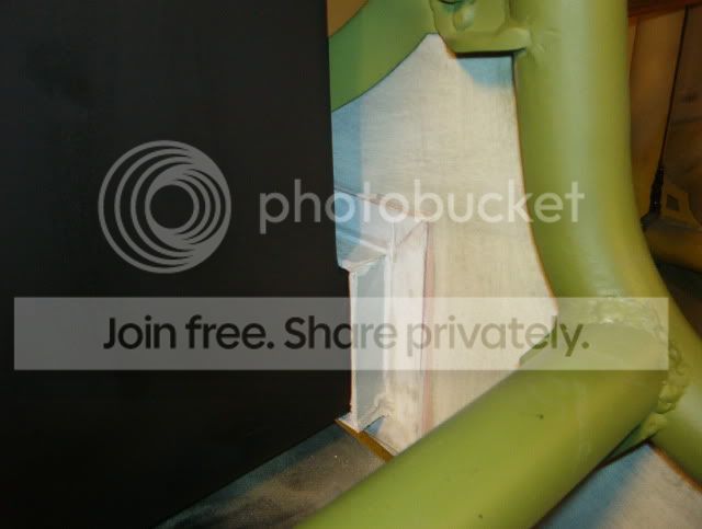

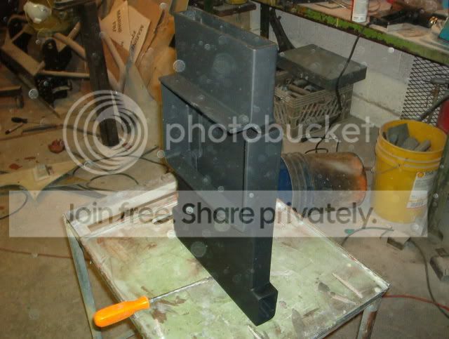

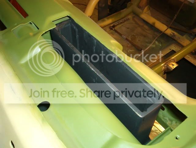

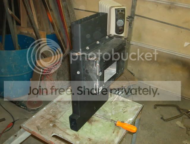

well since you asked....... :wink1: was gonna wait till sunday for these, but questions bring sneak peaks.... :haha:

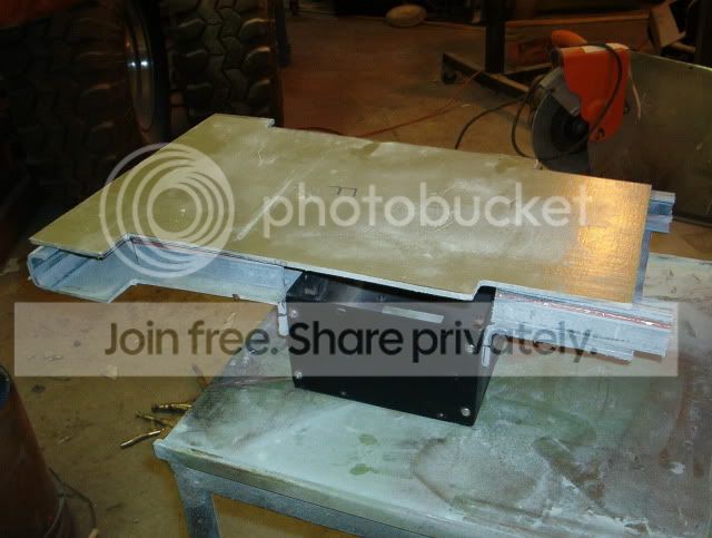

here's a couple shots from earlier in the week, when beginning fitting up the diverter.... you can see the upper and lower backwalls, flanged, and fastened to the box with selftapping 3/8 screws...
they are seriously secure... I doubt it'll vibrate on the box, but a gasket-tape might a good idea during assembly, thanks! :bow:

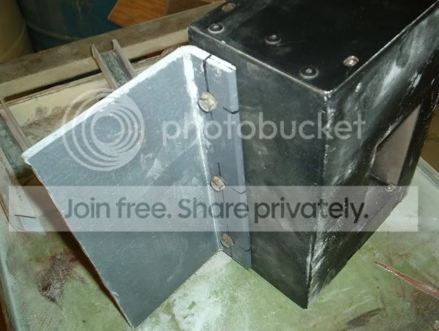

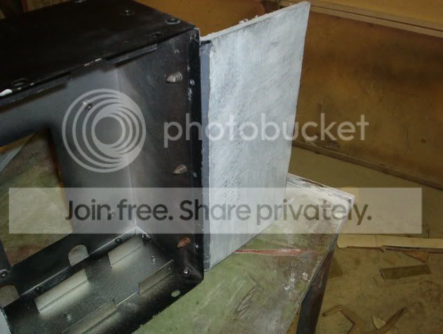

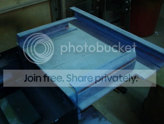

here are some of the sidewall pieces I'm using, 1 1/2" channel that I lammed up...
rough-cut pre-glueup.....
I'm gonna have an angle lammed box/receptacle on the inside of the console side for the duct "feet" to fit into... kinda like how my shifter is mounted... think for a "grill" I'm just gonna do a series of holes drilled thru the composite, probably 3/8.....

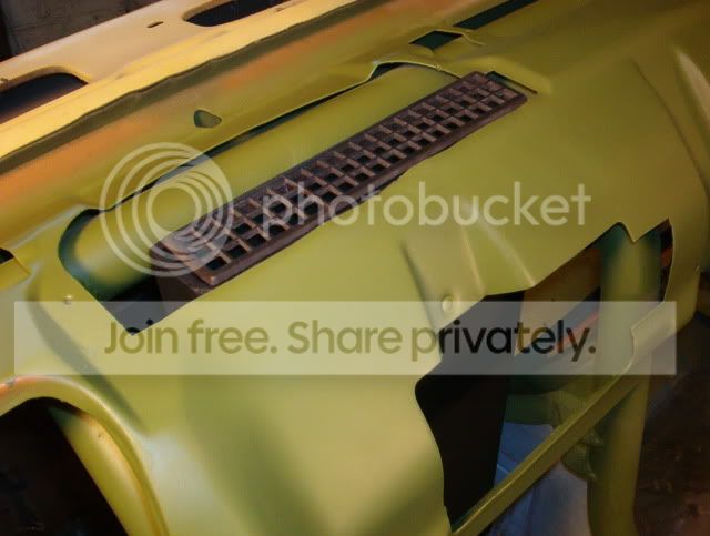

should have the side vents finished up over the next couple days.....

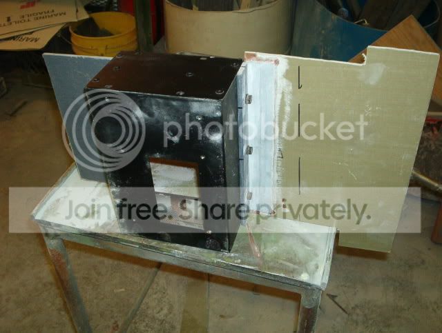

Very cool Paul....looks great. Are those ducts going to be anchored to the upper dash metal, or are they stout enough bolted to the plenum?
no need to fasten it up top... actually it really doesn't even need the boxes for the bottom feet... i could have just butted them up to the side panels... but i wanted the receptacles to insure no air leaks and kinda tie it all together..
the diverter is mounted to the summit box by 8 screws now, I added 1 to each side.... let's put it this way, it's RIDICULOUSLY overbuilt... i seem to have a habit of doing that... :doah::wink1:
one of the biggest plus's was, I can actually install it as is, with the box attached.. I was pretty certain I was gonna have to put the diverter in place, then attach the box. but I lucked out, it all slides in under the console bar, barely.... :saweet:
maybe tomorrow I can get the vent holes drilled.. gonna put a slight chamfer to em too...
and thanks.... :D I worked my arse off on that thing the last 2 days.. I'm actually very proud of it, how the design all worked out.... it was a big jigsaw puzzle, lots of pieces, and glueing processes....should do the job nicely, especially when I do flapper doors down the road... I love it when a plan comes together! :haha:

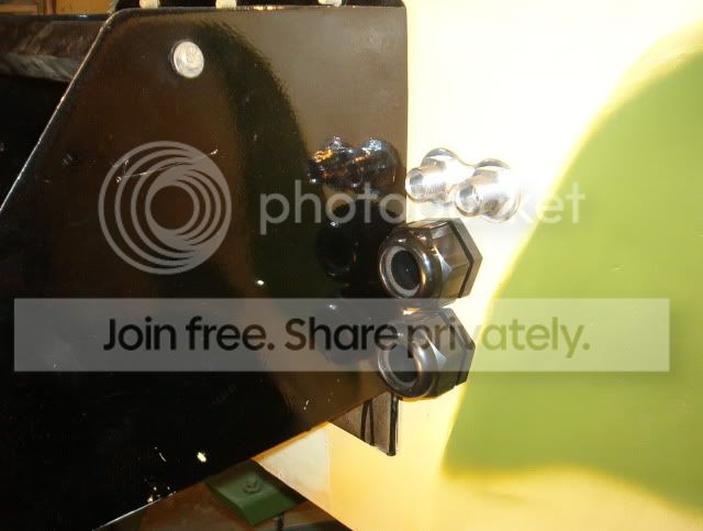

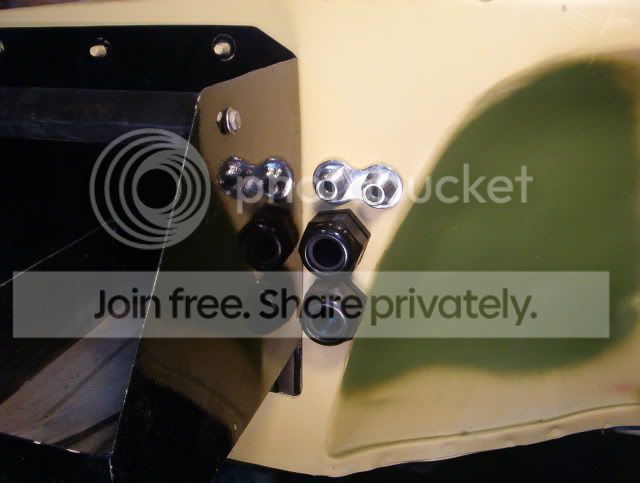

new goodness......

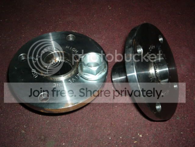

205 flanges courtesy of jesse....

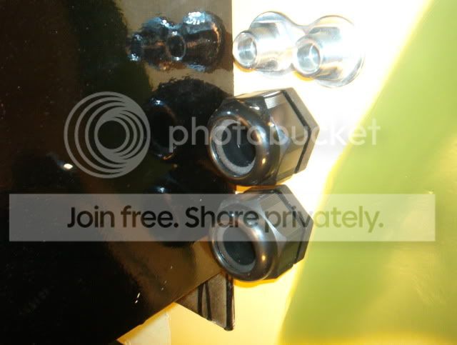

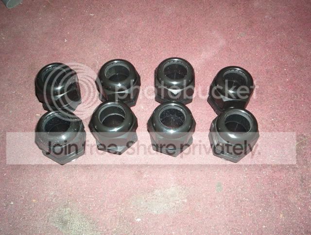

watertight cord grips.....
wire and heater bulkheads mocked in... the firewall will be going back to copper...
