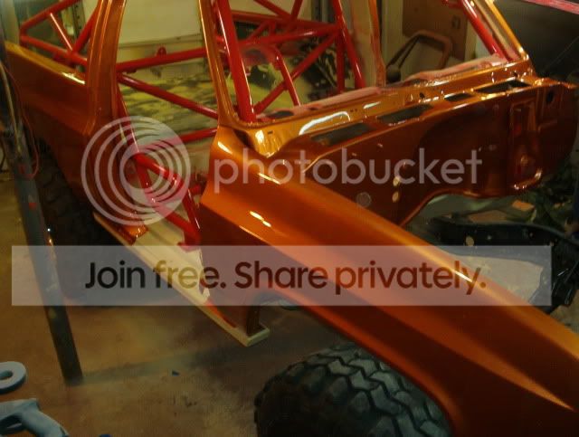

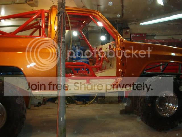

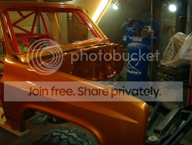

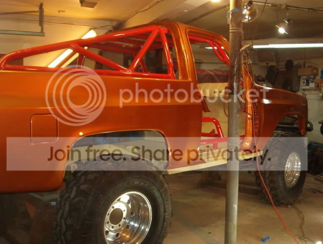

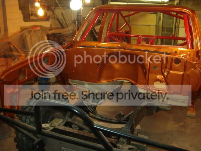

clears done, came out pretty sweet.... man the house freakin reeks... :eek1: i'll get some shots when it airs out down there....
I'm soooo revved to get the black done this weekend.... thats really gonna make the biggest difference... :woot:

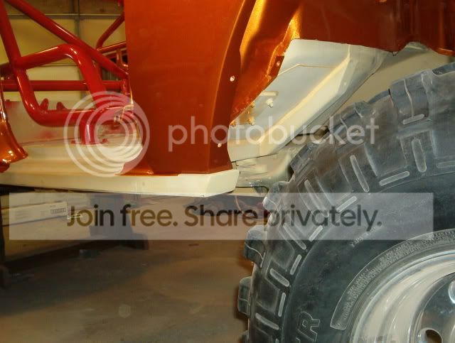

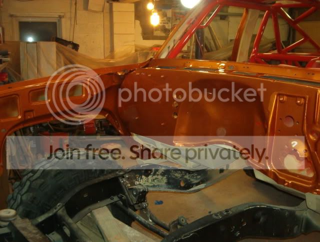

and the front and rear sectioning.. came out pretty factory looking, with extra beef...
rear... seamsealed at slider...
should be squirtin black sat or sun..... :woot: I thought the house stunk today, thats gonna be real stanky! :doah: :haha:

for as decent as it looks now, once the black is on, I really think it's gonna make the copper look way better... break things up a bit....
hopefully masking the cage and copper off wont be too much of a pain.. i'll be going thu a few rolls of 2"...... :haha:
