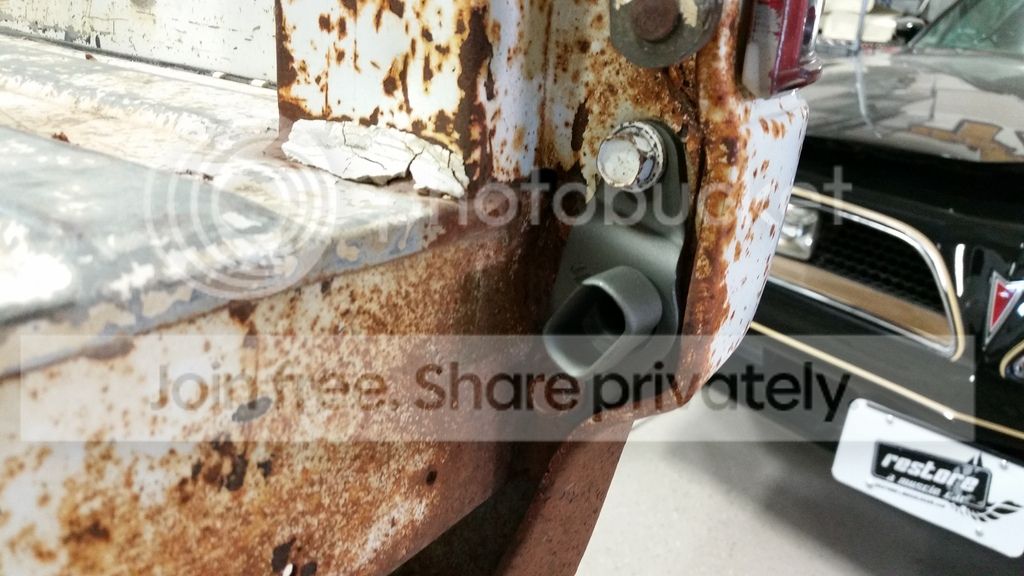

Weld the trunion piece that's on the bed? Is it not supposed to move at all? If so than I can try that.
Turns out there are 2 tack welds on the back of these from the factory and mine were broke off. I welded all the way around it and now I have a quiet tailgate.
Mine had tack welds. I broke them off when I removed the hinges. I later reinstalled them without tack welds, but I haven't had a problem with them yet. :dunno:
