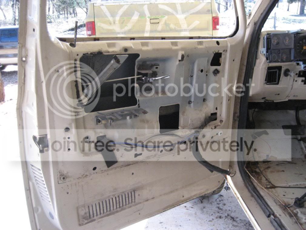

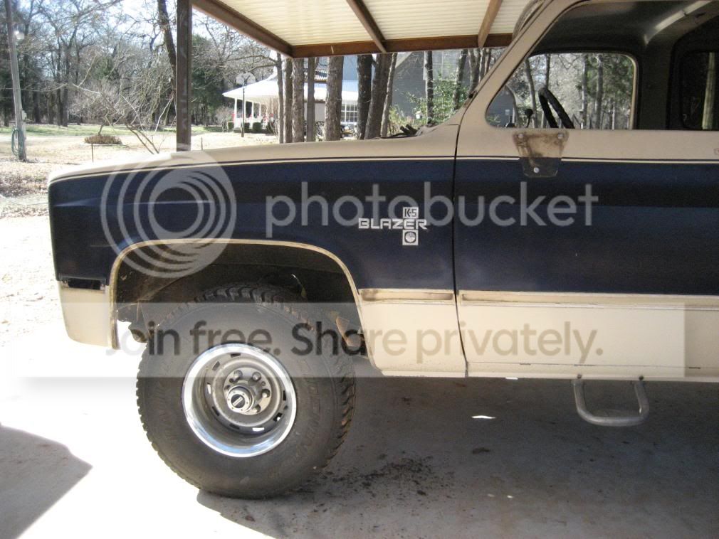

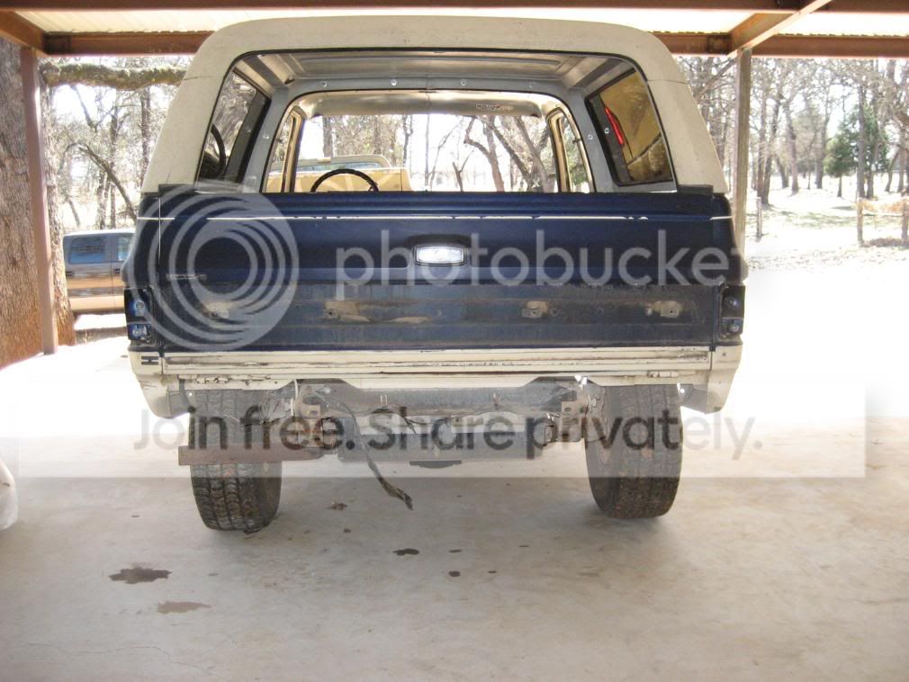

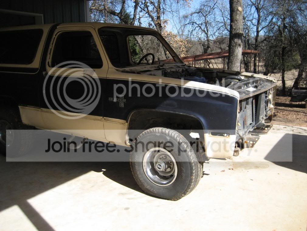

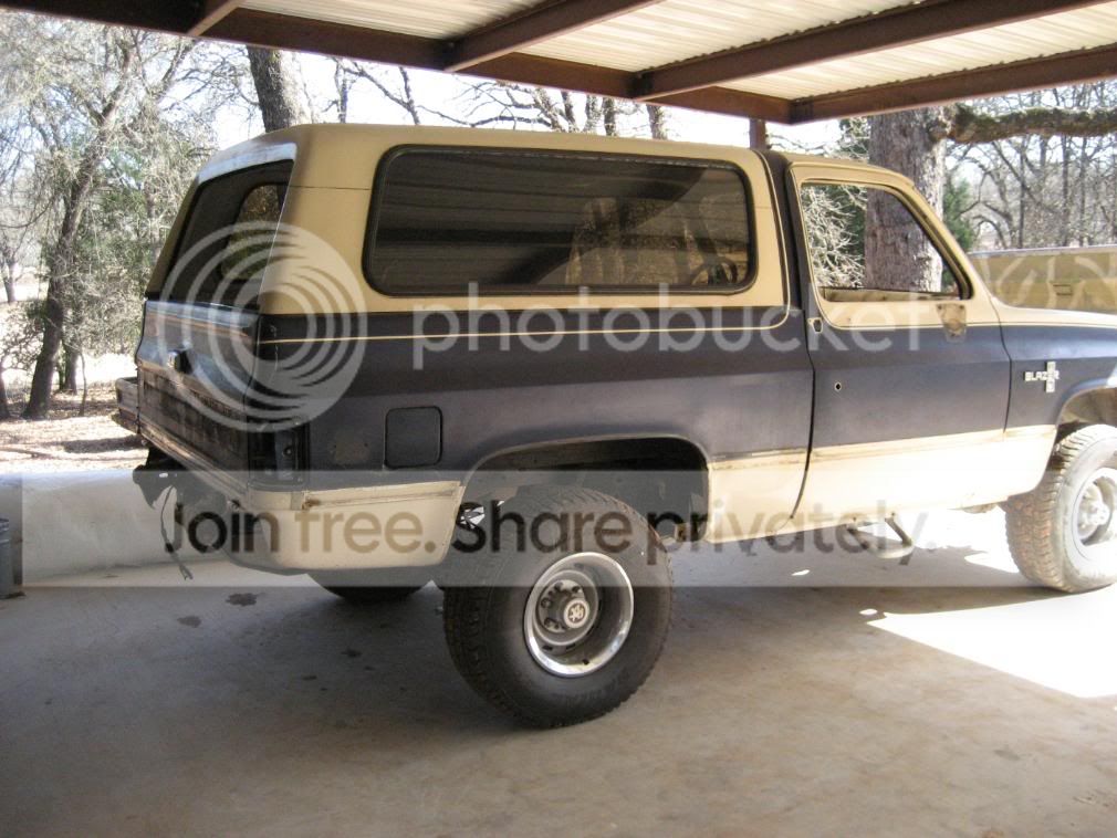

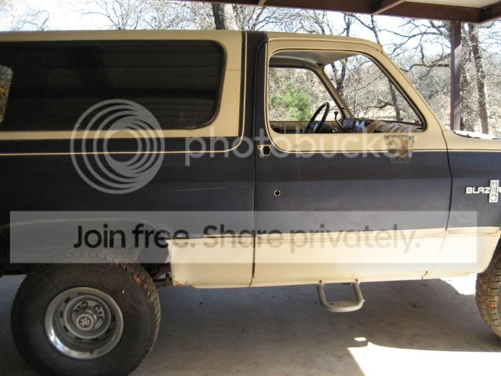

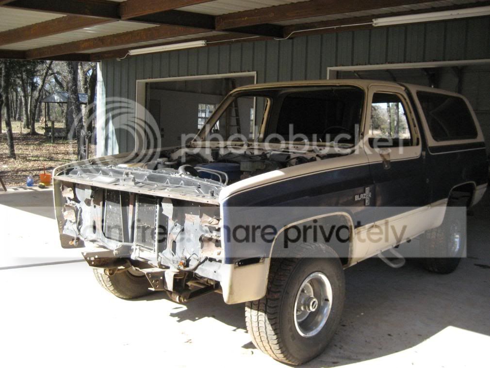

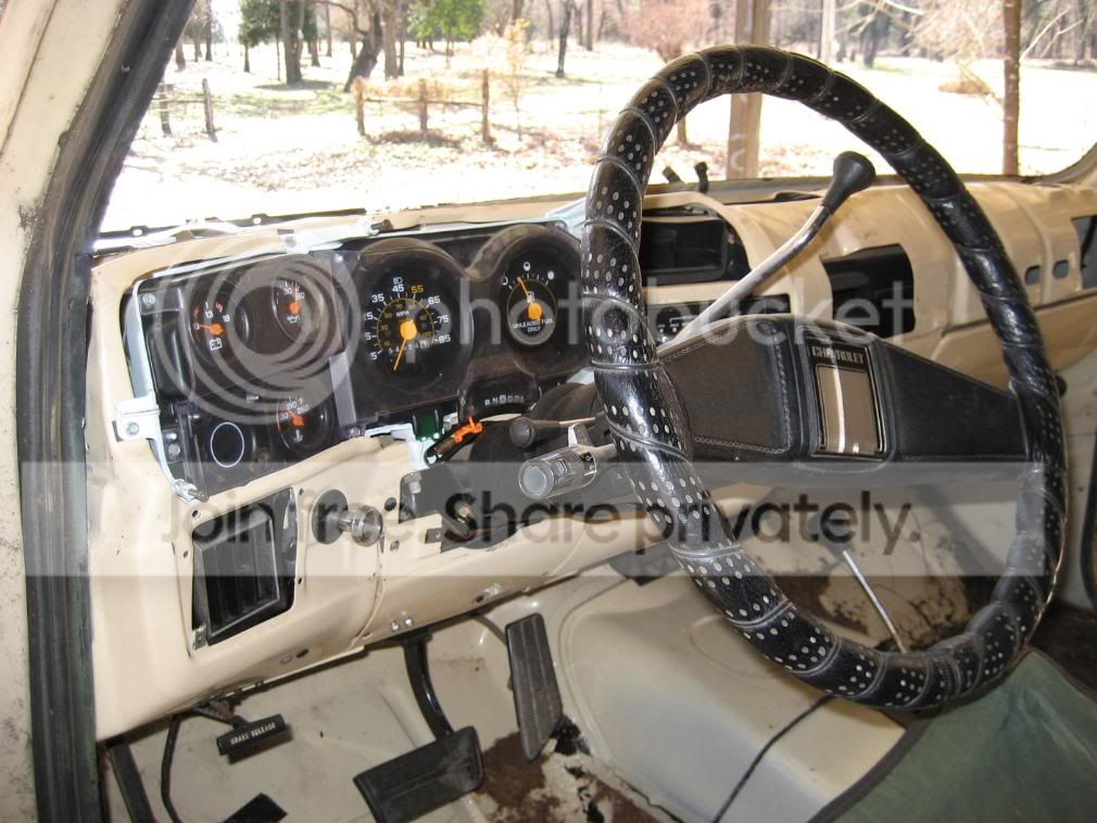

Well did some work since i've been out of school, mainly rippin all the stuff out of the inside. I have since discovered that my blazer is rust free! The only problems are with the floor, where the seats cracked the floor at one of the mounting points, nothing that a small weld cant fix. Otherwise its extremely solid, no rust, motor runs good, all in all an excellent excellent start, not bad for $2500. Any who here are some pics of stuff....
Looks like this is an awesome start to the build, I wish mine had been in as good a condition when I started. Oh well, it made it lots easier to start rippin fenders off. :D If you ever want to check out some of the stuff I did to my chevy just holler at me and come on over. I am in the process of tubing the front end right now.
I don't know how you are planning on doing your lift, but Offroad Design has an awesome rear shackle flip and is what I went with on the beast. The front of mine was spring under from the factory, so when the dana 60 went in (they come spring over) that gave me the lift up front.
I'm prolly gonna do just a rough country 4" lift, cause money is kinda tight and im tryin to get it in pretty nice condition and fix a few things on it. Its gonna be just a nice decent wheeler, nothing too hardcore cause it costs money. I've never seen one with spring under, thats unusual.

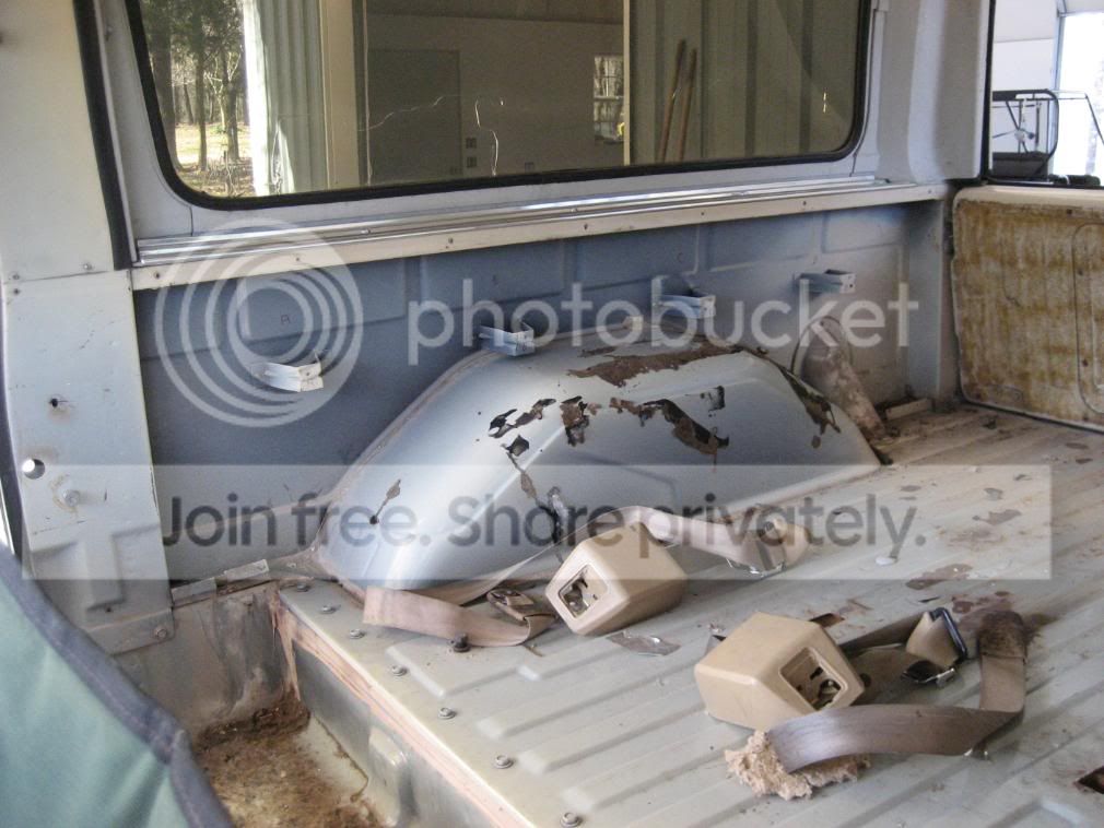

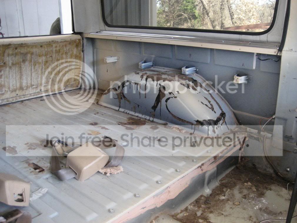

so did you do anything over this break? dont you just love those rust free trucks like we got? anyways did you have any special tricks to getting that glue off the wheel wells and the floor?
man i have not done anything, other than just general teardown. Only things left to do before i can start doin paint prepwork is to remove the hardtop and the rear bumper, otherwise shes ready to be prepped for paint. I have no clue how to get that glue and **** off....I'm gonna hit it with some gasoline maybe see if it'll eat it off, if not it'll have an appointment with the wire wheel
i have used a chisel and a hammer but mine are prtty dented up. theres got to be a better way. theres still a whole **** load of it left i just painted over it.
hahaha I'm sure I'll end up doing somethin like that cause I'm just bedlinin the inside....the **** wont really show up i dont think

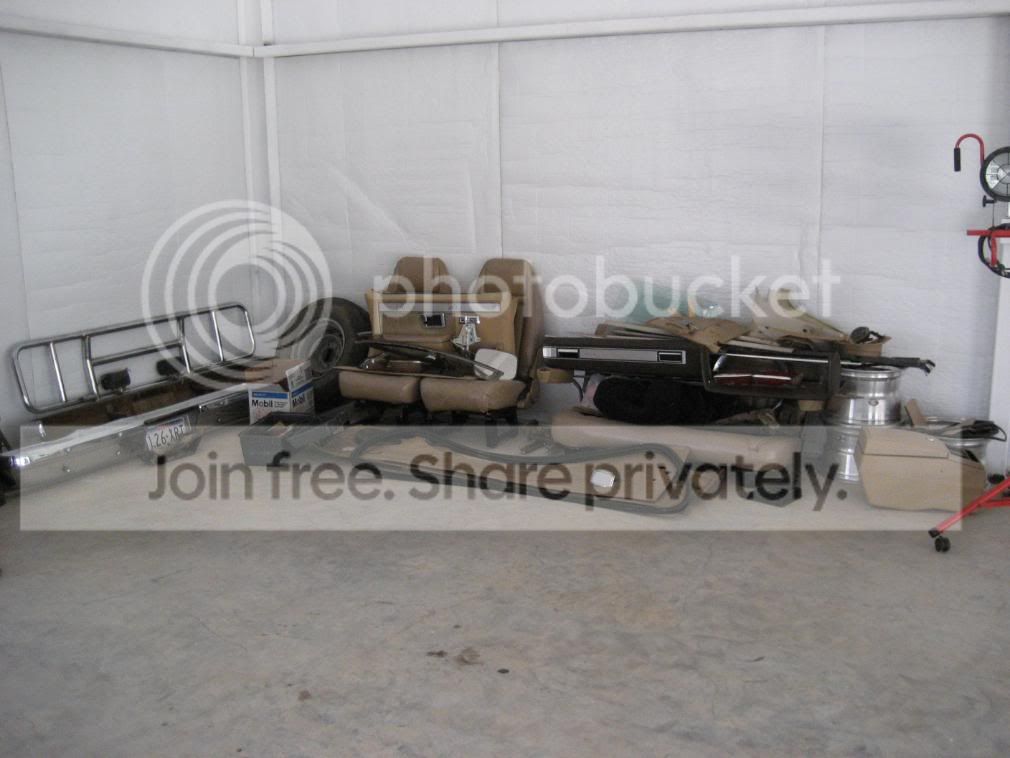

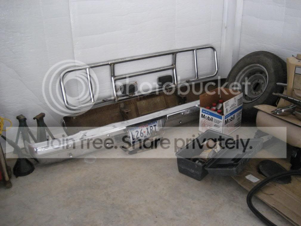

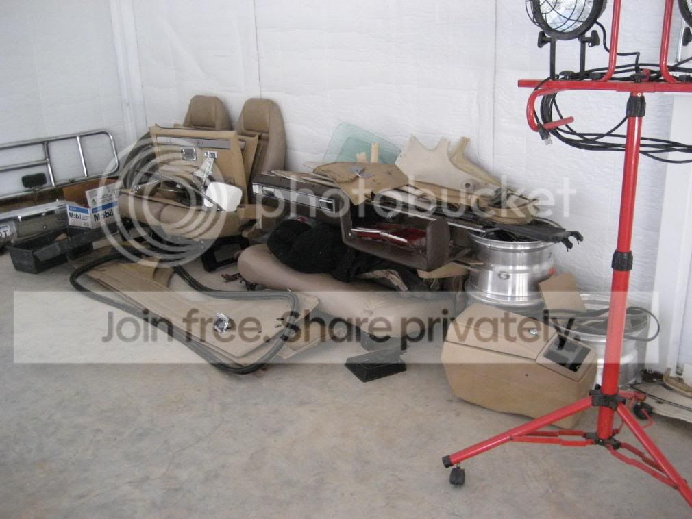

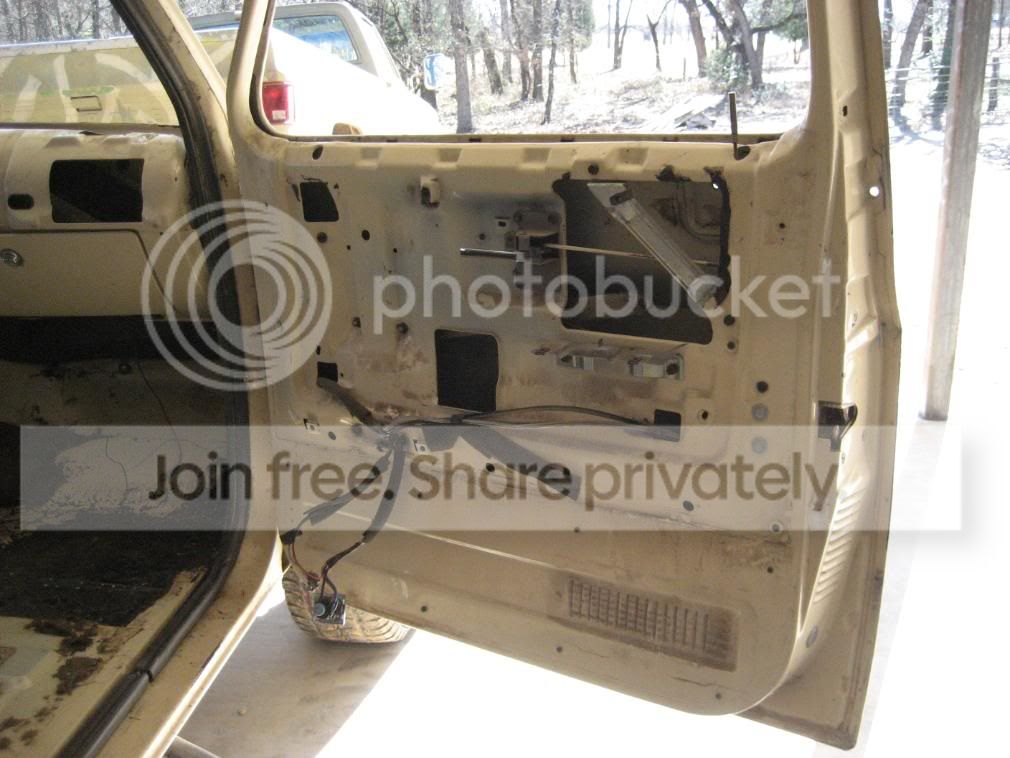

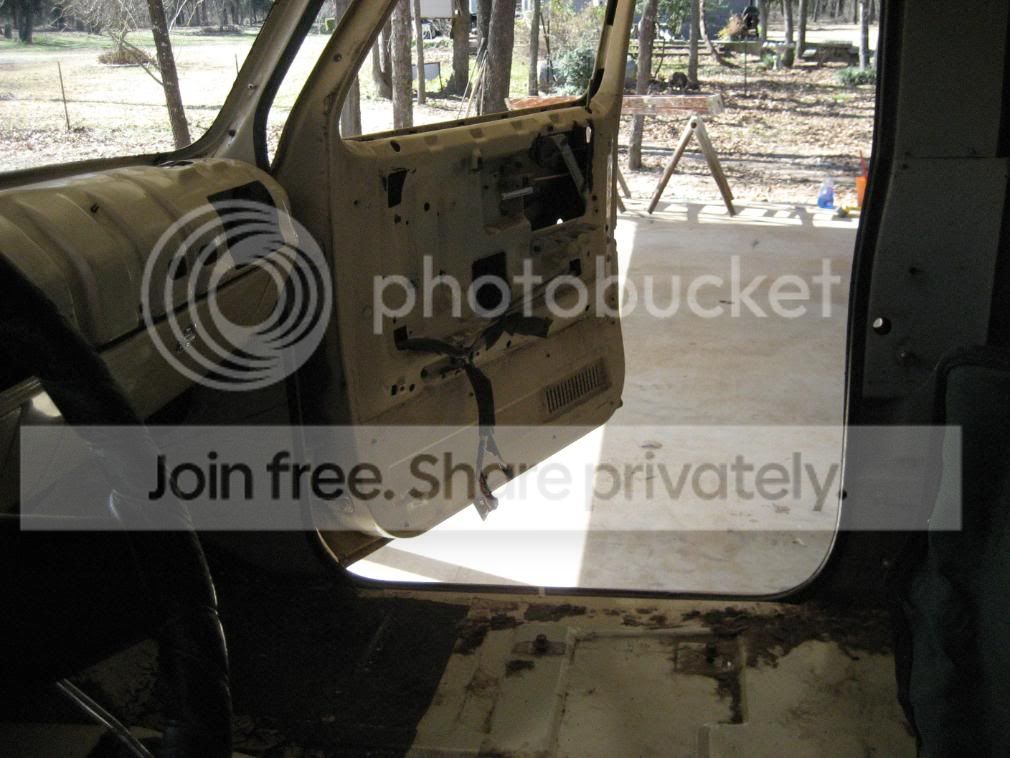

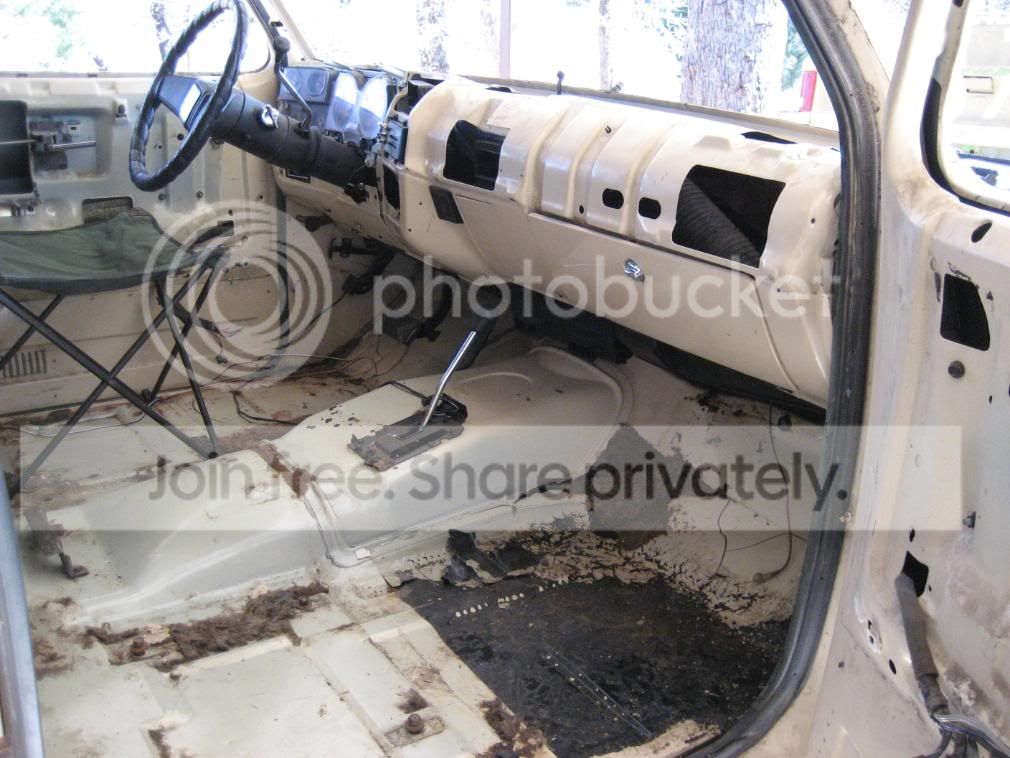

Pics of the Deconstruction!! whoop!!
hmm interesting paint, never seen that one before. and holy crap thats alot of crap that come out of the inside. if you find a good way to get all the crap off the floor and wheelwells let us know!
That **** all over the fenderwells and the rear area is gonna drive me crazy. I'm gonna try some paint/adhesive remover stuff i found at a hardware store. I'll let ya'll know how it goes. And yea....you don't realize how much stuff is in there until you take the interior apart.

Well this has been a productive week/month. I'll update with pics this weekend, but I've got it as stripped down as its gonna go, and i have the inside cleaned up. The easiest way i found to get all that tar/adhesive stuff off of the fenderwells was to use a grinder with a cup wire wheel and just go to town. It ends up just chewing thru all of that crap. I have the floor/interior cleaned up so its ready for bedlining. I also got all the cracks welded up in the floorpans and all the body holes are welded up. Its coming along pretty nicely.

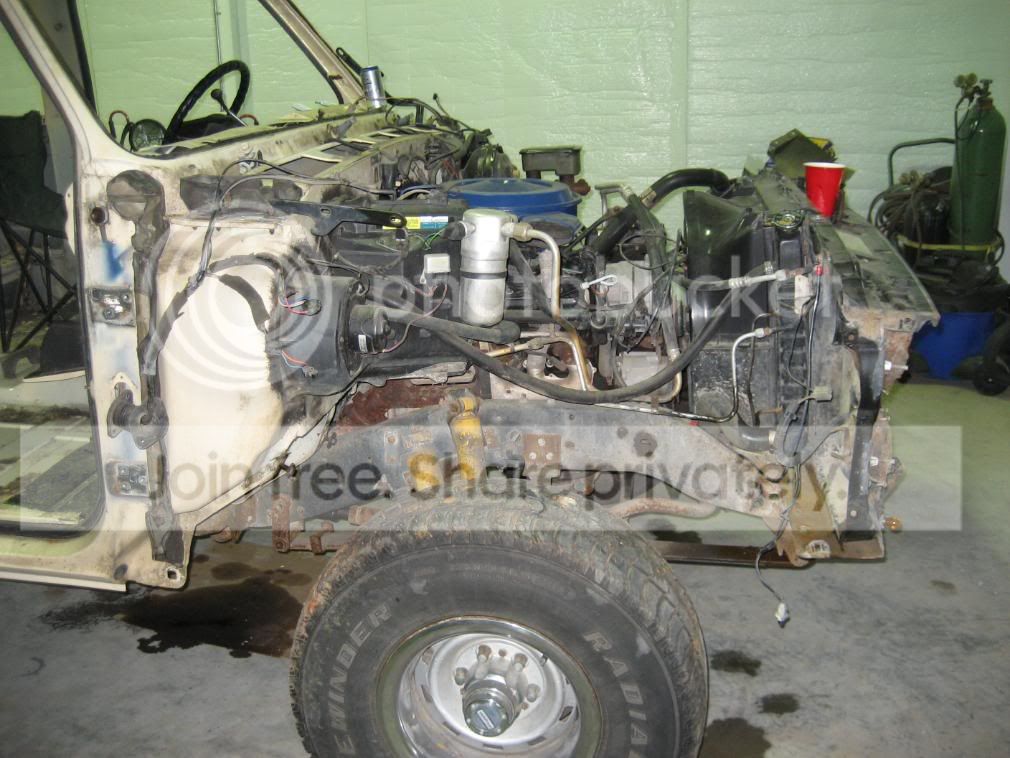

1987 Blazer, TBI 350, 4x4, gov-bomb, etc... I've had this since I was 17 and it has gone from a dd, to sittin in the pasture collecting leaves and bugs, to a father son project. It started out in not to bad a shape, but needed some body work from a a collision with a fence :lol: and something the previous owner had done. I havent had much time to do anything on it because of either working all summer and school, or school and work and being in College Station all fall. Anyways, enough talkin...picture time

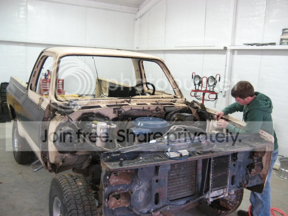

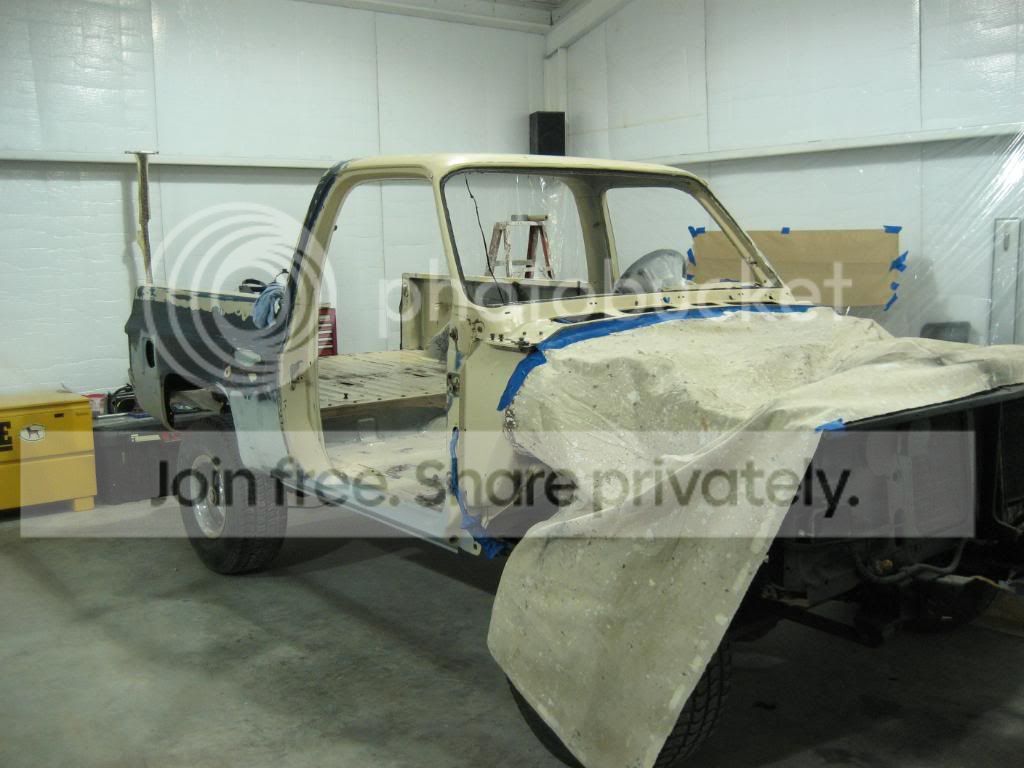

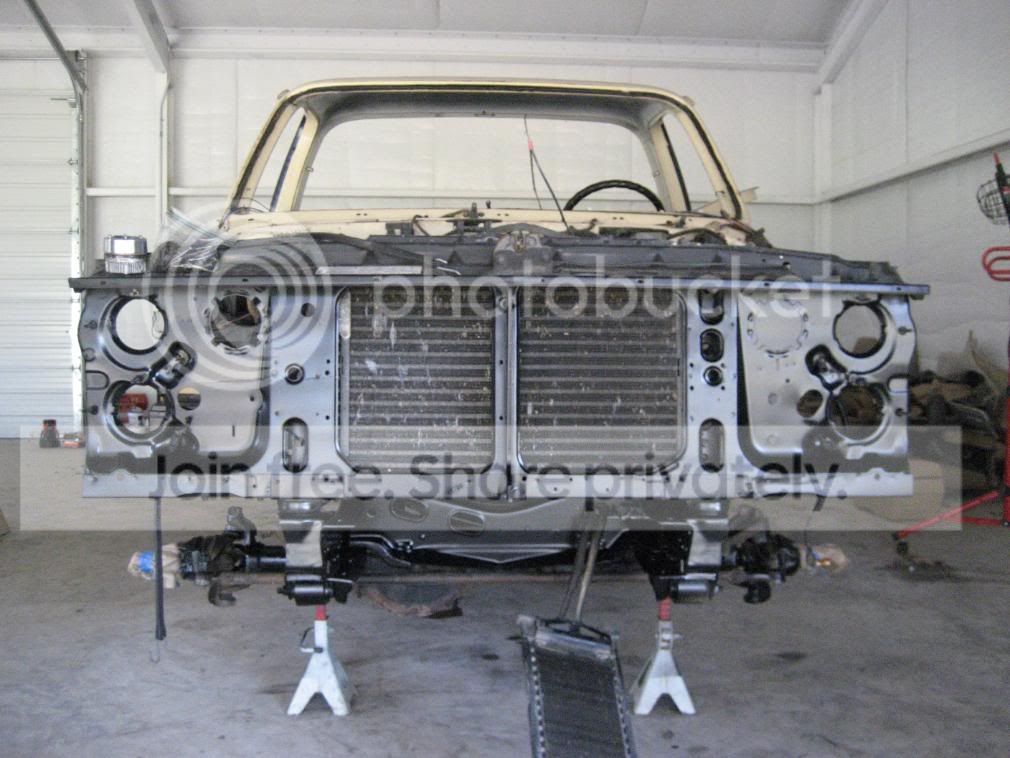

Removing the front clip

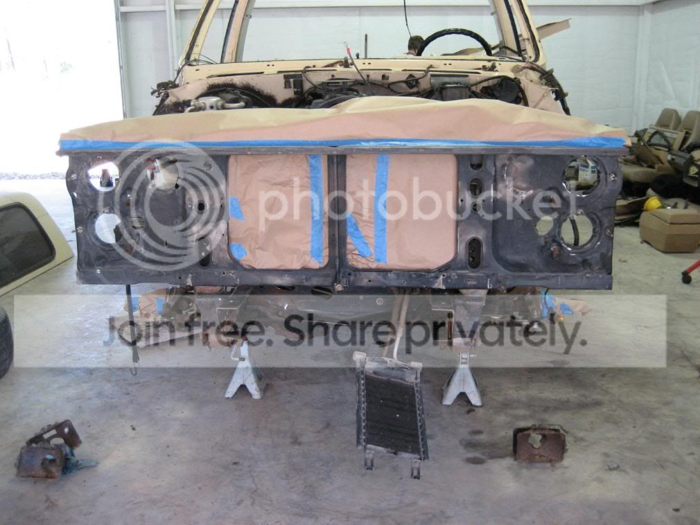

Core support painted

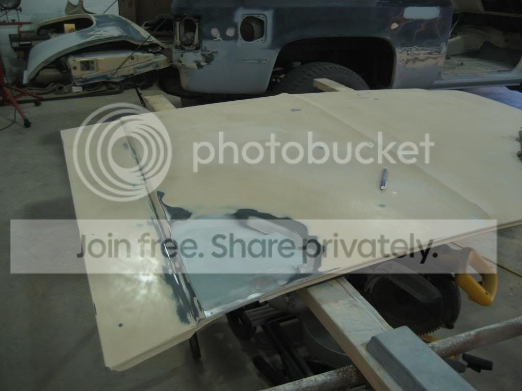

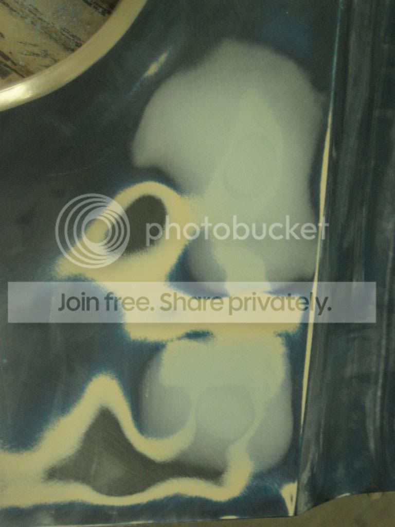

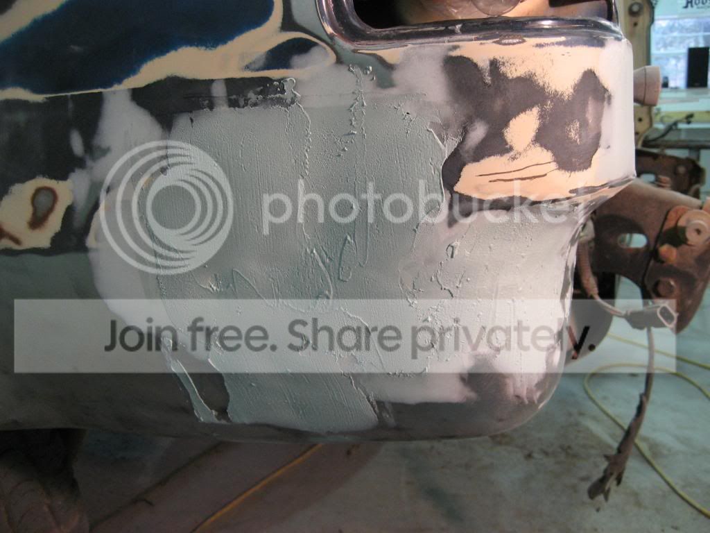

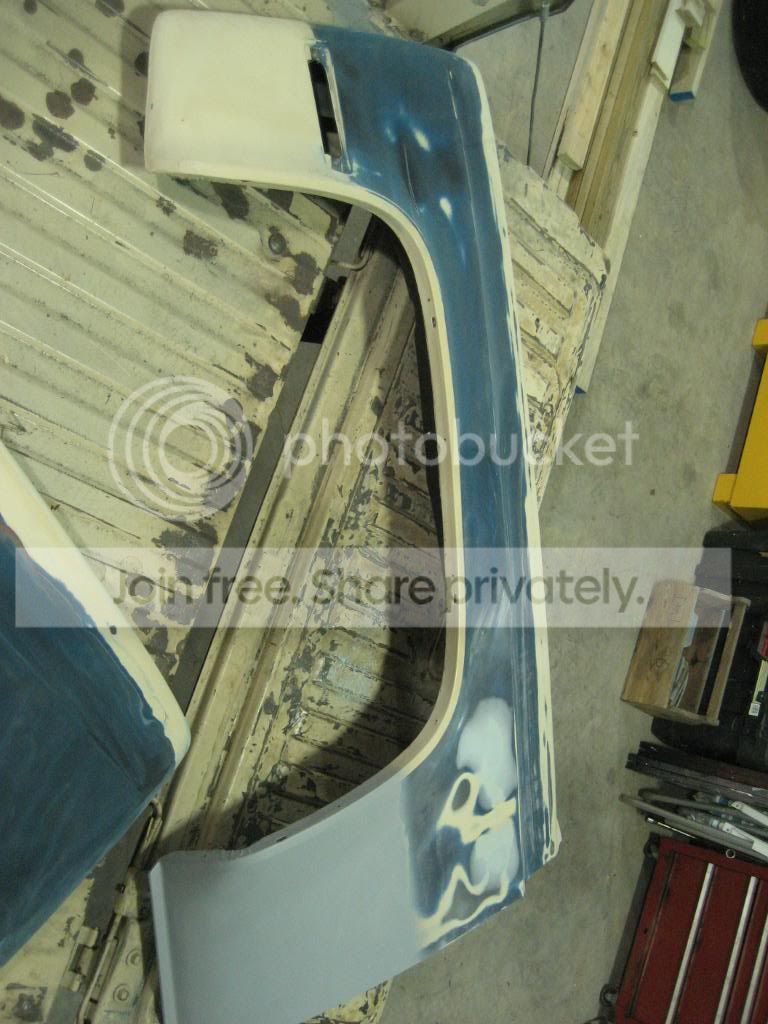

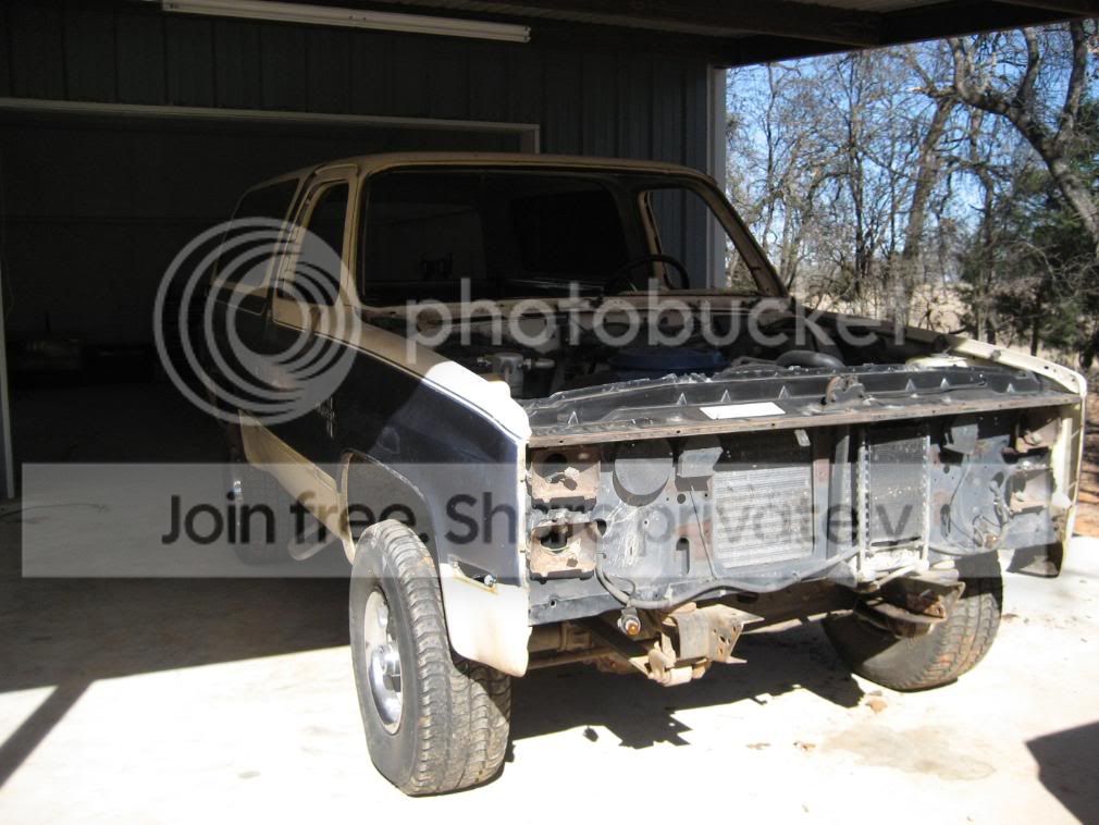

Various pictures of bodywork

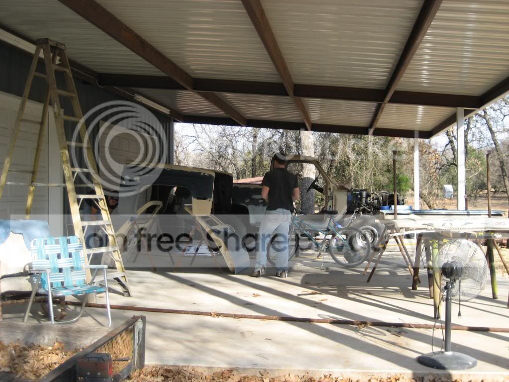

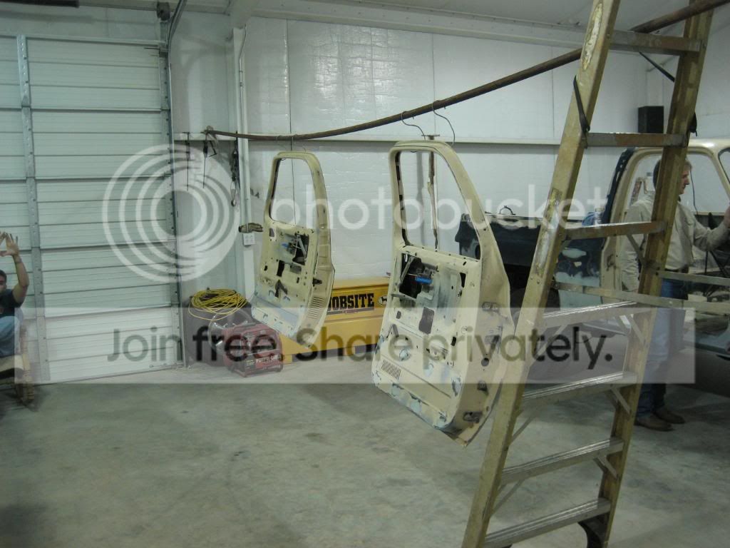

Everything moved out to be cleaned, and to clean out the shop to paint

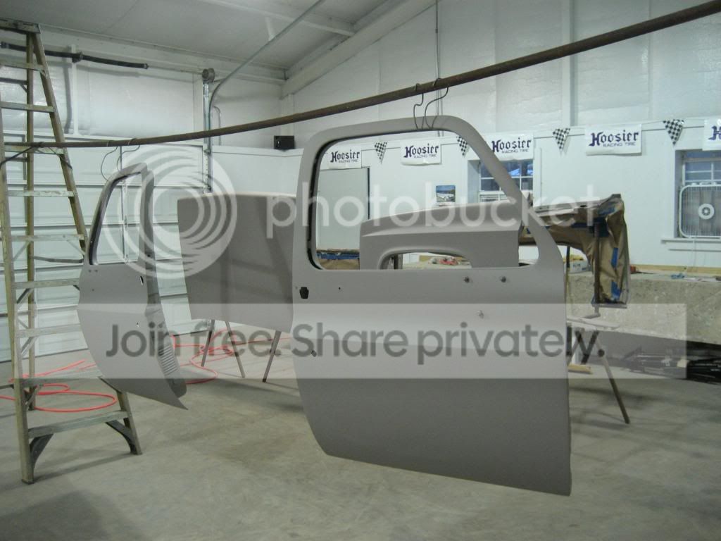

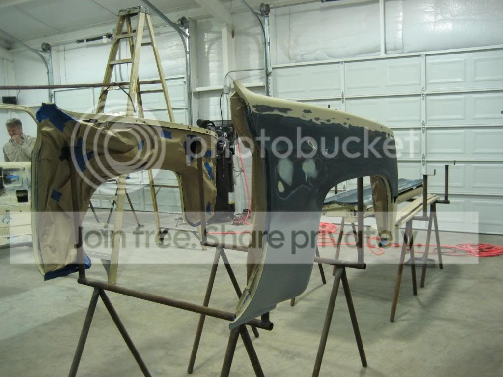

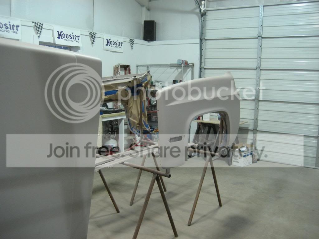

Set up to be primered

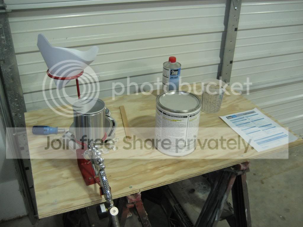

Paint setup shiz

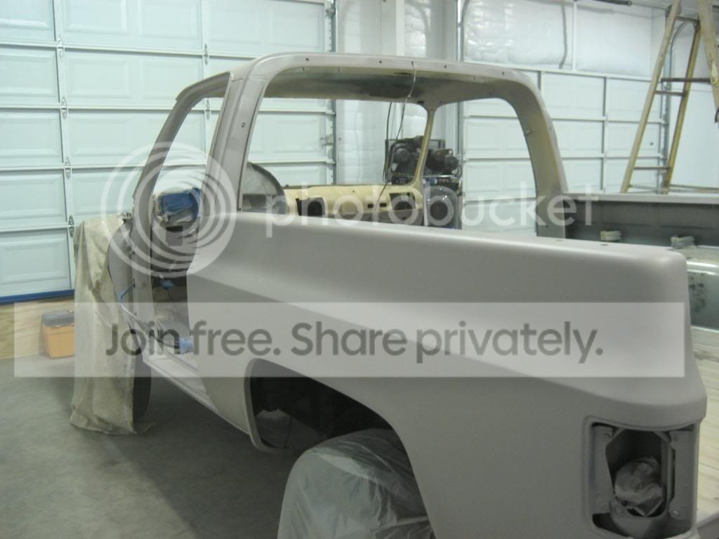

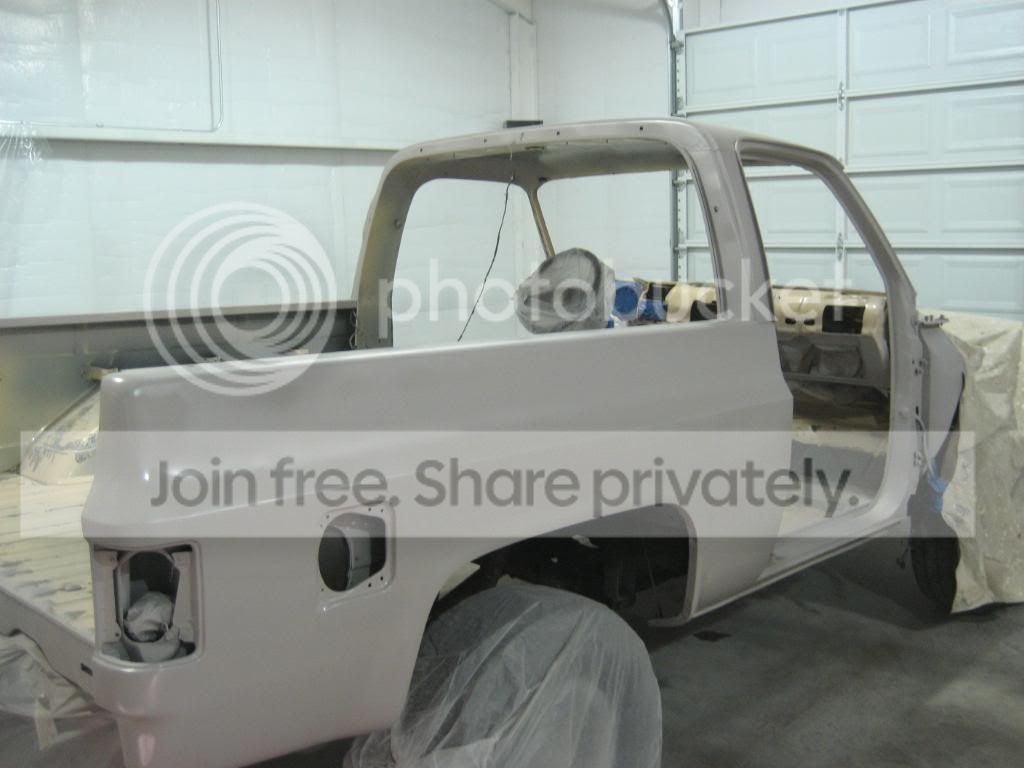

Primer time
As it sits, today I'll start blockin it out and doin some final work and hopefully will spray base and clear on thursday and friday
