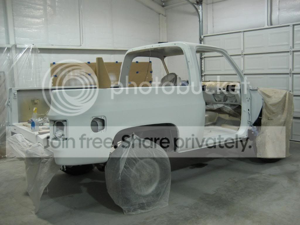

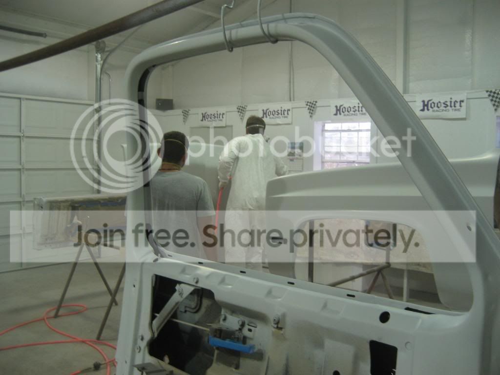

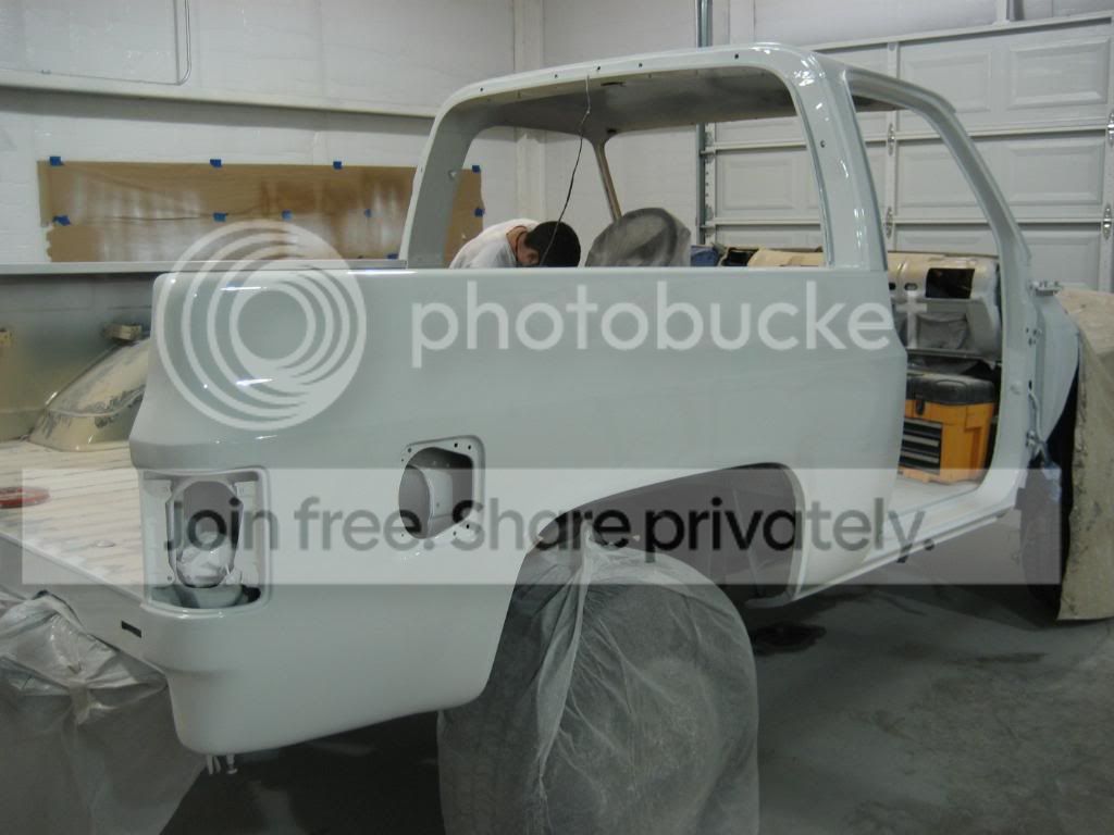

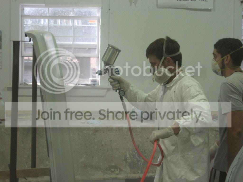

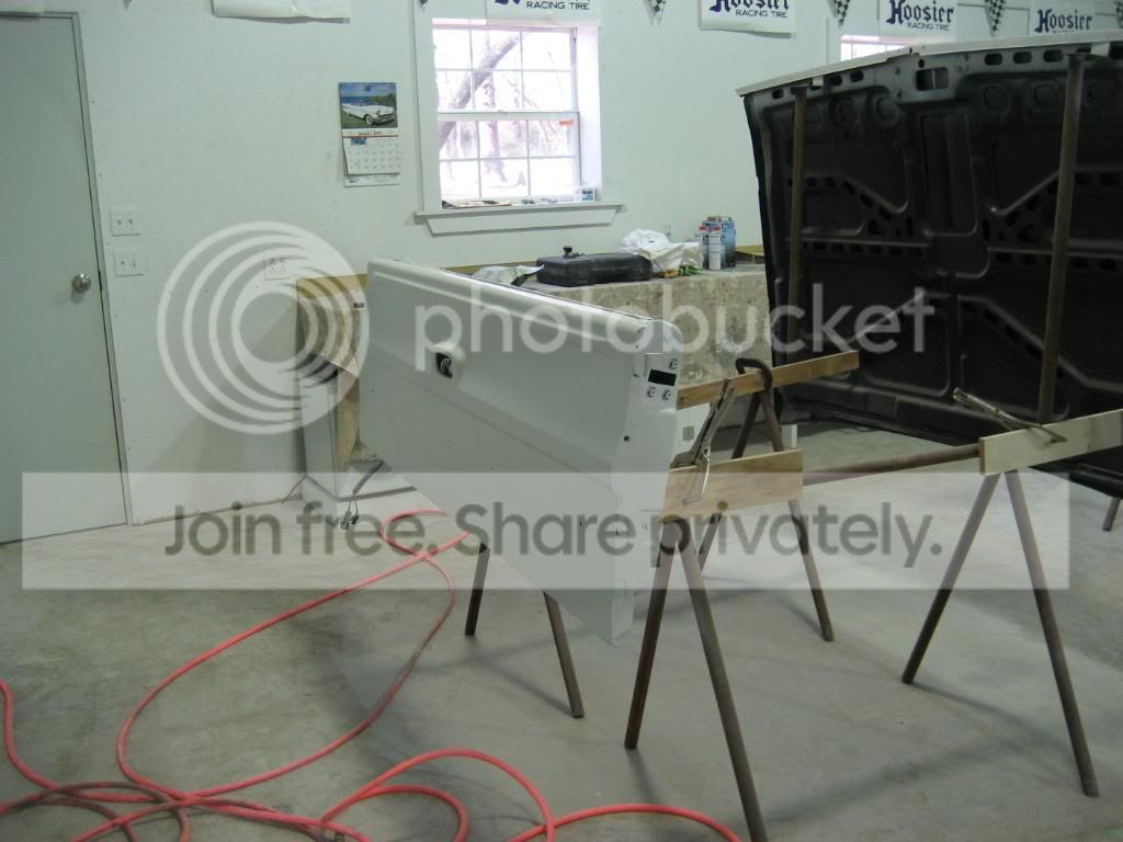

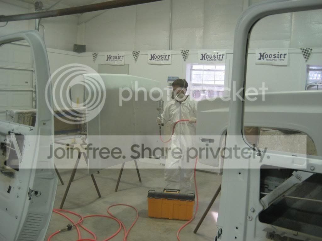

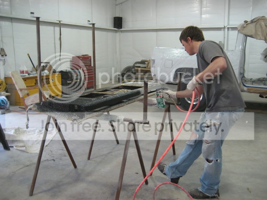

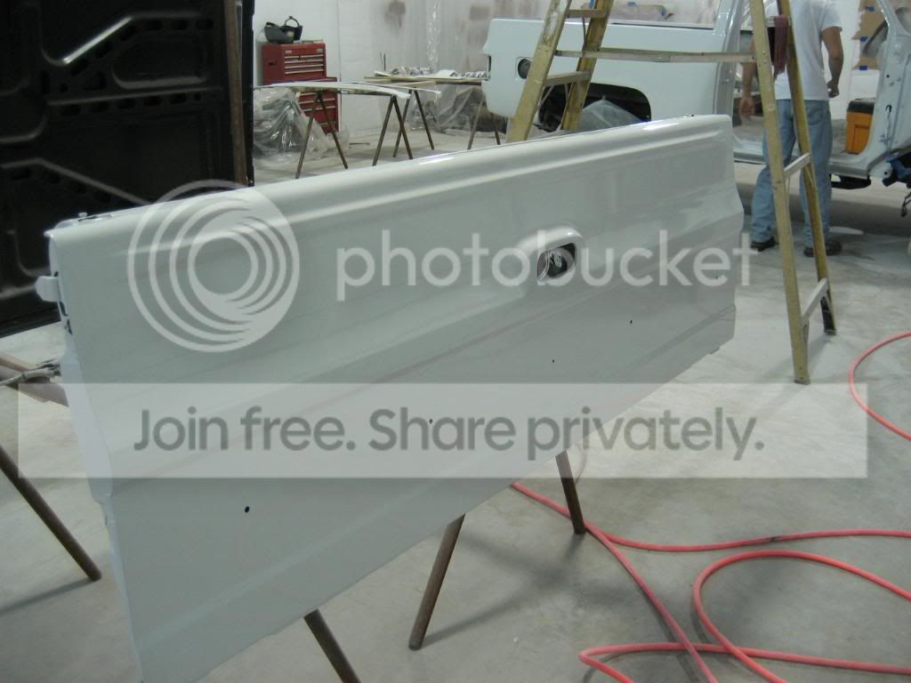

Various pics of spraying basecoat
Basecoat finally on
No action shots of spraying clear :cry:

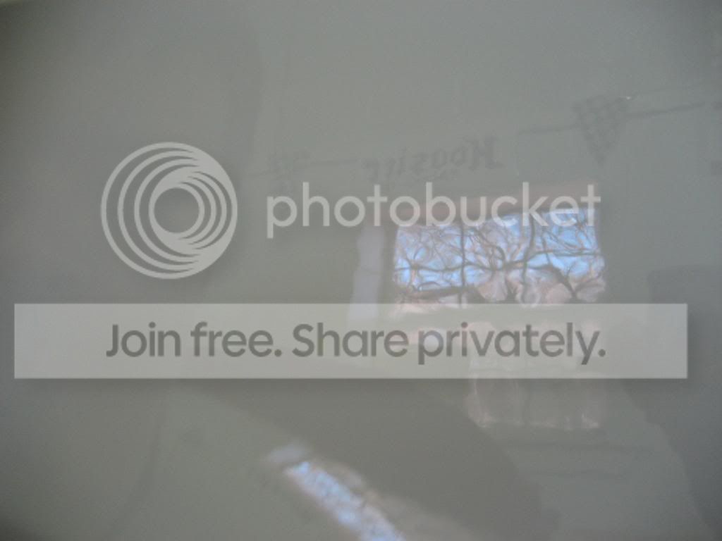

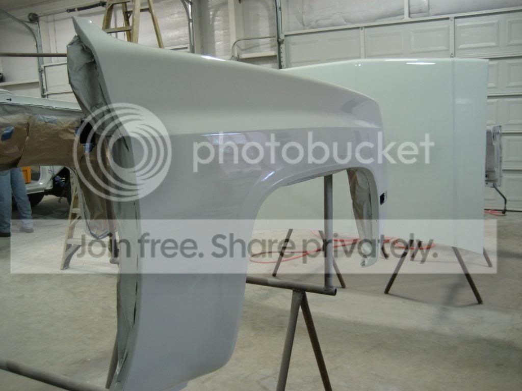

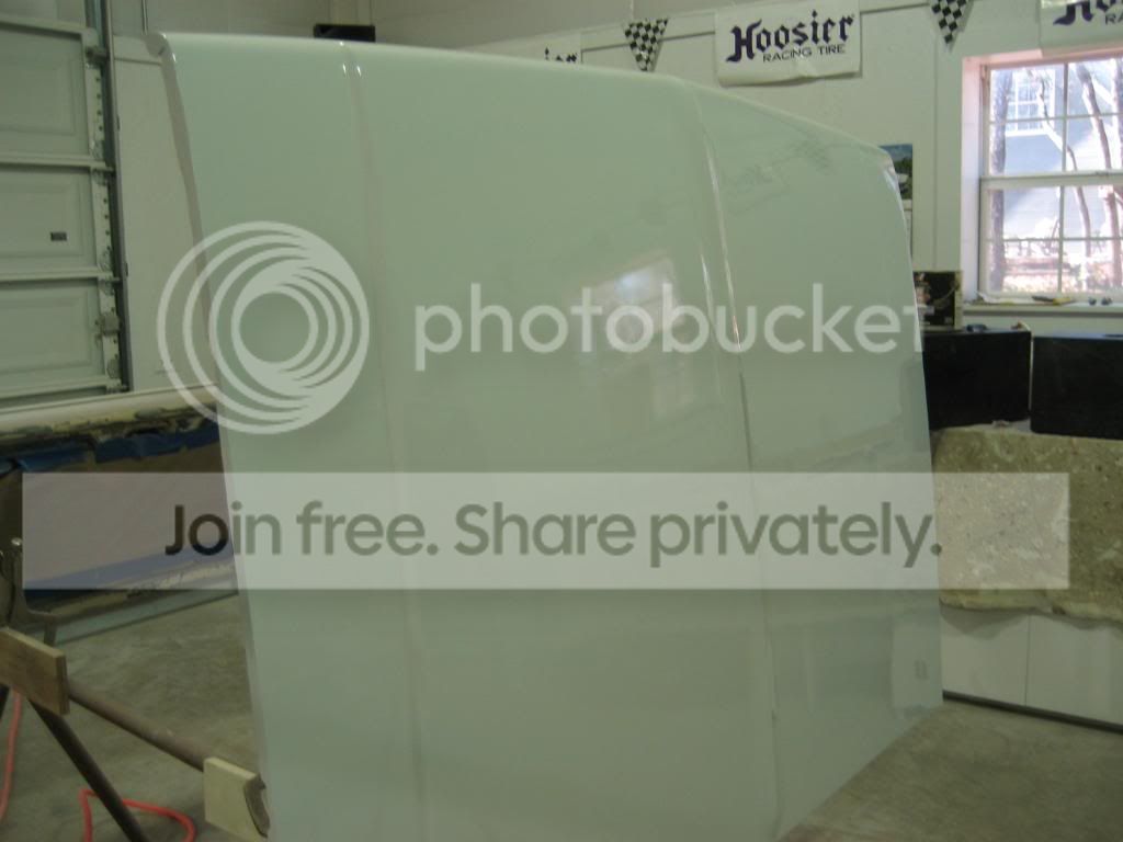

Clear sprayed

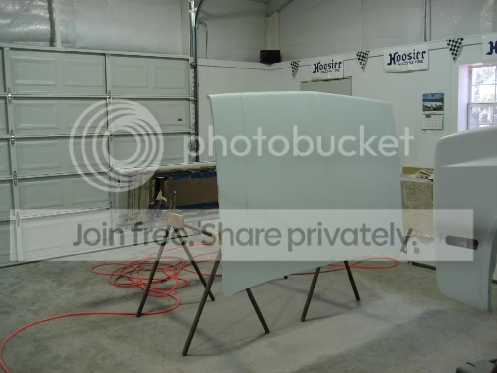

Hood looks slightly yellow in this, but it just the light
Not too shabby for not being wetsanded/polished yet
Still got a lil bit to do. Next weekend I should finish up all the painting and it'll sit for a while for the clearcoat to harden up so I can wetsand it

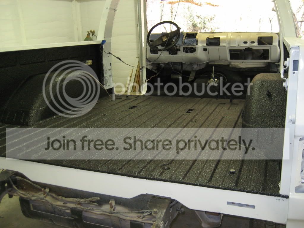

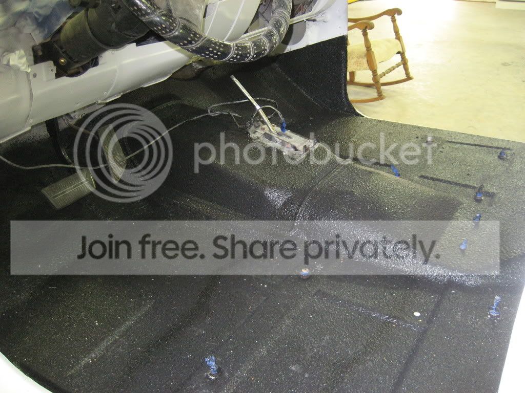

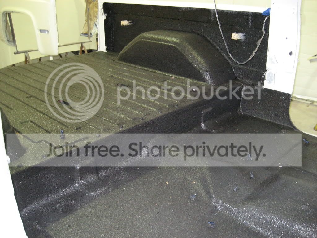

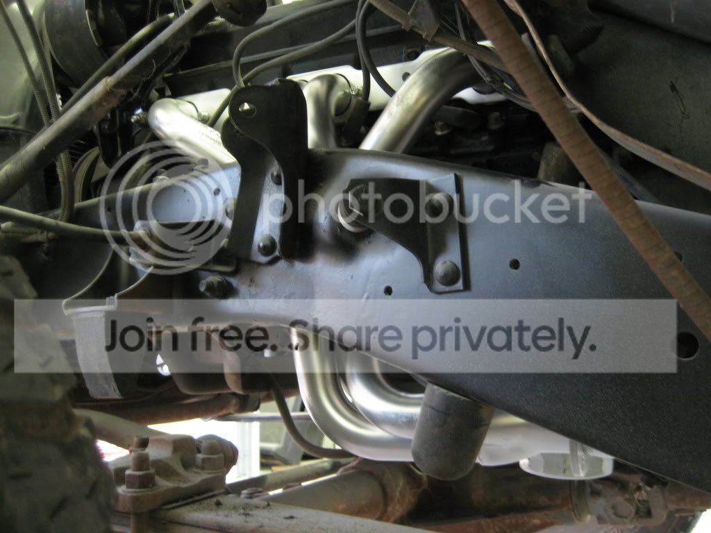

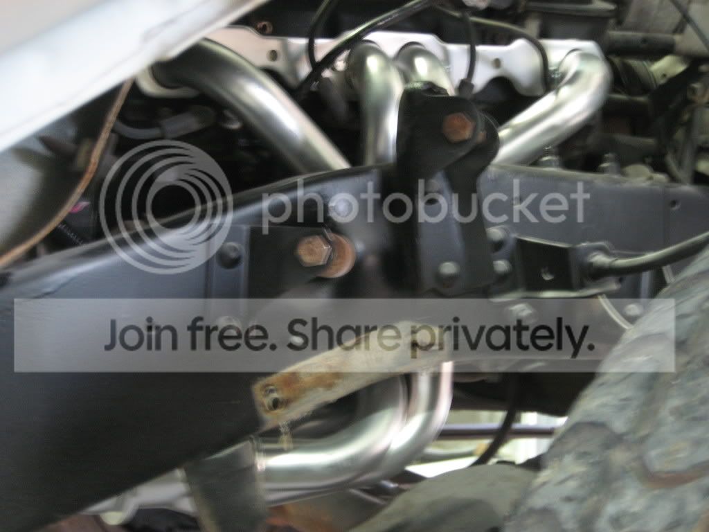

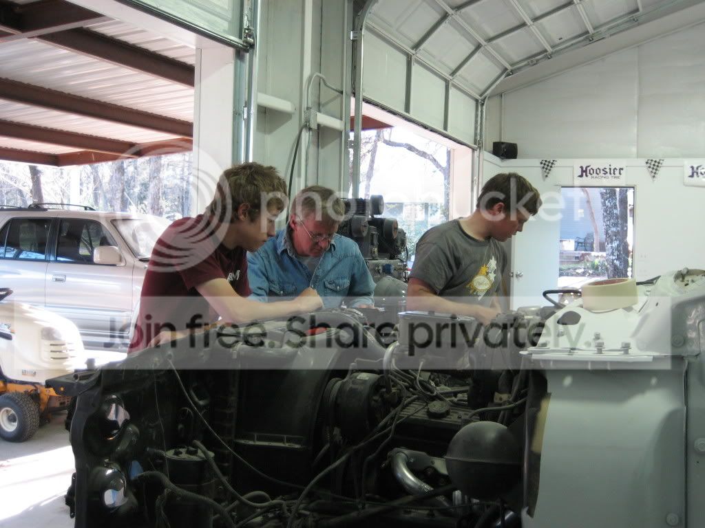

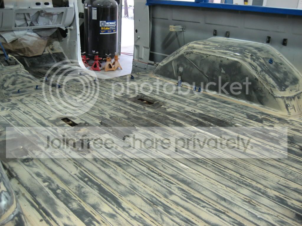

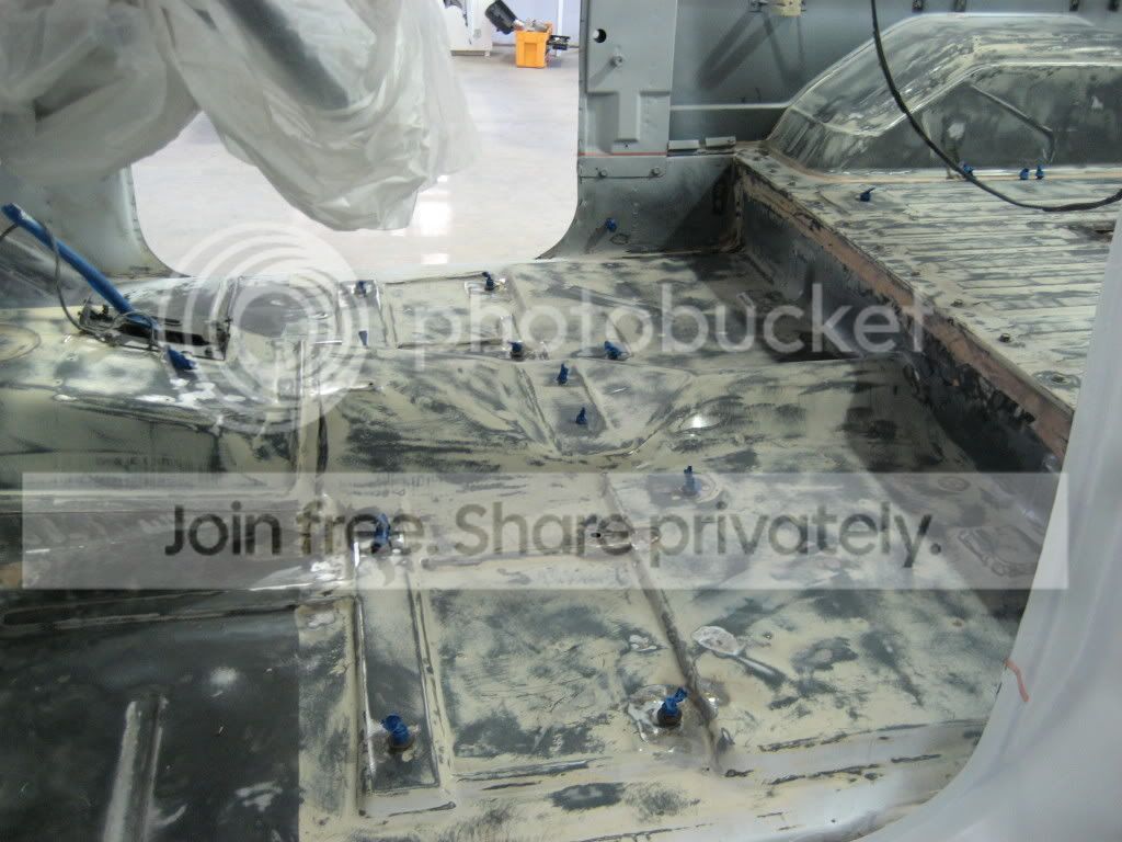

some more progress... mainly from end of spring break, and recently finished up the bedliner 2 weekends ago. Put the headers on over spring break with some supervision from a friend lol. Then we spent a while prepping the interior for the bedliner. I started on it and ran out of bedliner (which pissed me off because they told me that how much i bought would easily do a full size truck bed, and it barely did the floor on the cargo area and the tailgate :rant: ). I finished spraying the bedliner this week, and snapped some pics of how it sits now.

Great work :bow: I just read through your whole build and it's really looking great. Not sure if I missed it, but, what kind of liner did you end up using?
Oh, and by the way, I want your garage!:D
Its called Gator-Guard II. It sprays on THICK, and it seems like it will be really tough. I got some of it on some clearcoated areas (that won't show, so no big deal) and nothing would take it off (laquer thinner, paint thinner, etc). But then again, only time and abuse will tell.

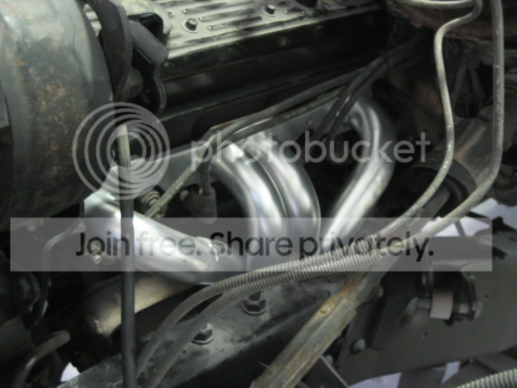

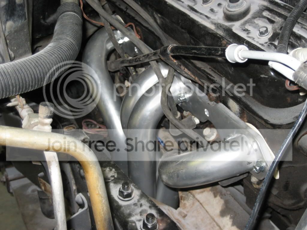

How did i miss this!? Looks awesome! Good job on the bedliner! Are those the headmen elite headers? What number are they?
yes they are hedman elite headers. Part number 69830. Its the same ones that Cricket posted a review about here http://coloradok5.com/forums/showthread.php?t=213472
I like them alot, but you will have to do away with the A.I.R. system and and have a o2 bung welded in for the o2 sensor. None of this was a big deal to me since I wanted to do away with the A.I.R. system to clean up the engine bay a bit and I am doing new exhaust anyways, so an o2 bung isn't a hassle. My install experience was not as lucky as Crickets, but it still wasn't that bad of a install. I had to pull the starter loose and get rid of one of the bump stops (for the front axle houseing I believe) but once again, not a big deal because the axle will never hit once it has the new lift springs on.

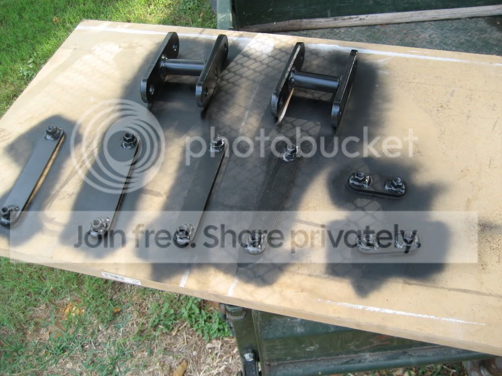

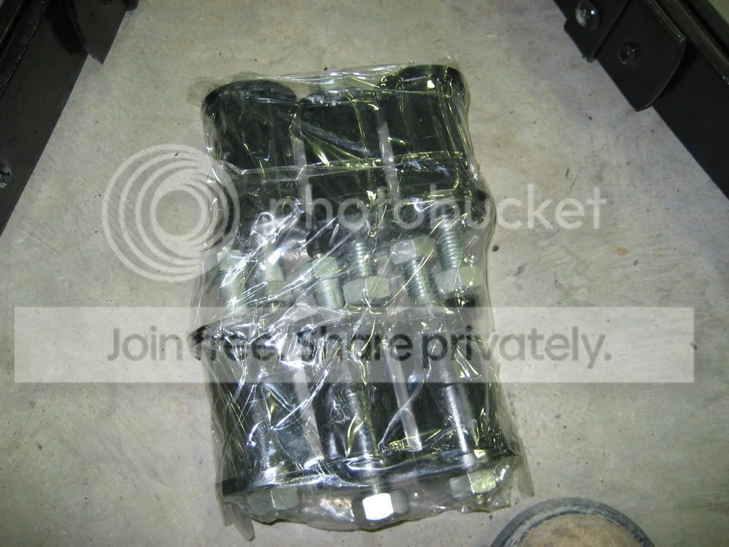

DIY4x Shackle Flip with cross tied shackles
ORD Greaseable rear spring bushings

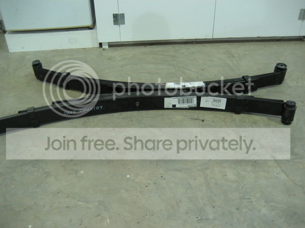

Tuff Country 4" Lift Front Springs

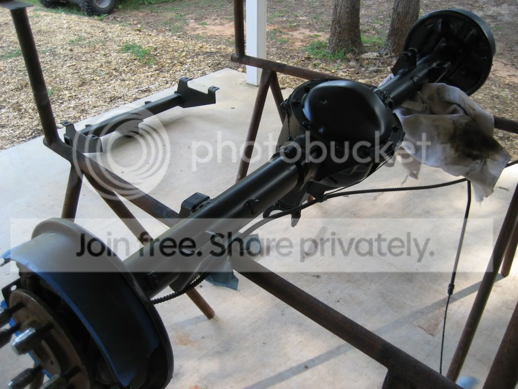

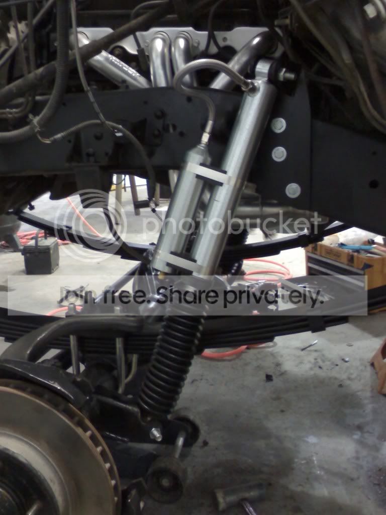

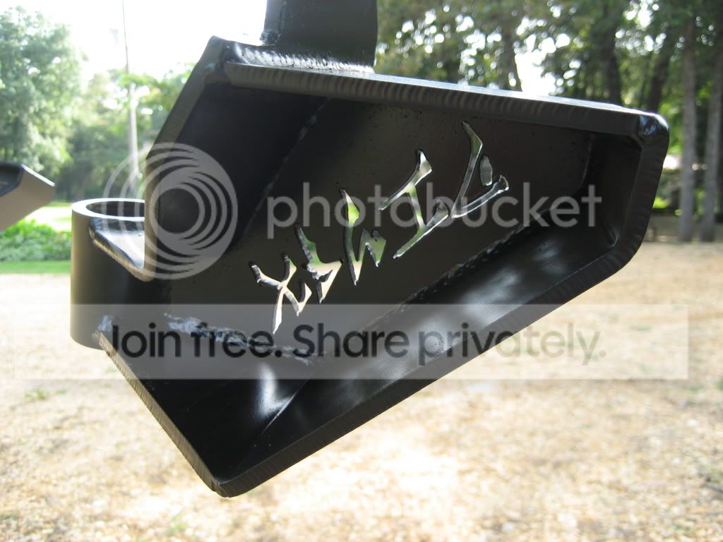

Lots of painting parts/axles/suspension/reassembly

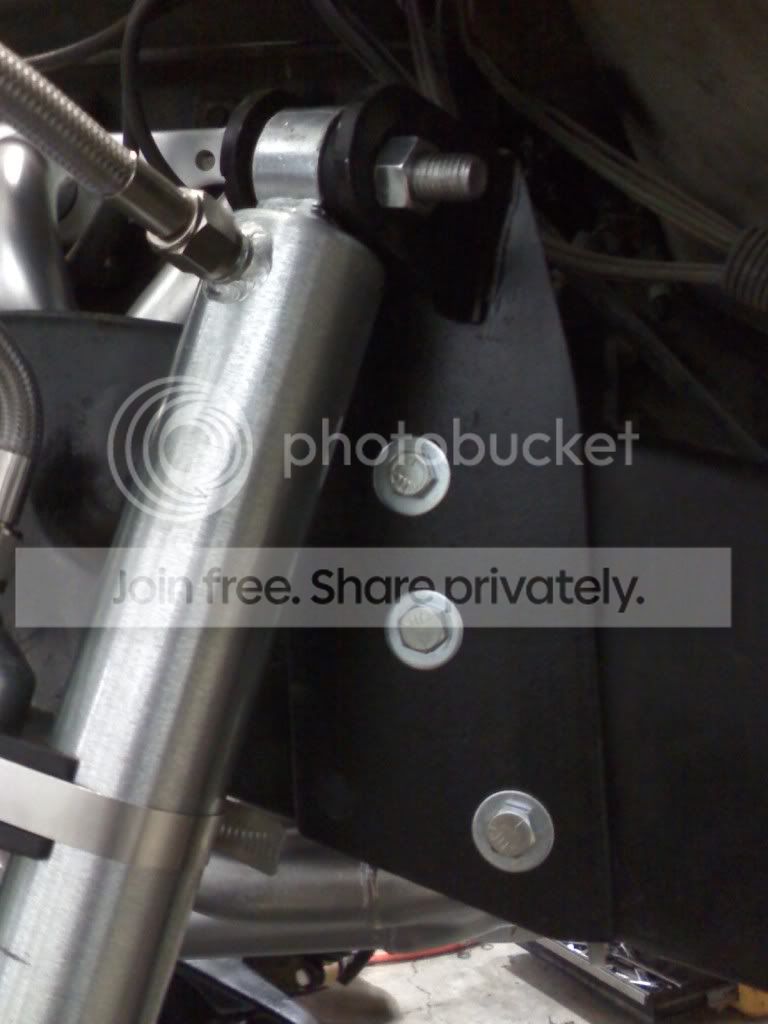

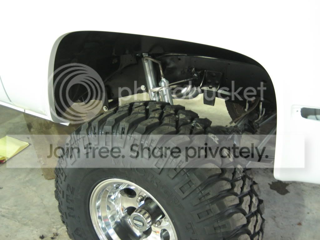

DIY4x shackle flip and inboarding kit, Tough Country front springs, greaseable bushings w/greasable bolts, MT wheels/tires, custom shock mount up front be me, Edelbrock IAS shocks, resi's up front, stainless braided brake lines, basically a bunch of goodies and I cant remember all of it :rofl:

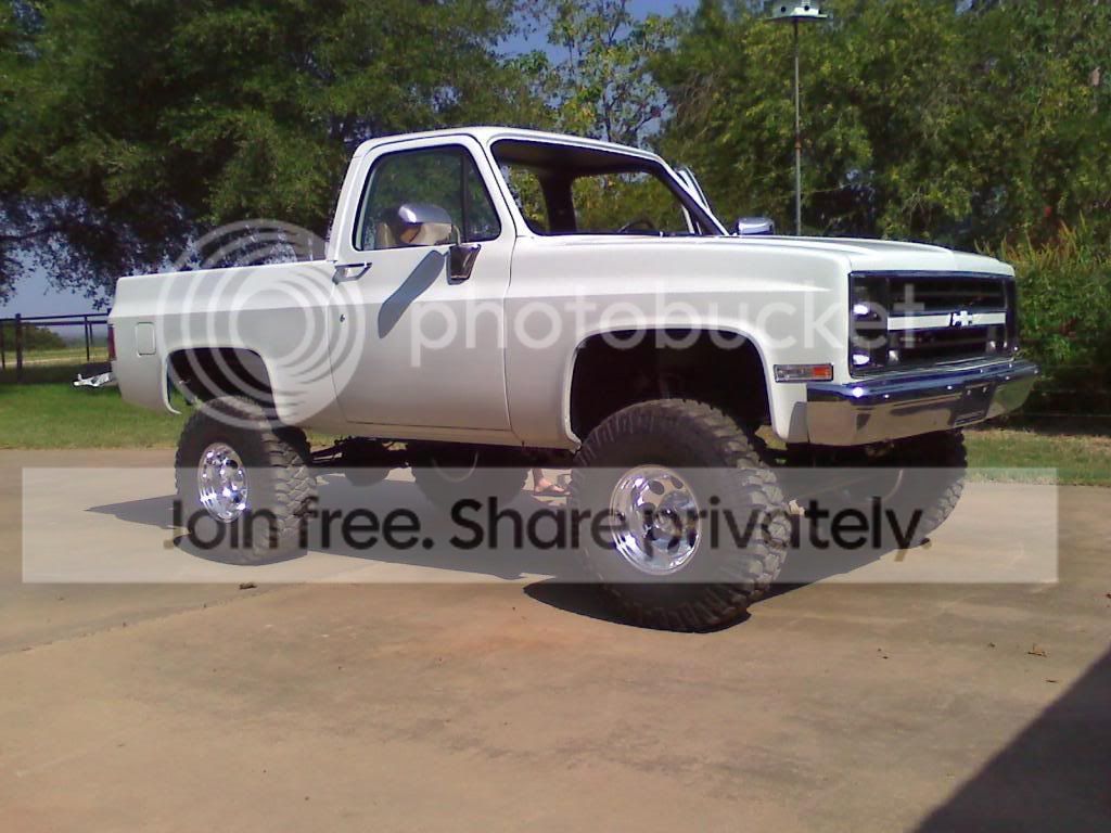

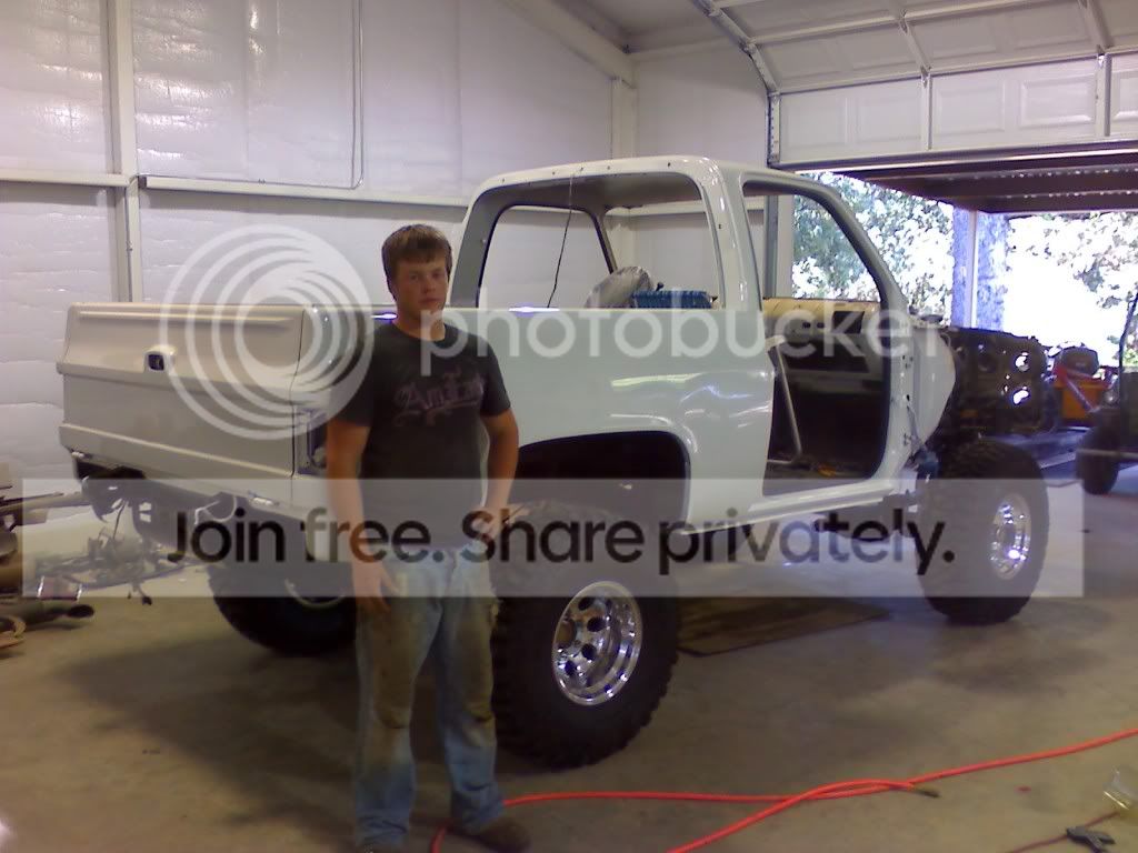

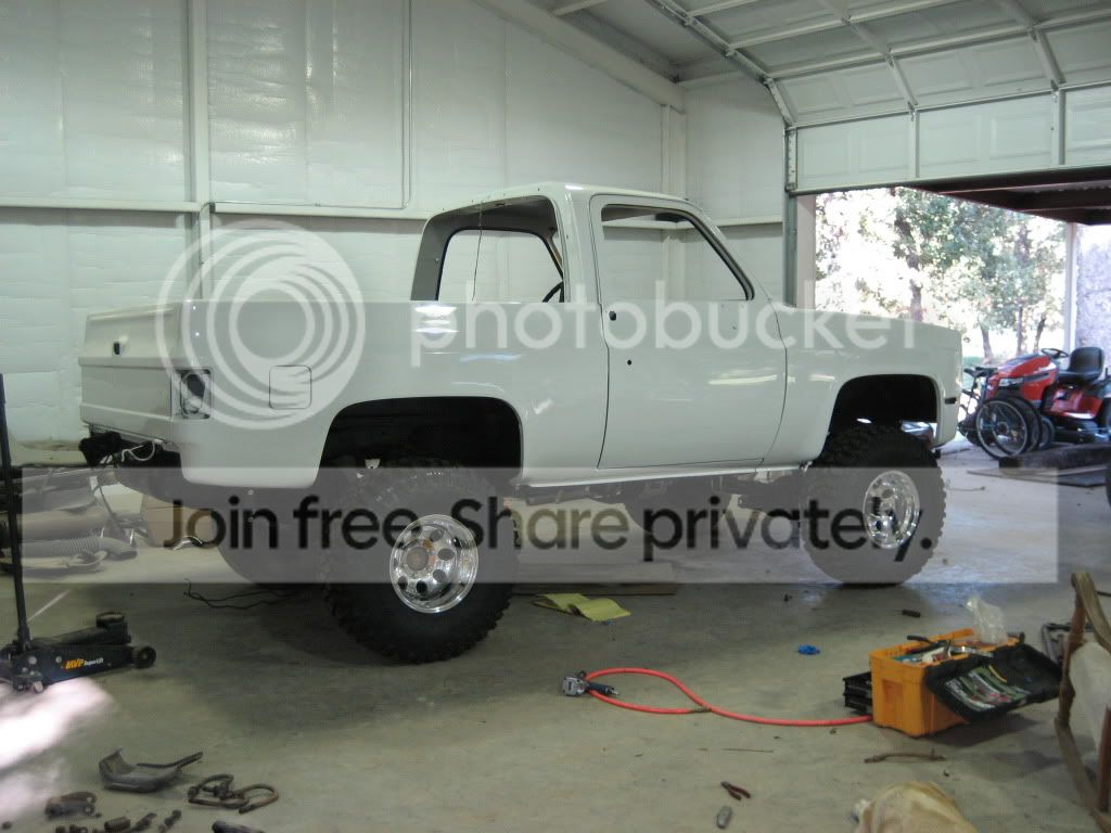

To get an idea of how tall it is... I'm 5 10ish...
pretty tall for 4" lift lol
And a teaser...first drive a 2 weeks ago. The paint is actually glossy, the picture just doesnt show it...stupid phone camera

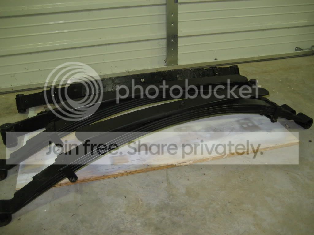

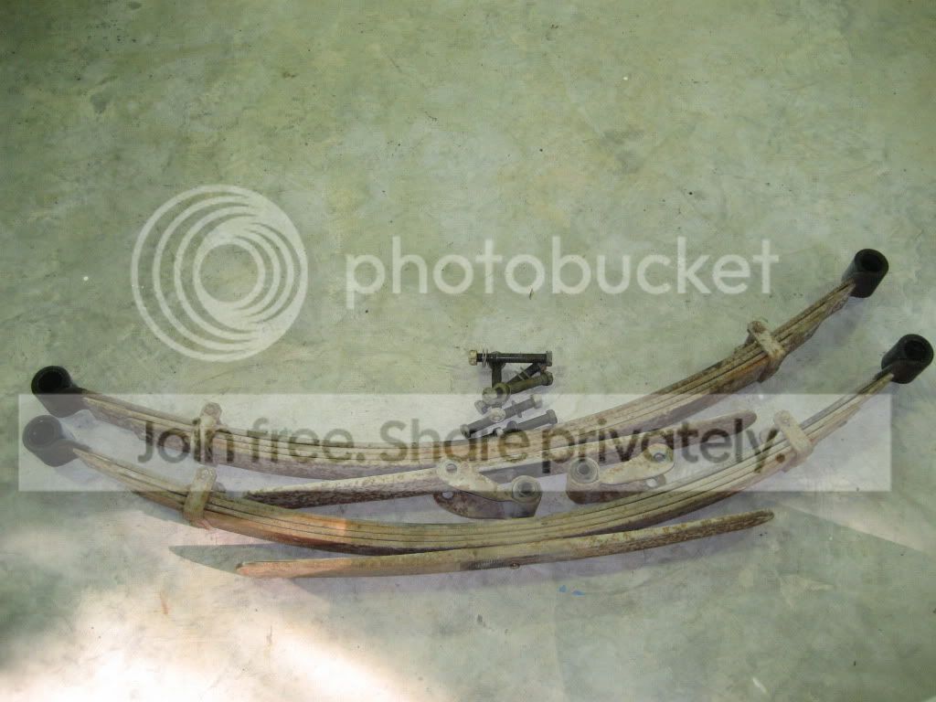

Also, did you go with factory rear springs (with the shackle-flip) and just paint them? I saw the pic of 4 springs total. Or did you buy new factory height springs? {EDIT: scratch that, I guess the first pic didn't load. I guess that's what that little red x means lol}
Yo dat jacket's tight son, naw meeeean?!?! lol:waytogo:
Looks awesome man. That's EXACTLY how I want to do mine! Keep up the good work and keep the pics coming. :bow:
Yep I just painted the stock rear springs. If I used new springs it would have had a really bad rake to it

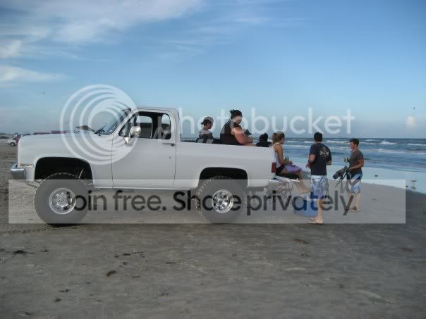

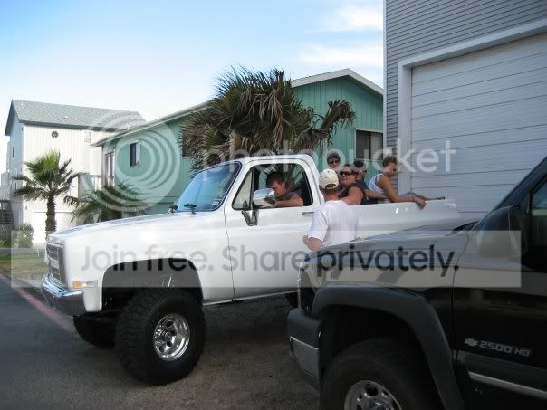

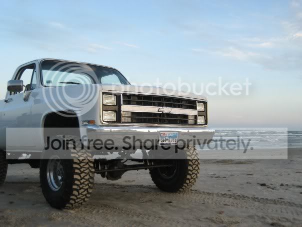

Its pretty much finished up...got a few lil things here and there to do, but its done and driving. Made its maiden voyage on August 18th. Went from my house near Waco to College Station, from there a 5+ hour drive to Port Aransas. It got romped on alot there as well as hauled alot of people, alcohol, and sand. After our lil vacation, I drove it from Port A to Houston, and back to CS. It was awesome, no hiccups, and it got 14.6mpg going there 8-) . It was a blast, and I'm really happy with the way its turned out for being my first project ever. Anyways, here are some pics.
Loadin up to hit the beach
Ballin hard to the beach, 1st day there
Cali-Lean anyone?
Beer!
Chillin
Sig Pic
Pussy Ford!
Lil guy was stealin my koolaid!
It was a blast and I was extremely happy with it. I was just happy to make it there and back with no issues, and we had a blast as well. I did have two causalities... My sub box got wet from washing the sand out and expanded and came apart (new and better one already built), and I bent the bottom passenger from fender from driving through a ditch (flexy suspension, big tires, not good). The fender is no biggy since I planned on trimming them anyways, and it didnt do any damage that isnt gonna be trimmed off anyways.
