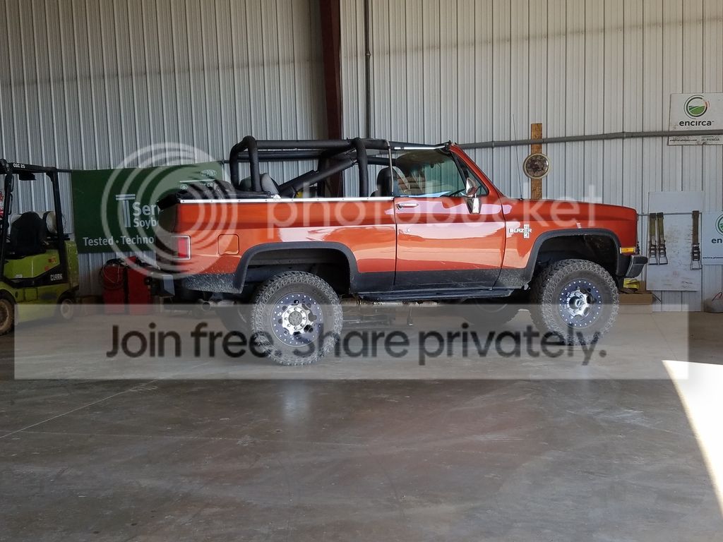

'88 Blazer 2016 Changes. Not many....Yea.

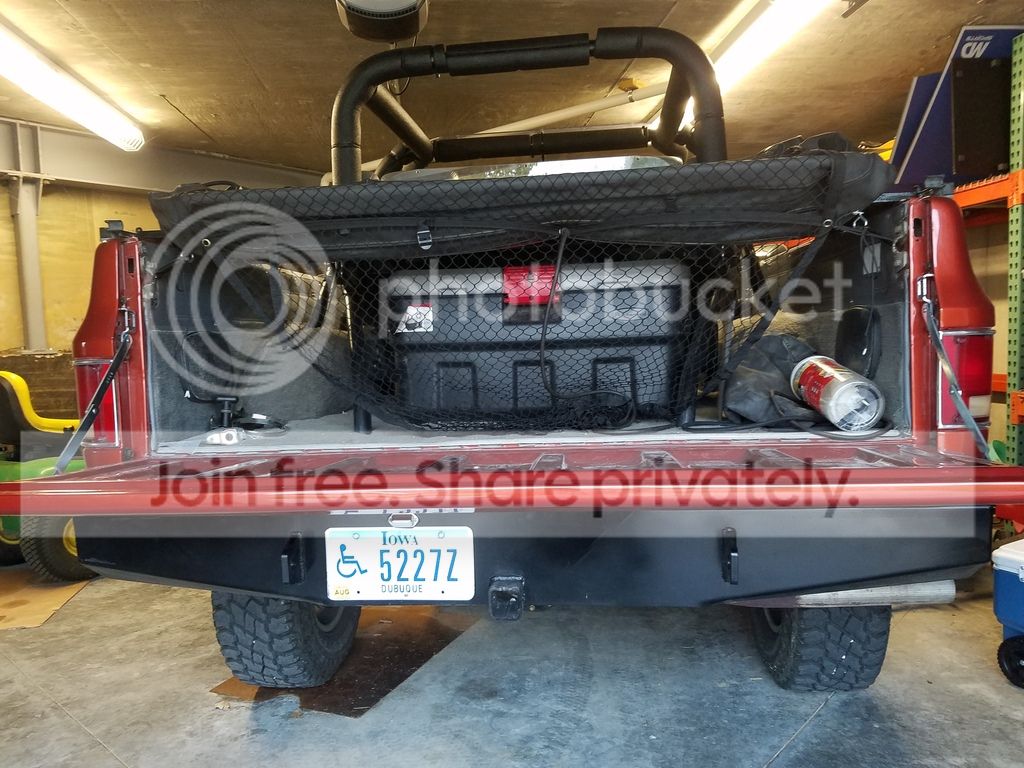

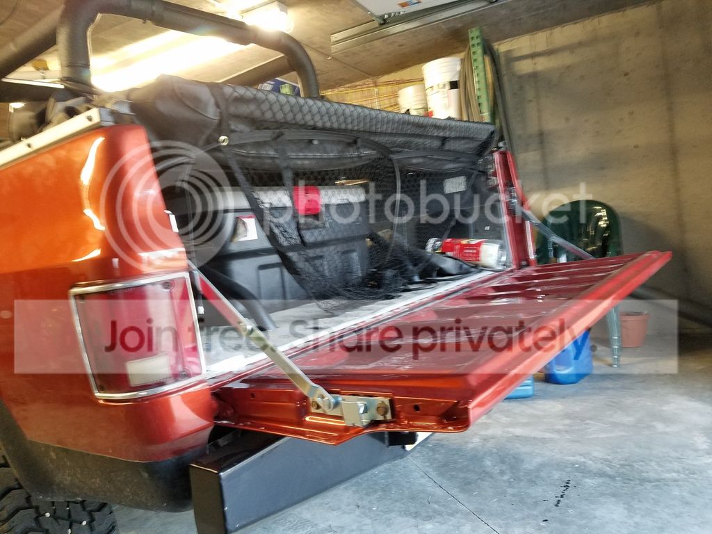

Getting some miles put on the truck this summer. I love driving it, but it's just not as nice to get into and out of as my Suburban. Some of that is my fault (lift springs :-)), but the Wheelchair lift is not the most reliable either. It all needs time and effort and I'm short on bith with kids getting into sports and other activities. I actually posted on a facebook page, that a group of us started to keep these older wheelchair lifts working, that I was considering selling it. Then I kind of chickened out and didn't give a price because I was afraid someone might say I'll take it. I guess I'm not ready yet:burnout:. I did get a nice truck tailgate as a Christmas present from my in laws. I got that painted and installed. One thing I love about it is the ease of access to the back and it increased the stuff I can safely throw back as well.
I cut a piece of plywood and painted it up to fit inside the soft top tracks. This allows us to just drop the soft top and throw a cargo net over and strap it without hassling to stuff it in the bag. The plywood holds it up nice to allow the storage. I like this setup and it didn't cost much:waytogo:
One extra bonus with the plywood. My stereo sounds so much better with the sound come off the plywood instead of the open air.
