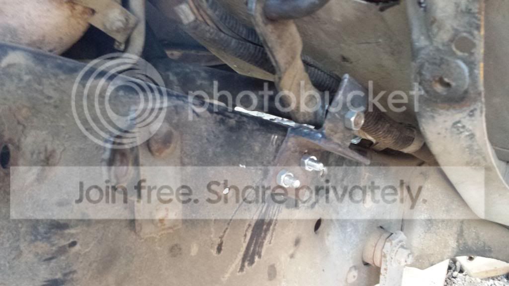

And, thankfully, also got the clutch linkage done today. The bracket isn't exactly like original but seems to cycle just fine. Weld a couple pieces of angle together, drill a couple holes, call it a day.

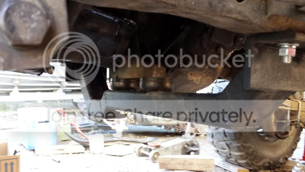

Now that the tranny/tcase is in, had a buddy of mine fab up a crossmember for me that turned out GREAT combined with some bushing from good ol' princess auto.

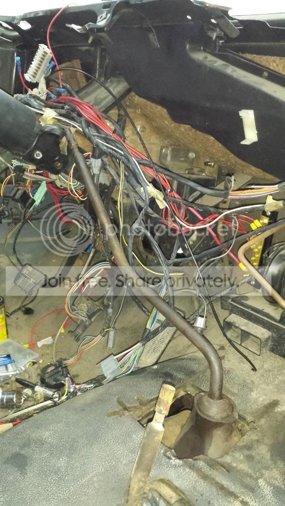

First one is the tranny shifter. Reinstalled but found that for whatever reason it's angled over to the side instead of back. The tranny did come out of a fire truck, so I'm wondering if it was a cab-over or something that would have placed it farther back centered in a wider cab. And before I hear about it, don't worry about the big ugly hole it came through, I've got a boot that'll cover that right up. :whistle:
I figure I'll likely cut-rotate-sleeve-pin to relocate it. Either that or go through the junkyard to see if I can find one that's already rotated. We'll see how it goes.

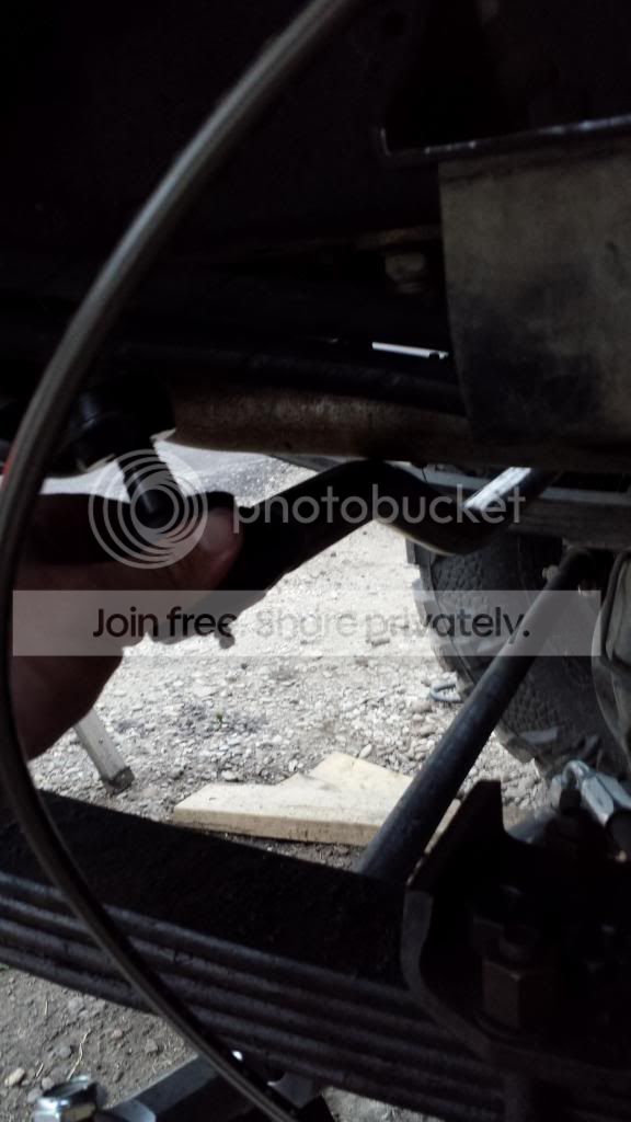

Second gotcha, got the steering column fully mounted today and went to finally put in the drag link on my ORD crossover setup. Unfortunately I'm taking a wild guess it isn't accomodating to the crossover pipe for the Banks. I know where my first call is going tomorrow morning, thinking a longer drop on the pitman might solve all my problems. Sorry for the silhouette type photo...

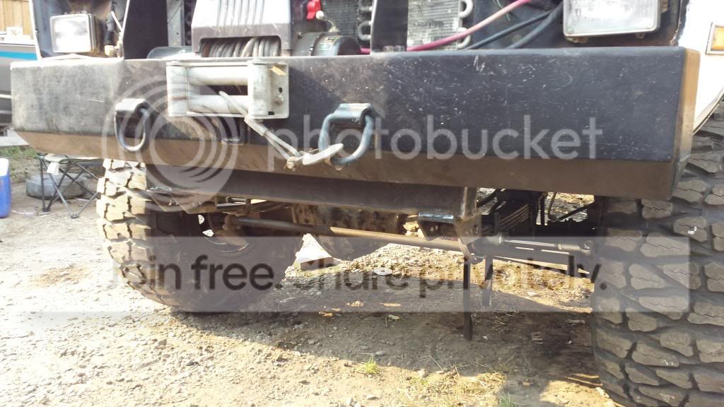

Bumper's back in with a shiny new coat of Por

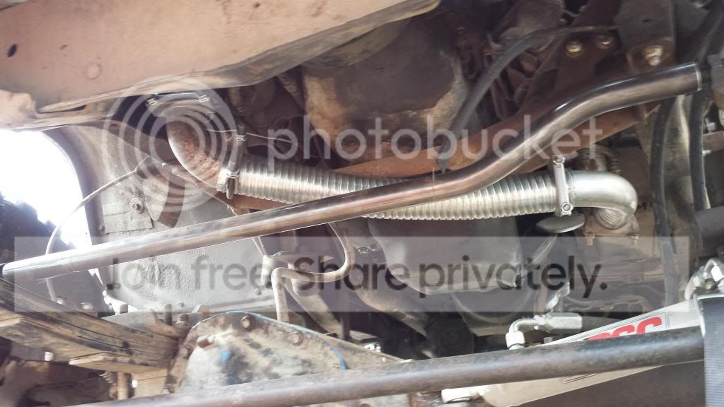

And the crosspipe for the Banks has been rerouted, albeit probably temporary. Wanted to figure out the routing on my own before I take it into a shop to have a proper piece installed.
Not pretty, but should be functional. Not sure how well you can tell from the picture, but there's still not much room left between the turbo intake on the passenger side and the drag link. I've already ordered the shorter studs from ORD so I can pull the lift block off the knuckle. I didn't lift it as much as I thought I was going to, so it's not really going to be necessary anyway. Hopefully those get here around the same time as the shocks and flares so I can take this thing for a rip! To the driveline place of course, have to get a from DS made up.

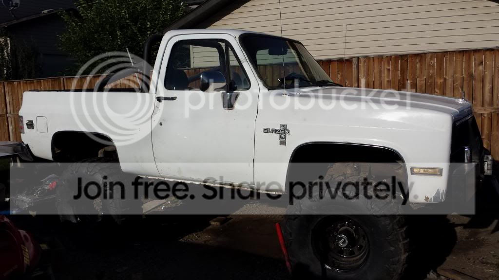

But now that I've got it set up, pulled the top off and easy to see a pretty solid rake. Tomorrow throwing some zero rates in the rear to move the axle back an inch, and hopefully finish a hanger drop bracket for the front springs.

Got the new studs from ORD and took out the lift block under the steering arm, gives me lots more room under the exhaust. I'll still be taking it to a shop to see what they can cab for that turbo crossfeed.

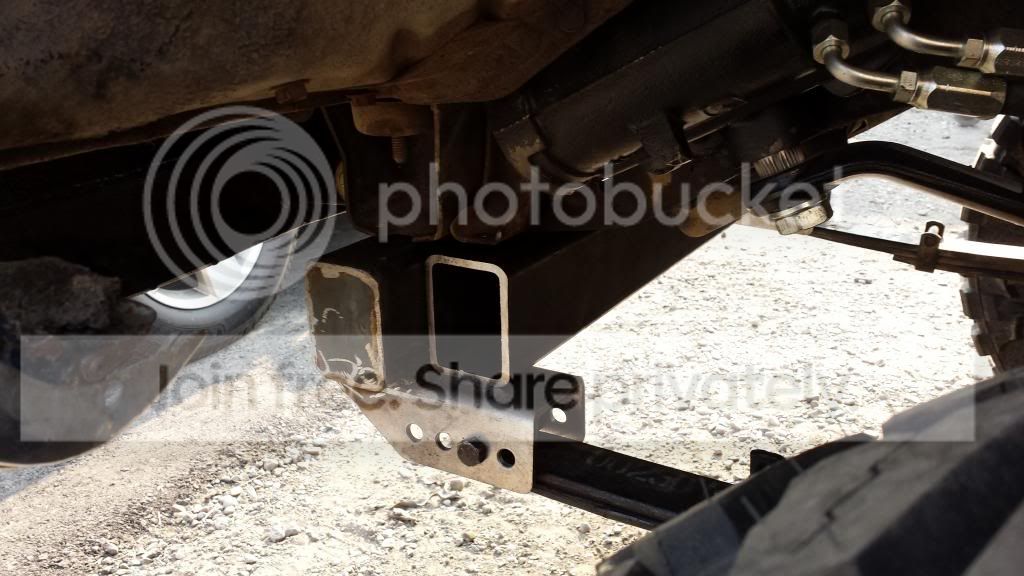

Alright, so put the add-a-leaf zero rate from ORD in the rear, moved the axle back an inch. Definitely more centered.
In the front we fabbed a hanger drop with a good length of 3x4x0.250 and some hangers from DIY. Looks good now I think but I'm going to move the springs one bolt forward in the front hangers to pull the axle forward a bit more, but mostly to bring down the rear shackles, get a better angle on them.
I've got just enough rake that it should even out when I'm loaded with gear and have the top back on.

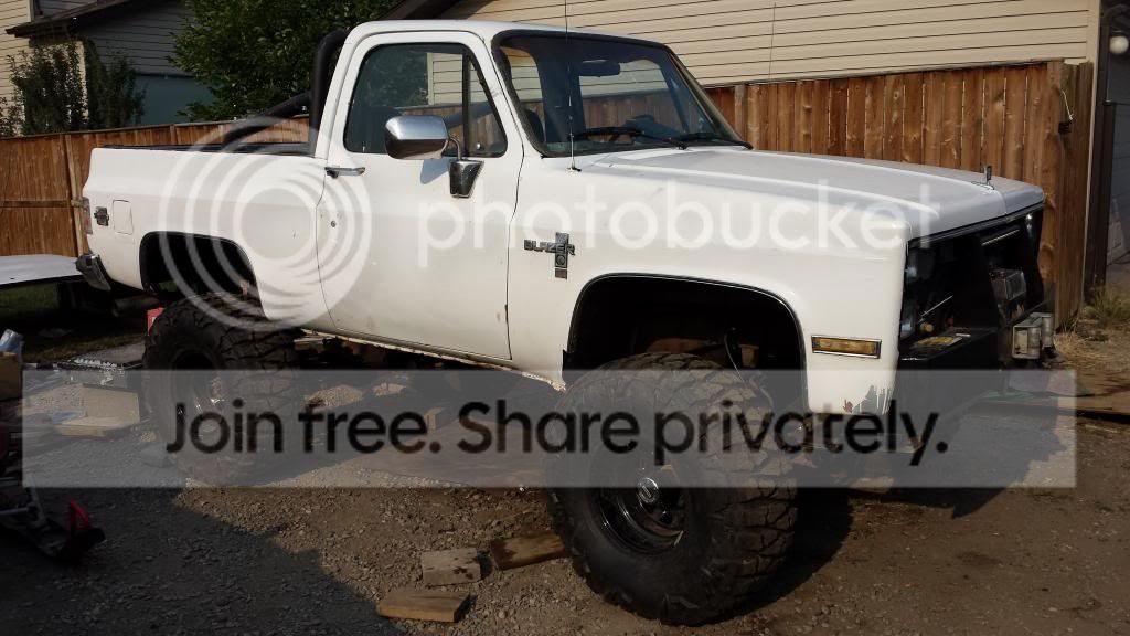

Well new parts, a few new switches. Went down to pick up shocks and Bushwacker cut outs over the weekend. Haven't installed either yet... The new front lift has given me enough room to turn the wheels about 1/2 lock so enough that I really needed to test it out and drive it around the neighbourhood a few times. With no shocks, sh!$$y steering, and a ram popping it's arm out into nowhere every time I turned left. :whistle:
Ran nice though! Today I got the dash bolted in finally, put in a new switch for the rear window (note: runs up and down MUCH better than it did with the stock switch without changing any of the wiring), put in my new switch bank, and got a lot of the other wiring out of the way. I've now got a working tach and daytime running lights (aka light lead straight wired to ACC power).
