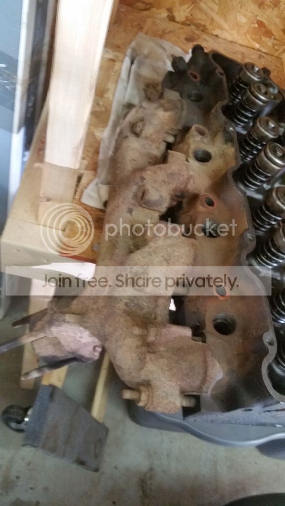

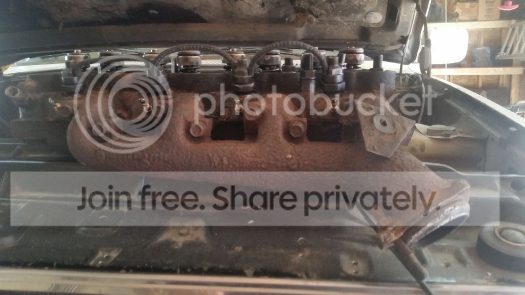

I've put the head in with the 6.5 mani for now just to check it out; it actually looks like a decent amount of clearance. I'm going to take a closer look tonight though, got a little tired last night so called it after I got the head planted. I"m going to be running the 6.5 mani on the PS because I'm going to be running the HX35. The Banks has the wrong flange for the turbo, and it was tight in there even with the small turbo so I'd have to be putting in a flange adapter so may still be tight. If I remember I'll grab a couple pics of the clearance underneath. The only real trouble will be getting the oil fittings in there. Will probably need to have another cooler line made because the hard line piece of the cooler return won't have any room with the 6.5 mani.
Reality is, it's going to be a custom crossover anyway. The original crossover is definitely going to give me problems with the axle there and would need to be modified anyway.
Almost forgot I've got to put a jack under the engine to level it out a bit. It's tight in there right now too because the tranny isn't in, but I'll get it mocked a bit then grab some pics tonight.
