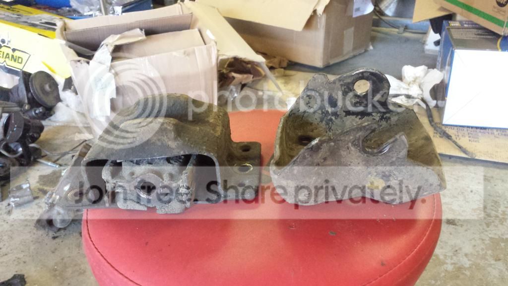

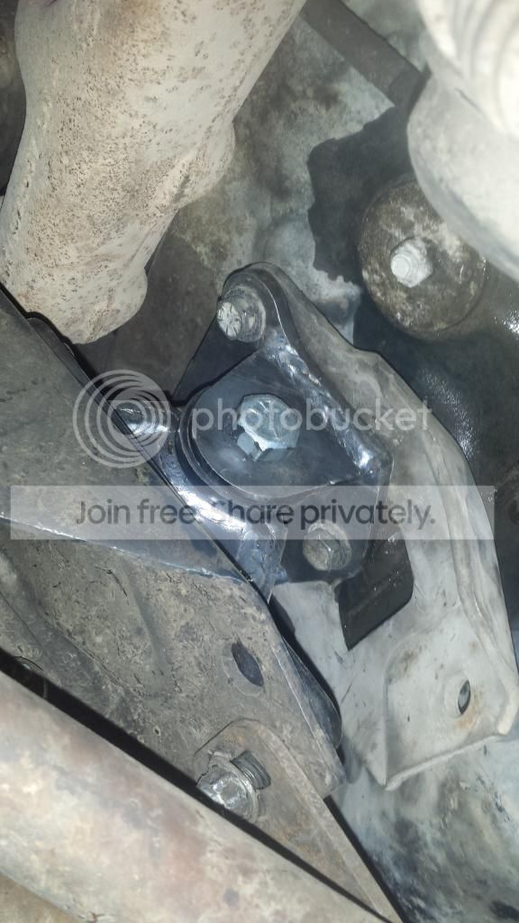

Went for a drive after that, just quick, got home to a huge cloud of diesel smoke. Turns out my motor mount was completely thrashed on the passenger side (driver to, but pass worse) and the downpipe off the turbo was pressed up against my injector return lines, burnt through a couple. Ordered up the ORD HD mounts and finally got around to putting them in over the weekend.

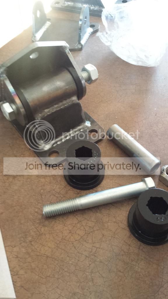

Out of the box:
Busted!:
Fancy new ones:
A shameless plug for ORD here... Their site isn't lying, there is a noticeable increase in the noise/vibration transmitted through the poly bushings vs the stocker rubber ones. I have to say though, just driving around town for a few hours yesterday and the entire drivetrain feels MUCH more solid. Absolutely worth the upgrade for anybody who thinks their mounts might be on their last legs. It was a bit of a hard swallow, $170US for the ORD ones vs $11CAD for the stock ones, but I'll never question these ones.

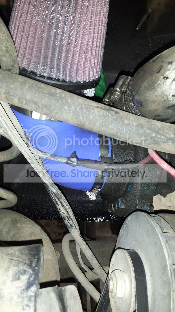

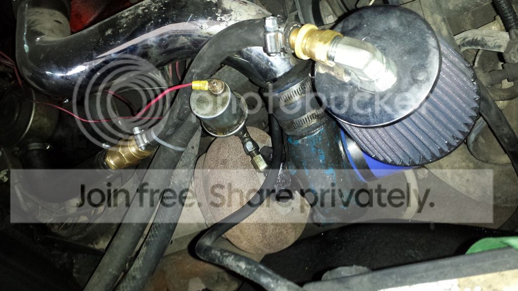

Alright couple of updates. Said above the intake box was trashed. Used the silicon 90 with exhaust pieces slid inside to reinforce it. Used a 1/2" NPT bulkhead fitting to attach the CDR.
Not the best pictures, but you get the idea.

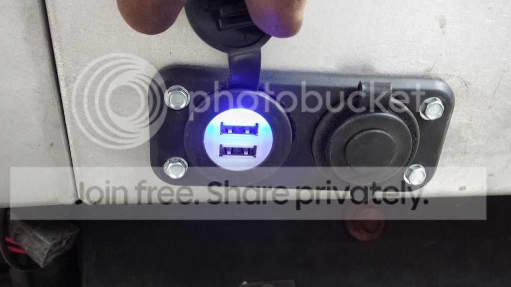

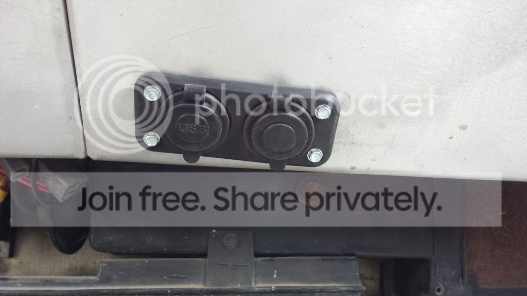

Then went to a GPS place in Calgary and got some RAM mounts for my GPS and phone. These are great mounts, all metal, 1" balls, very secure. Tek screwed the bases onto the dash. Can finally hands free some stuff! Power outlet as well, long overdue.
Ya I know the power went in crooked... Tough to fire in the tek screws while reaching up under the dash. Can't tell unless you're laying on the floor, so I'll suffer. Dual 2.1a USB on the left, standard 12v outlet on the right.

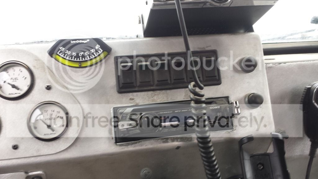

And can't forget the sweet $15 tilt gauge!

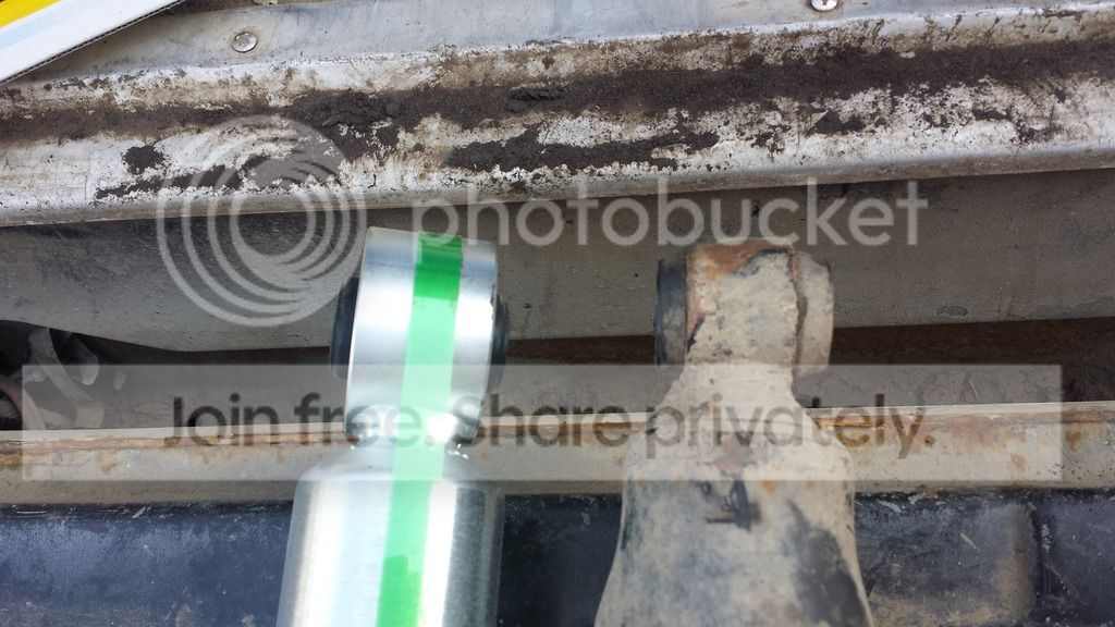

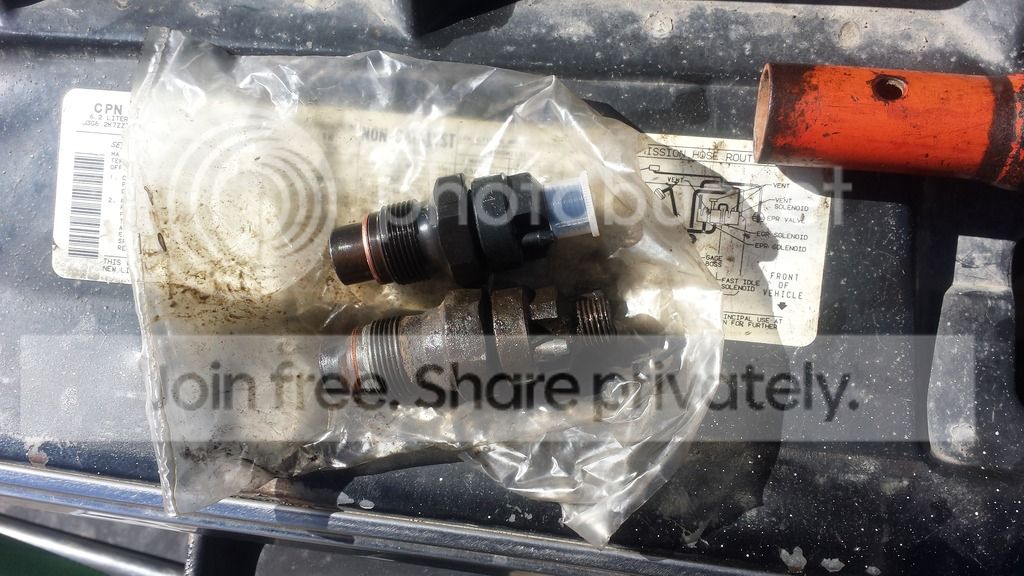

Actually did something significant over the weekend replacing the shocks and injectors. Went with the 6.5 marine injectors so I can swap them over into the new 6.5 once I'm done collecting the parts. Was a little worried swapping the long stock injectors with the short 6.5s, but runs great, turbo spools faster, overall happy with it. Shocks went with Bilstein 5100s 12" travel. Rides a LOT better than before, though it might be a little stiff for my taste. Anything is better than worrying I'm going to bounce off the road every time I hit a bump.
Just from the eyelets you can tell the Bilsteins are an improvement over the damn Zone OR ones...
