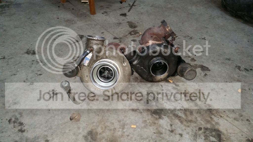

Ok good-ish news, looks like I can get my hands on an HX35 relatively cheap. Anything specific to look for with them, or just the typical no end/side play on the wheels?
Quicker spool with the 9cm housing that the 12cm basically there is two basic versions the HX35w and the HY35w the latter being the smaller housing but will increase drive pressure.. By how much I don't know, the Hy is stock on auto trucks so it spoils quicker..
Says it's a HX35W, I was actually considering the HY for the quicker spool before but as long as it's wastegated it'll still be better than the Banks. After the cummins fiasco drive pressure is my enemy.

Looks like there will be some work to do seeing how the turbo is clocked, but should just be a matter of cutting, rotating, rewelding the exh output. Then some creative plumbing on the air side. Nothing too strenuous.

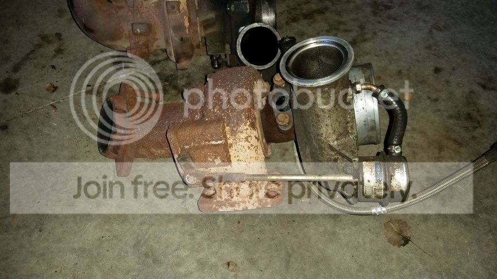

I do like that the WG is boost actuated though. Any way to adjust its response to 12ish psi, or will this be a home made turbo master?
You could make a turbo master. Or get a wastegate for it like a real one that welds in the exhaust.. Or leave it internally waste gated.. Just read up, I'm not sure what those came from the oem pressure wise. Usually if it's a high psi charger the wastegate will not work correctly at lower pressure. Again I'm not super familiar with the setup. Could be totally Wong.
