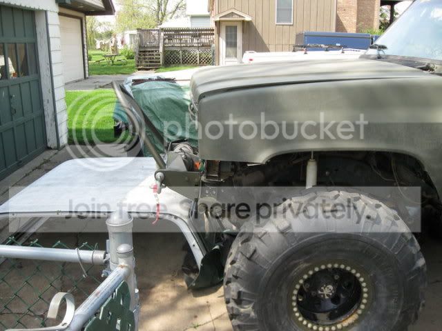

My bro and I bought a tubeing bender and decided a stinger for the front bumper would be the first project.
EDIT: In the above pic you can also see the power steering cooler mounted just to the right of the winch. I also replaced the power steering pump and extended the reservoir neck. If anyone wants a pic of that let me know.
The bender only goes to 90 degrees so this was made from two pieces then welded together. Here's a side shot:

My brother and I ordered a tubing bender from Speedway motors. It only goes to 90 degrees so the stinger hoop had to made out of two pieces of tube:

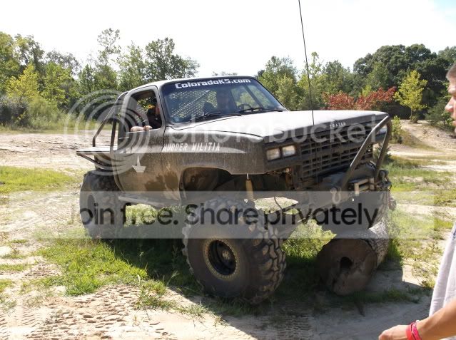

We re-painted the entire truck and took it to the Badlands Off-road park for my Bachelor party in August:
Yes as you can see in the last pic, the drivers side rock slider wasn't finished in time...of course my brother smashed it on a tree log in the his first 2 minutes behind the wheel lol!!
Here's a few pics from the trip:
