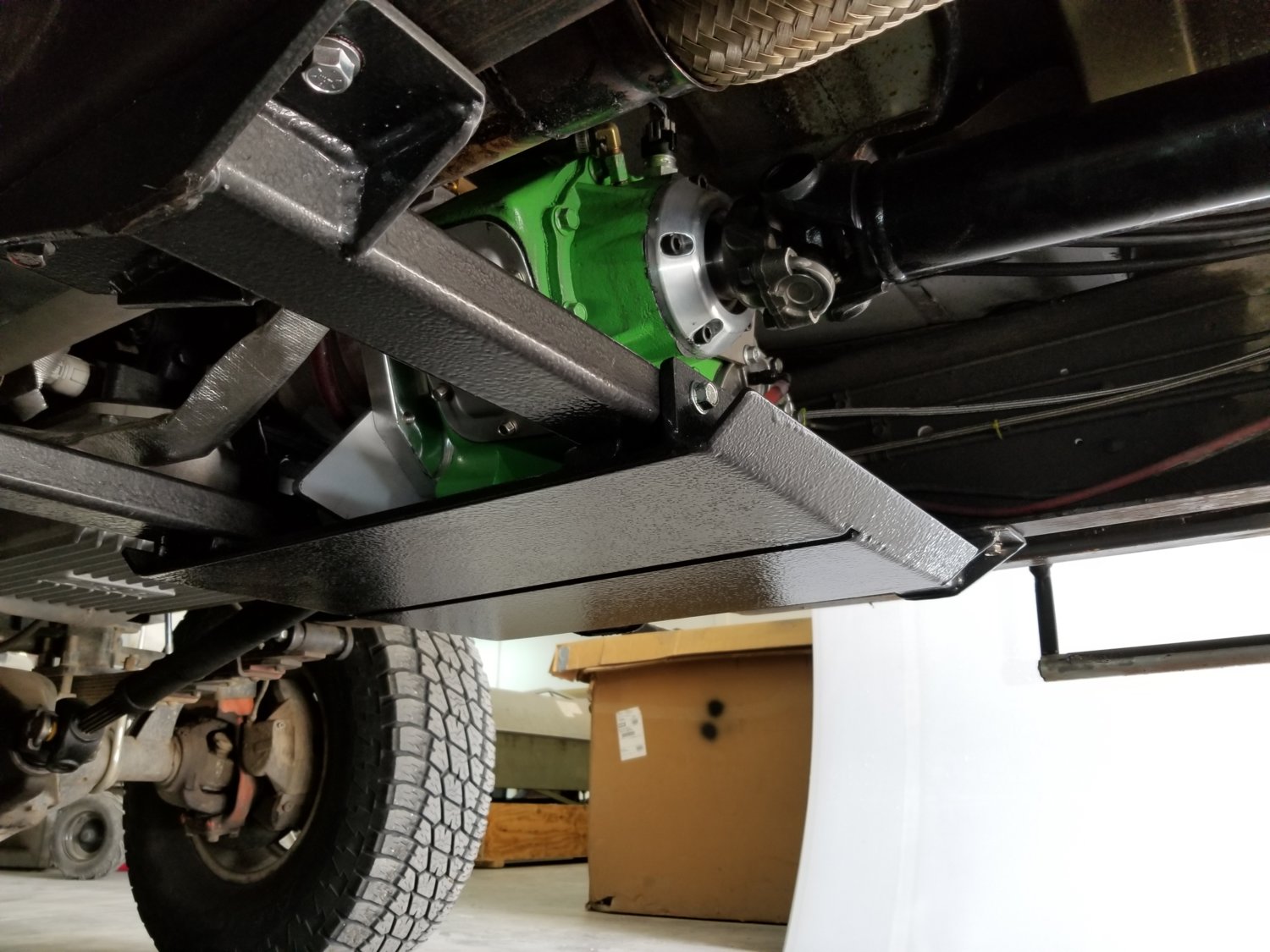

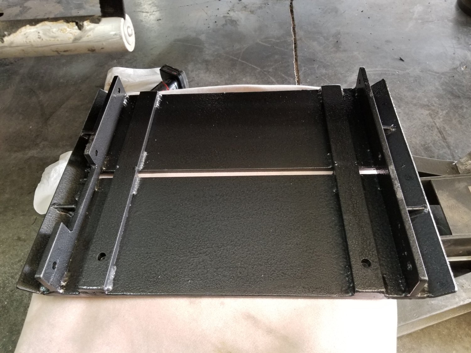

Did some work Sunday afternoon. Finished painting the stuff I rushed to fab before the Chinaman's trip; the skid plate and carrier bearing crossmember.
full
The plate is 1/2" below the crossmembers so I added those 1/2" thick flat straps across so the pressure is on the crossmember and not the bolts. I also added the "ramp" pieces to the front and rear. I thought about doing angled pieces on the sides but I decided to leave it open so dirt and mud can wash off.

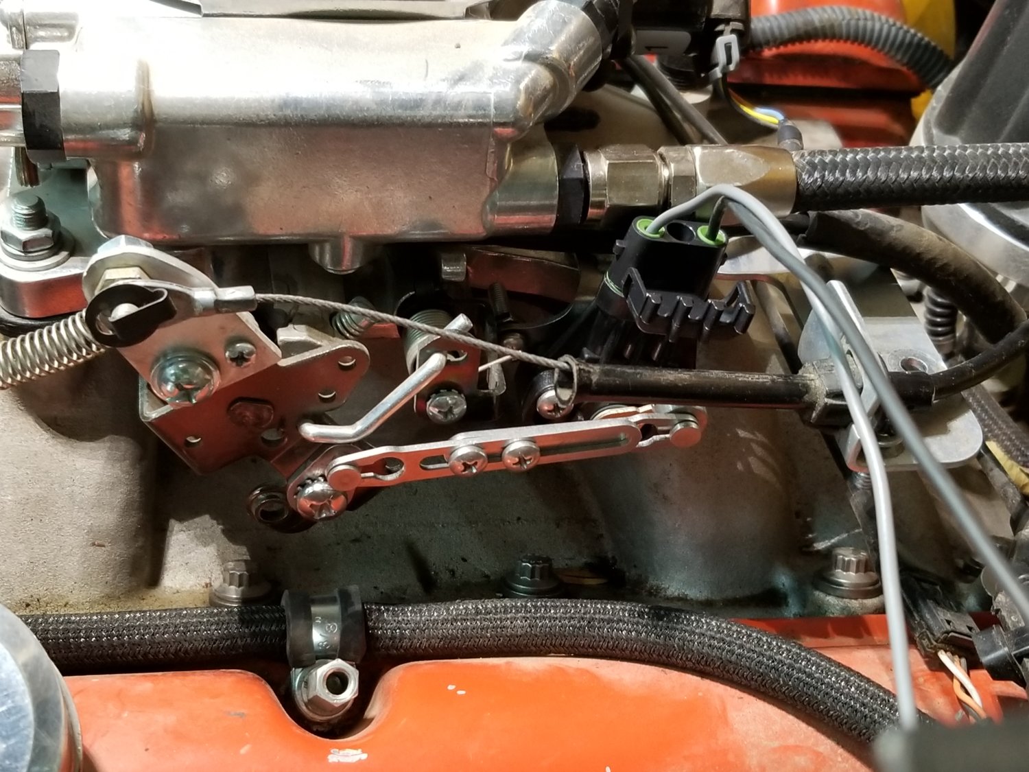

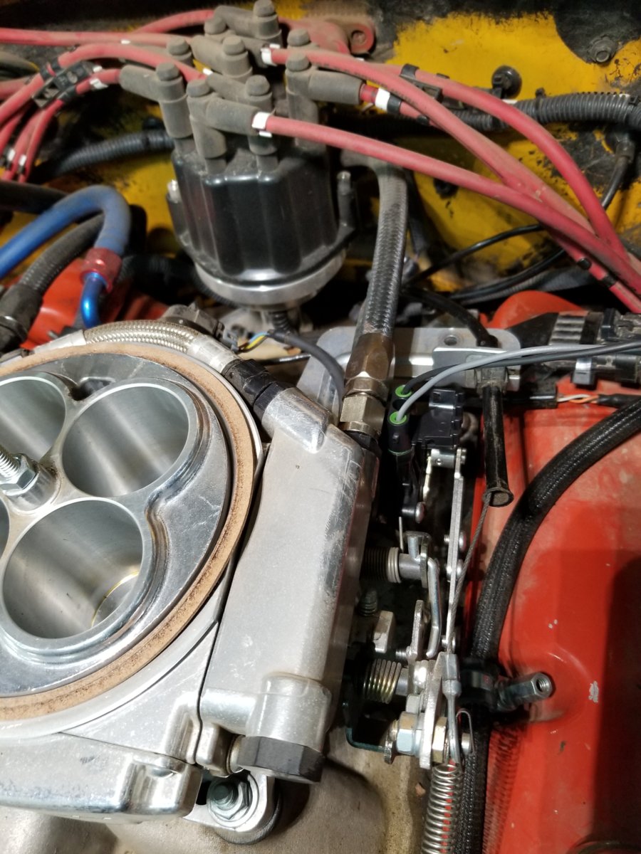

I also mounted up the TPS for the trans controller. I opted for the TPS that comes with a Compushift controller; I just thought it looks like a better setup than the others I see that use a cable and basically mimic the operation of a throttle valve cable on a 700r4. Plus it uses weatherpack connectors which I have so I can wire up the connector nice and neat.
Of course it wasn't all unicorns and rainbows. I had to lose the fuel pressure gauge so the sensor plug will fit.
full
full
I still need to finish wiring it up.
Several months ago I bought the pieces needed to mount a fuel pressure gauge in the cab. I haven't gotten around to installing it but now that I've lost the gauge I had on the throttle body, it's moved up the priority list. I'll mount the sender for the gauge down on the frame rail where the braided line meets the factory steel line.
I wired up the Acculink TPS. I'm posting this as much for future reference on my part as anything else.
The weather pack plugs have the terminals labeled with letters. In this case it is A B C.
The TPS is labeled the same. So it goes as follows:
A: ground
B: signal
C: +5V feed​
I have another weather pack plug under the dash and I made sure to use the same ABC order on that plug as well. I only wish I would have had the same color wires as what comes off the Quick4 controller.

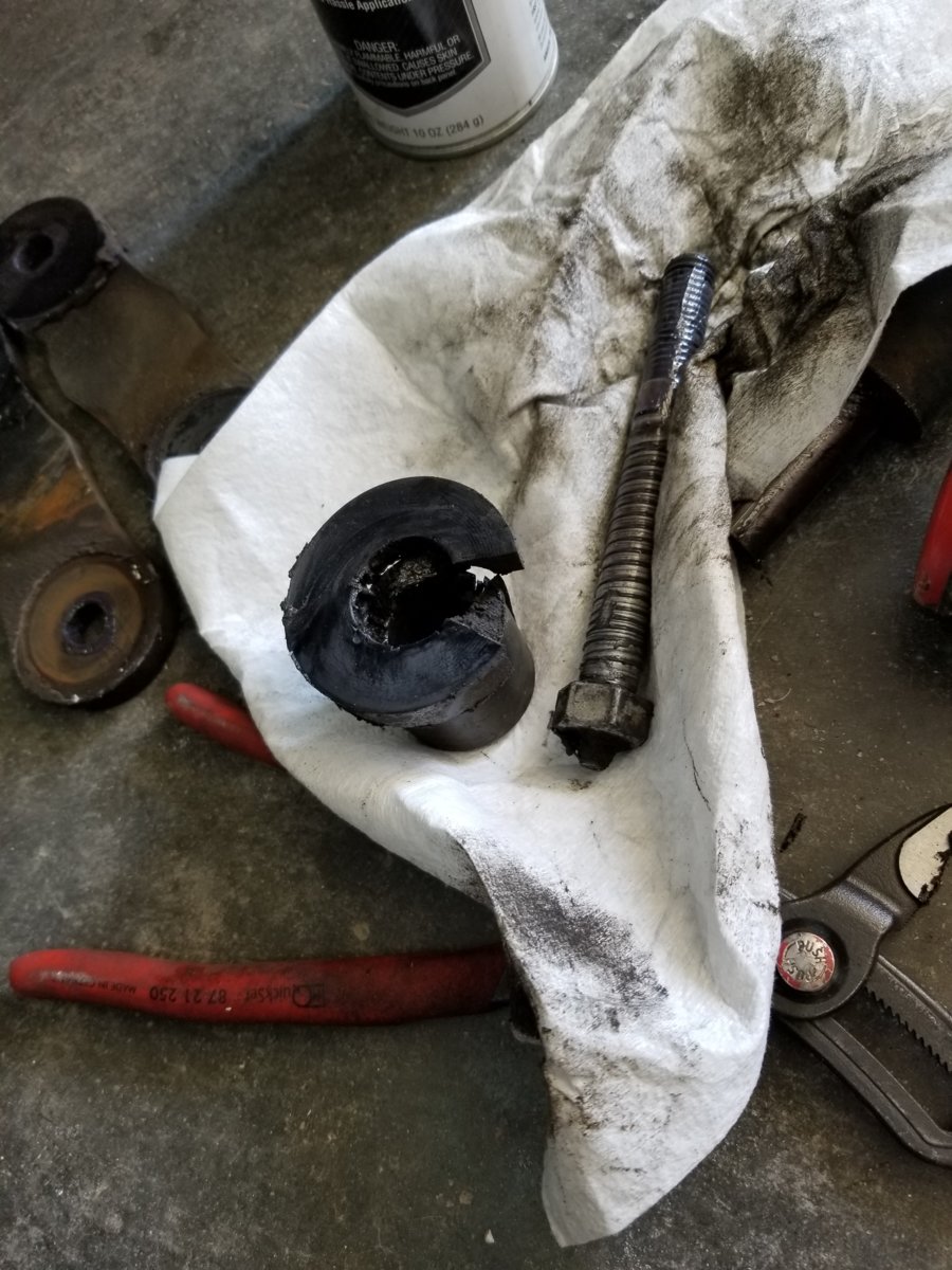

Before Blazer Bash I replaced the bushings in the rear of the front springs. I didn't replace the bushings in the frame bracket. Well I noticed the other day one of them had a torn up shoulder. So I replaced those today. This is what a bad bushing looks like (in case you didn't know)
full

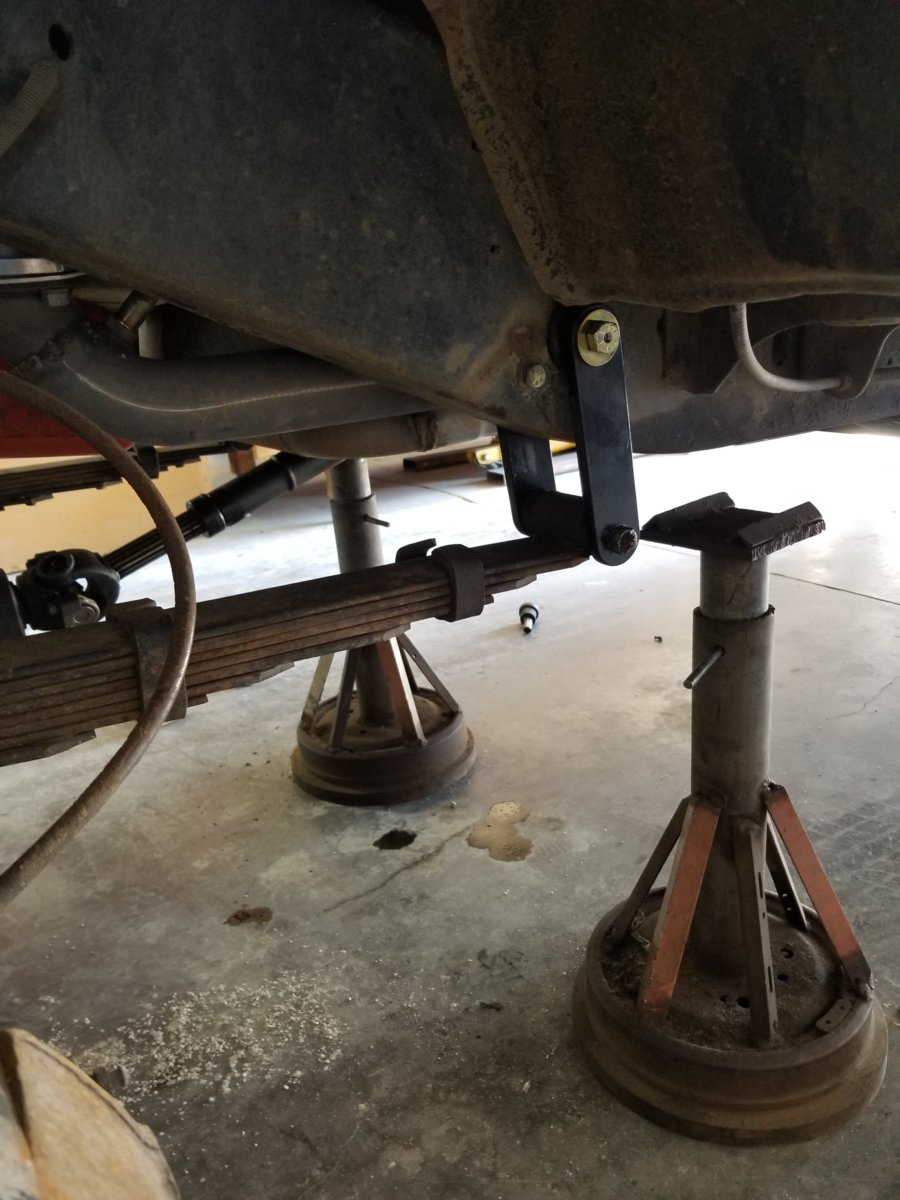

I also have a confession to make. A while back some commented on how close the spring eyes were to the frame.
Is it an optical allusion or are your spring eyes resting on the frame?
They do look crazy close if not.
Well I finally conceded they were too close. They weren't resting on the frame but they were about 1/4" away sitting in the shop. Apparently this is too close once you start articulating the suspension. I am thinking this is what was really wrecking the bushings.
I had started with 4.5" when I first did the 4wd conversion. Then I went to 5" which is where I was when the observations above were made. I thought about trying 5.5" but since the previous 1/2" jump didn't help I decided to go to 6". Well that made a BIG difference.
full
I had to double check the measurement because I thought they must be 7". But no, they are just 6". I've decided to just roll with it. It does put my caster angle at 9.5° which is a degree and a half more than recommended. Did some reading about caster angle and the only negative to more angle is increased steering effort but that's not an issue with the hydro-assist. So I'm going to try it and see what happens. I definitely won't be having the spring eyes hitting the frame. If it's no good on the road, I'll try 5.5"
