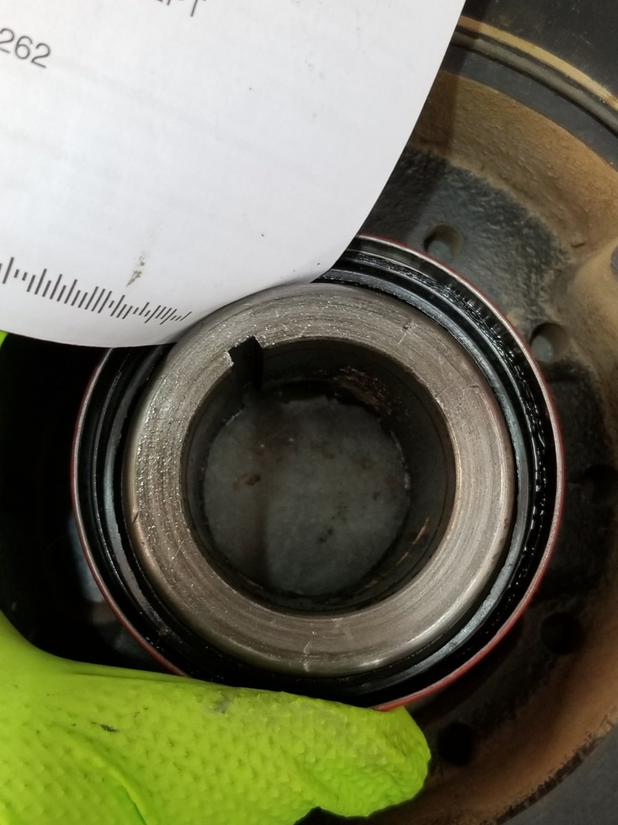

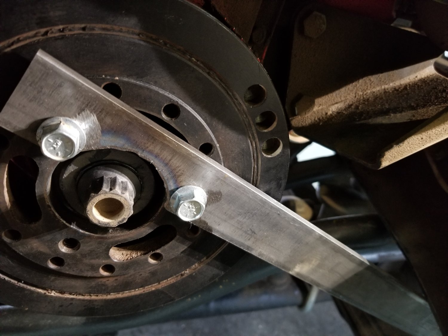

I found the source of my front seal leak.
full
It's cocked and just fell out as soon as I started to pry it. I had also read about another guy having trouble with a FelPro seal leaking. He found that if he slipped the seal over the balancer he could lightly push the seal and it would unseat on the opposite side. Mine was the same way.
full
That's a folded piece of thick paper that easily fit between the seal and balancer. I put this seal in new before I installed the engine in the truck. I couldn't do this with the new seal I installed today. I put a SCE viton seal in this time. It has a rubber coating over the entire seal with ribs around the outer perimeter so I'm thinking that should help keep it from popping out.
Obviously removing and installing the balancer was easier on the engine stand, but it wasn't horrible with a good puller/installer set. I was stumped for a bit trying to figure out how I was going to torque the balancer bolt. No room for an impact, and I would want to put a torque wrench on it regardless. So I made a tool, a spanner of sorts.

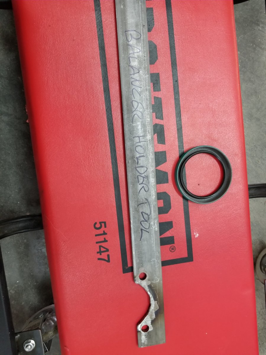

I labeled it so a year from now when I come across it again, I'll remember what the heck it's for.

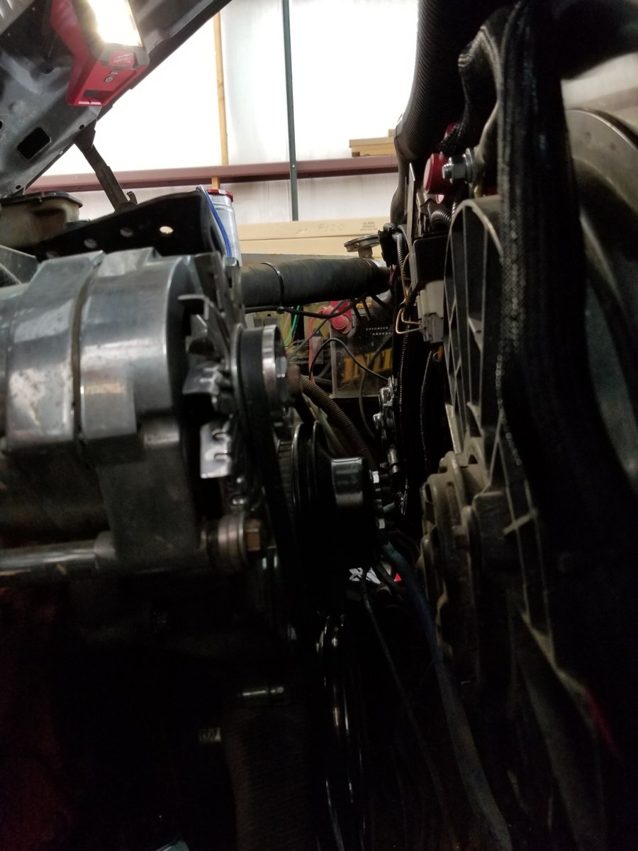

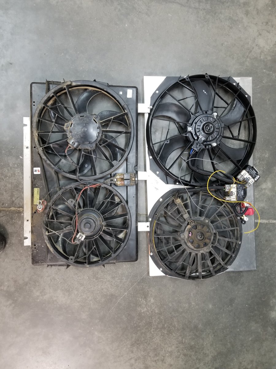

Since I needed to remove the fans to make more room to pull the balancer, I figured it was a good time to install the new pair. Here's a comparison:
full

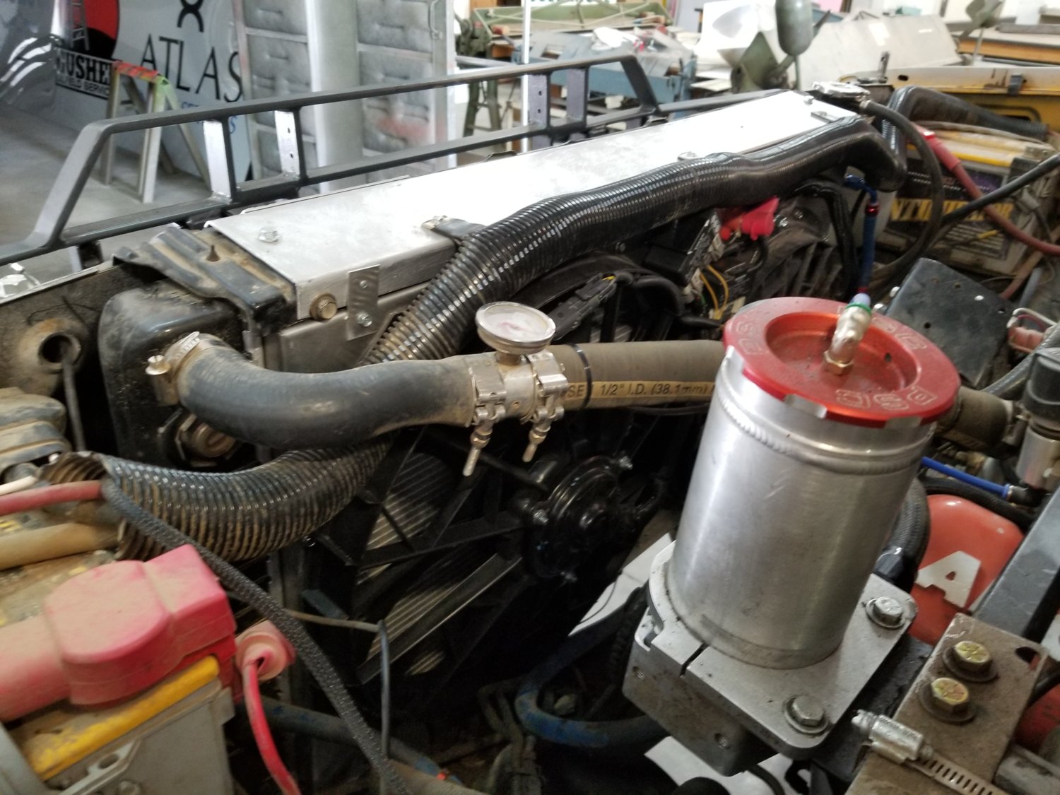

Here they are in the truck:
full
If you were putting just the Lincoln Mark VII fan in a truck with the standard width radiator, you may have trouble with water pump clearance on a 454.

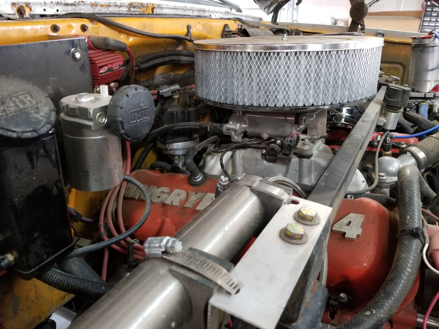

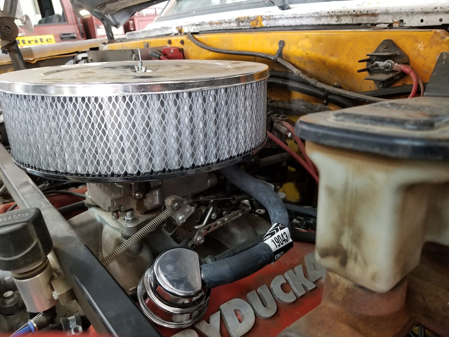

I also installed a new PCV valve that's for a mid 70's 454 and I put a different breather on.
full
full
The breather has filter media and baffling that's meant to capture any oil and drain it back into the valve cover. I thought this breather might work better for air flow with it being plumbed into the intake.

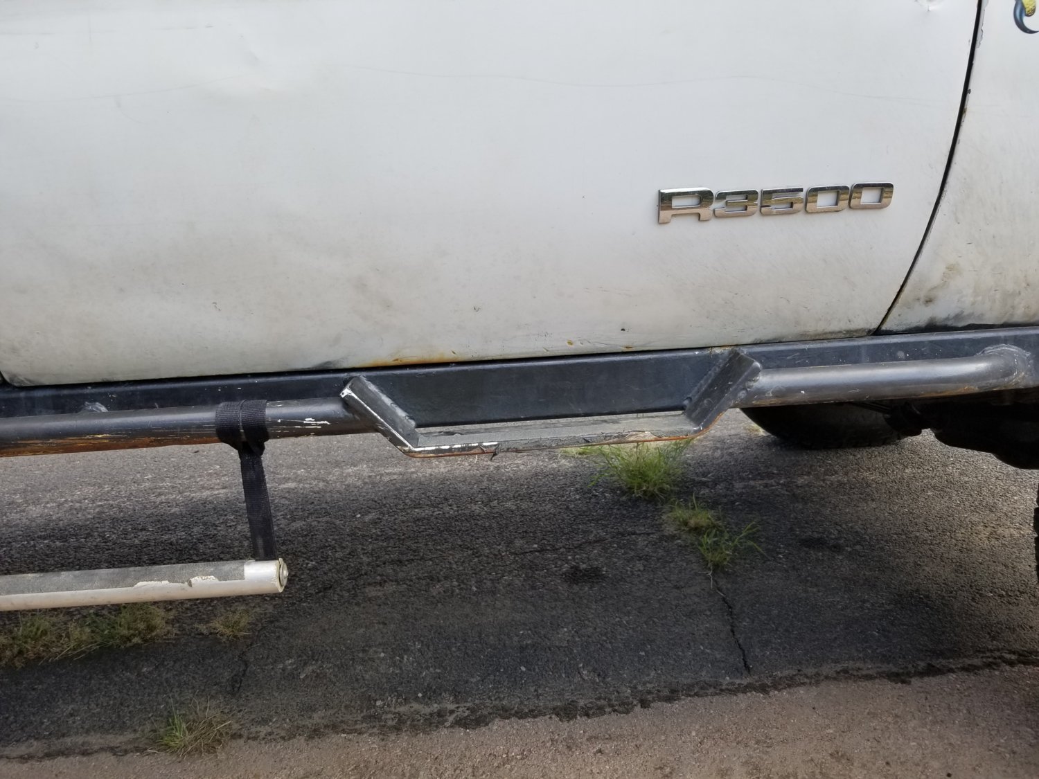

And I don't think I ever posted a picture of the door badge I made.
full
Those are leftovers from customer vehicles that had graphics packages requiring the badges to be removed.
