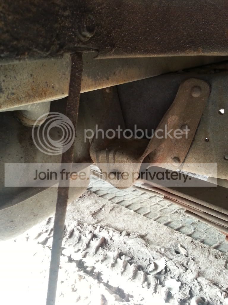

Pretty sure I'm going the 64" route. I only need to make sure I can clear the front hanger with the saddle tank. Ultimately I'm going to run a different tank, but for now I still need the saddle tank.

Be interesting to see if you can clear the saddle tanks on it or not. I am not sure if you can
As soon as someone else gets back to the office, I'm going out back to measure.

Here is a stupid thought...anyone ever notch the fuel tank so that the hangers can be moved forward??
I got 64`s that I would like to put on my truck,but got the same problem.
Yeah shortbox tanks but I`m cheap.:D
I think if you were really determined to do it, it might be more practical to move the tank further forward on the frame. I'm guessing that if the frame on a crew cab is 34" longer than a regular cab pickup and the gas tank is still that close to the spring hanger GM kept the tank the same distance from that hanger as opposed to the same distance from the motor. I'll bet there's room to move the tank 34" further forward.
