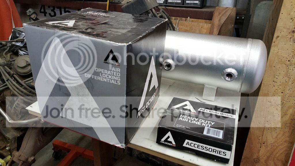

Got an exciting package from ORD today....
See Scott we posted instead of lurking.
Nice air locker!
Thanks you all! I'm excited to get this in the truck. It's for the Dana 60.
Now that we're doing more of the easier, scenic trails it'll be nice not to always have the front locked up.
