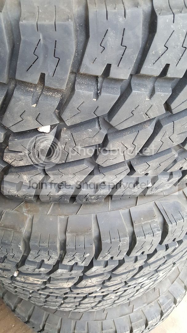

On another note I scored an awesome deals on 4 tires. 37" Nitto Terra Grapplers with about 1000 miles on them. Guy had them listed on craigslist for $900 which I thought was a good price but I didn't have the money what with the ARB install. Then a week later I see he dropped them to $600 and I had to figure out a way to come up with the money. Luckily the other buyers flaked so they were still available when I had the money together.
This is by far my best tire deal. New these would have been almost $1600.
Damn! Sweet deal! I want those tires on my '12. But obviously in a smaller size! Lol
We had Terra Grapplers on a Super Duty a few years ago and they seemed like good tires.
I'm thinking about finding another set of 17" wheels and mounting the new tires on them. Then swap out tires depending on what I'm going to be doing. At least do that until I figure out if I have the alignment issue fixed so I don't trash another pair of tires.
