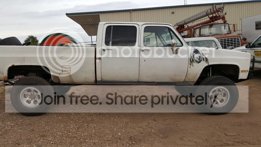

'89 R3500 Crew Cab 2wd to 4wd conversion & beyond
Started out with 2wd TBI350 with SM465 to current 4wd with 454, 700r4, NP241
