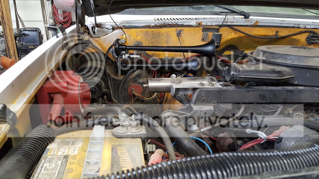

I got my horns mounted today. I also installed a new stereo in my company pickup so I didn't have time to get the air and electrical connected to the horns.

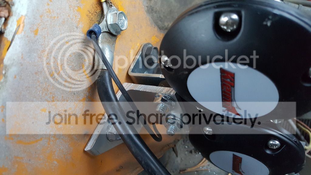

Would have liked to point them forward but didn't have a clean way to do it. This was really the cleanest spot I had. I did add a second bracket to the one included with the horns.
Without it the second bracket making a T, it was rocking quite a bit.
I will tee into the line that feeds the gauge in the cab for the air. I'll pull power from the battery with a push button switch on the ground leg.
Yeah, bet that's gonna suck
How's the motor work going?
No room on the outside of the radiator support?
No, I have a battery on each side plus coolant expansion tank on one side and air intake tube on the other.
That's where I've always seen them.
Or under the bed.
I did think some about that, just makes air and wiring a bit trickier.
Wife thinks it'll be loud either way so it won't make much difference where it's pointed. Course she's not thrilled with whole idea anyway. :haha:
