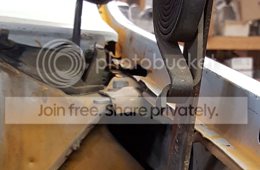

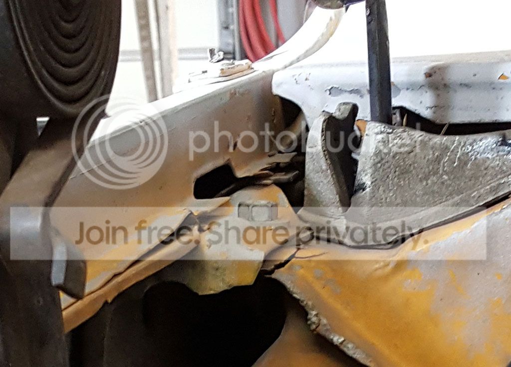

Found this lovely bit of damage today after investigating a pesky squeak that popped up on the drive home from Blazer Bash.
Gonna have to do some welding repair on that last one. Also wondering if I can weld the fender back together or if I should just get "new" fenders. Worried that the fenders will just tear again on the edge of the repair spot welds.
Try some extra bracing first
Nearly pristine OE driver side fender on my K5 is broken just like that. My smashed to hell fenders on my K20? Nope...
Nicole and I were discussing bracing ideas. It also occurred to me some of the problem might be with my sliders. I'm thinking I may need more gap between the sliders and the bottom of the fenders. I wonder if when the body is tweaked from suspension articulation, the sliders might be pushing up on the fenders putting more pressure on that mounting tab.
