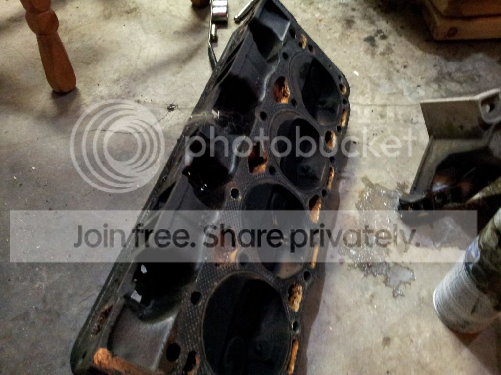

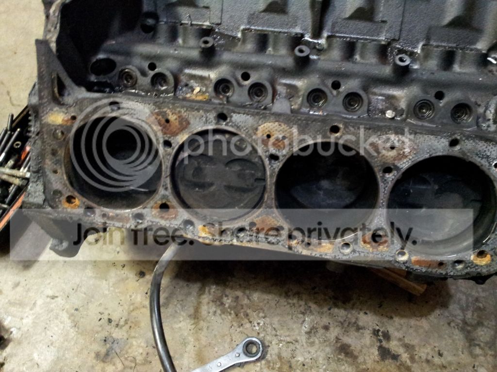

The 184k 350 is out! :eek1: Passenger side head gasket was shot, all the valves were intack. Pulled the heads and two of the pistons had some play, tomorrow I have to get some bolts for my engine stand so I can take a look at the bottom end.

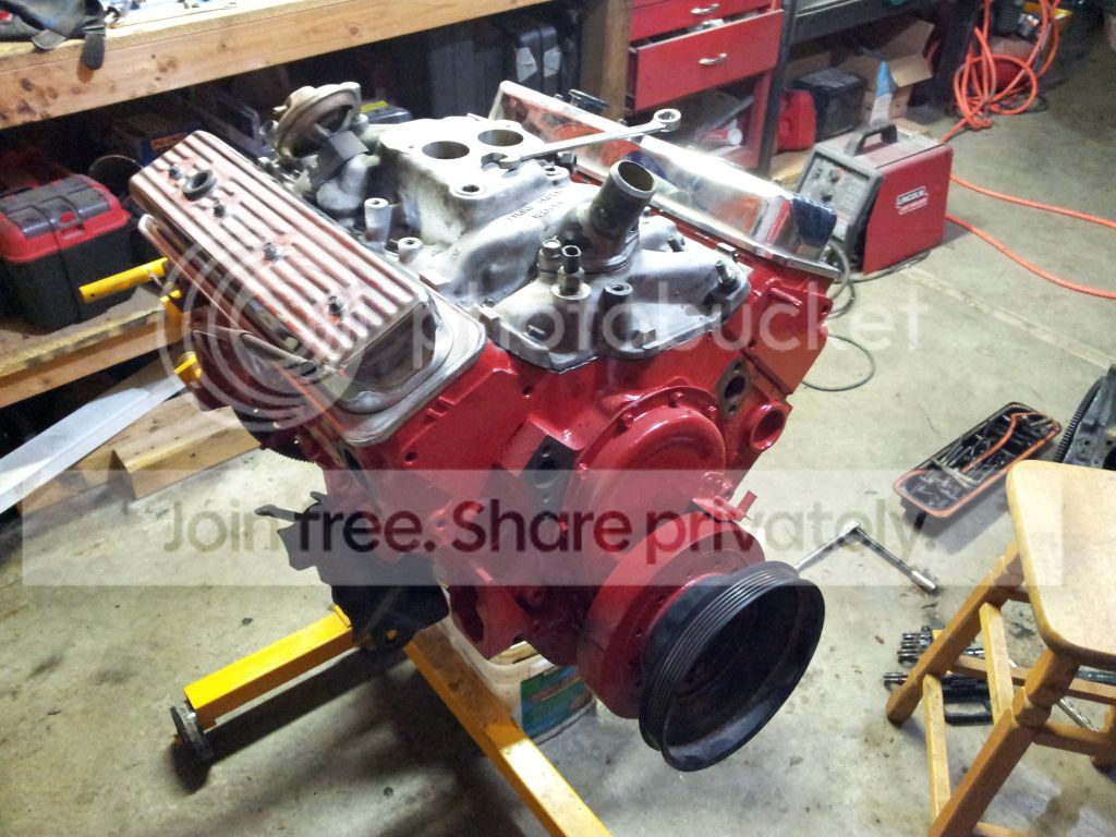

Next is to clean up the intake and other parts that are going on the new engine :thumb:
The new engine getting ready to go in. Got the intake all cleaned up and going to put the stock oil cooler on it.

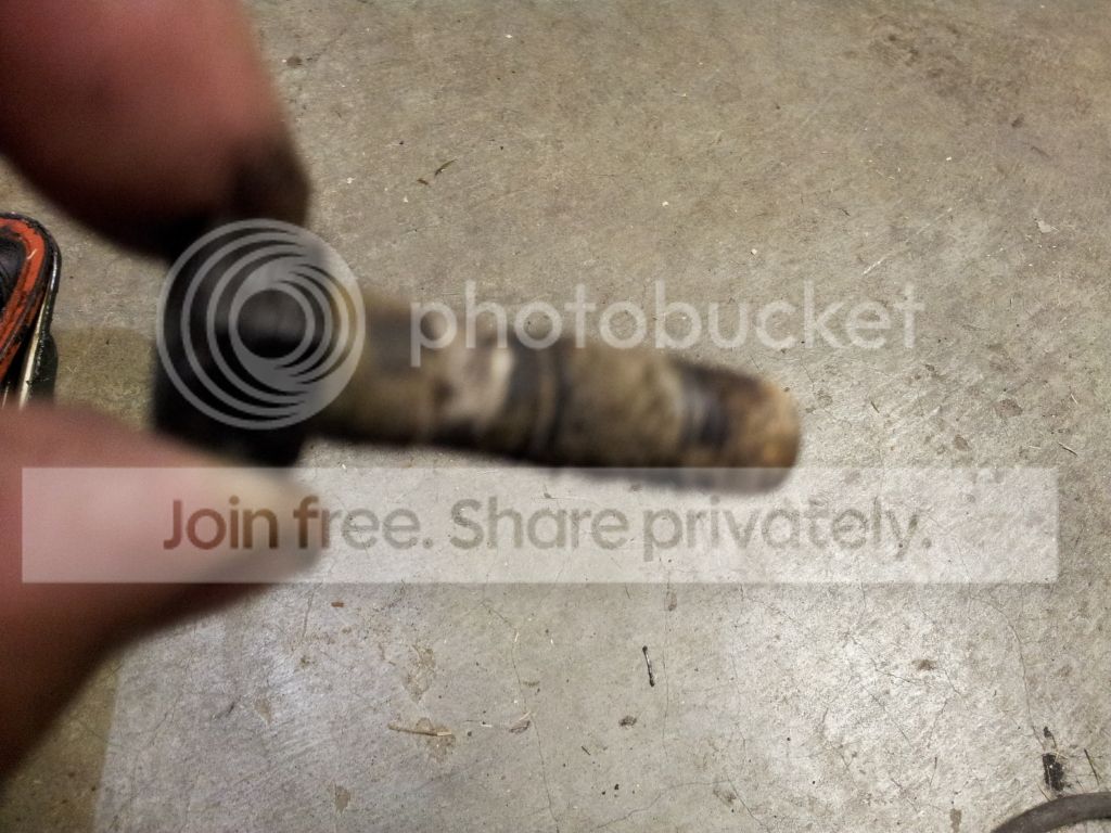

Couple of pics of the old engine and its flith... last pic is one of the head bolts
