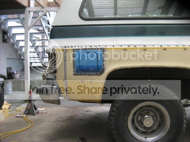

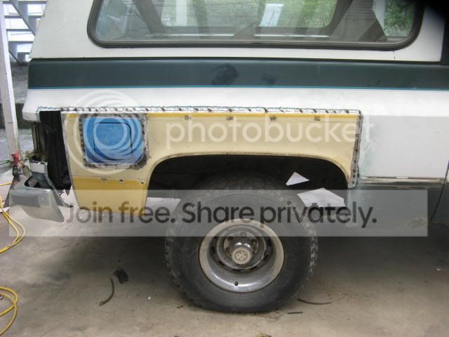

Started dealing with this ugliness yesterday...
Got the bad stuff cut out, cleaned up the inner stuff, and like the drivers side I had to graft the lower part of the inner wheelhouse. Wire wheeled it, a coat of primer and three coats of satin black. Should keep the rust at bay for a while...
Same basic idea as the driver's side...except I had to add a new gas door assembly. Also had to add a smaller section at the very rear which incorporated the tailight area.
Got the main piece hung and tacked somewhat...
Fuel filler bolted right up...
Last section clamped in place, you can see the area at the bottom that Russ mentioned. The angle is different on a K5 than an 8 foot box. Pretty easy fix really.
All fit up, just needs a bunch more full pen tack welds and finish work.
For the bottom, seeing as there is no crease or body line I was able to use some wide vise grips and roll the yellow part up and in. I started a few inches back from the rear wheel opening and just rolled it a little more and more as I went towards the rear. Then I finalized it by tacking the three pieces together. I think it turned out pretty close.
Hard to get a good money shot...but it's damn straight looking down the side of the truck.

Damn man, nice work.
Ever considered just cutting that bottom lip out? I know you're doing more of a restoration than a modification but after seeing how mine just holds dirt, snow, crap, and road salt down there I'm pretty sure I'm going to trim mine out after the rear wheel well and before the front wheel well. Doesn't do anything but "look right".
Thanks! ;)
Both areas are easy to rinse out, so I'll probably leave them alone. I will be looking at a inner mud/crap/salt deflector in front of the rear tire though. This is a common bad spot on K5's and is an asshole to fix (compared to hanging a partial box side)
Worse yet, it leads to the lower seat belt mount area rotting out.
Rene
I have thought about some kind of mud flap/deflector thingy. I was thinking maybe the thin plastic cutting board material...but how to mount it?

Of interest to you specifically. That whole structure on the backside of the fuel door area...must be Suburban specific. I ended up trimming it down to the bare minimum just like the messed up original looked like.
Rene
Rene
Odd, but maybe it's intended to support the fuel door area, since it's on a much larger panel on the burbs.:dunno: I would think a fairly small bracket would have been more than sufficient, but I don't work for GM.:rolleyes:
