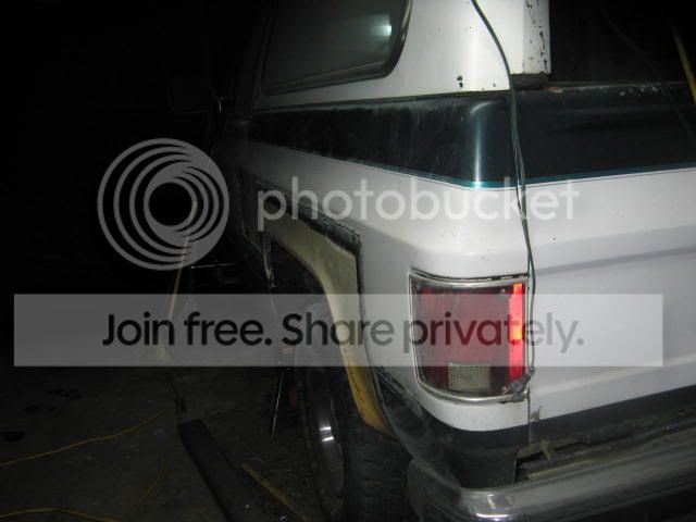

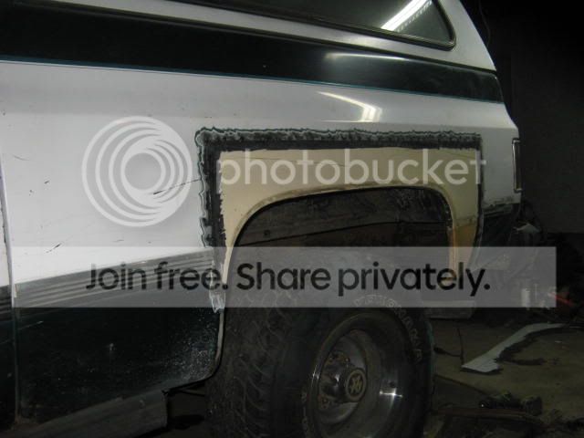

Well, with the big olympic party two blocks away I wasn't too worried about getting a noise complaint...so i hooked up a light and carried on for a while.
So far everything lines up near perfect. Gonna get it so i have a good full pen tack every 3/4" or so. The rest will be fill, prime and paint. Looking pretty straight still...

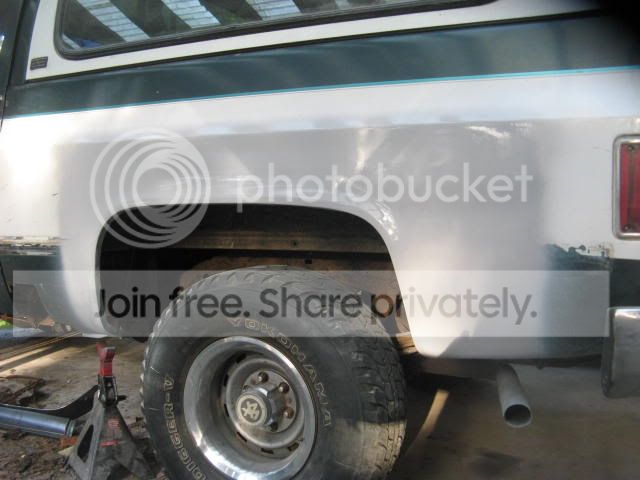

Money shot for this part of it anyways.
That's with the primer wet, and the sun reflecting on it. Still need a couple of spots taken care of, then final sanding. At least for now the worst is done and it has primer on it.
Primer dry.
Before, direct comparison. :)
Still have to do the box tube rockers, a little floor repair around the seat belt mounts and the other rear quarter. At least now I feel some more motivation to continue. I probably have no more than 7 or 8 hours into this side. The passenger side has some dents to deal with too though...should still work out.

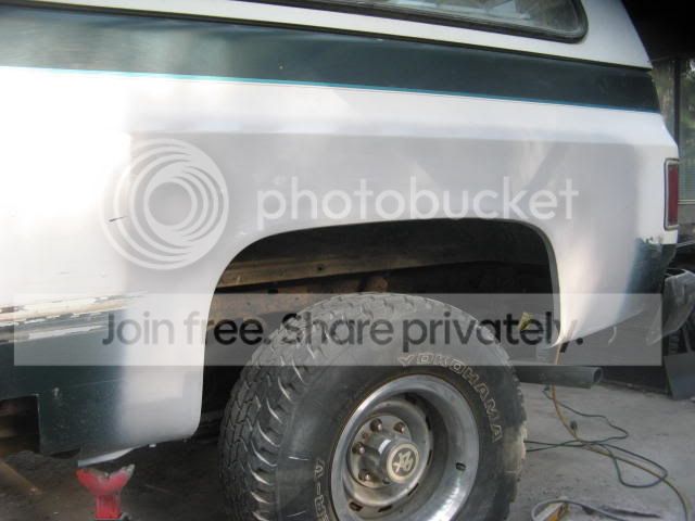

I like my flexible board sander for the long flattish areas. Keeps the waves to a minimum. I do have a few spots that need a little more work, but overall I'm pretty happy with it at this point.

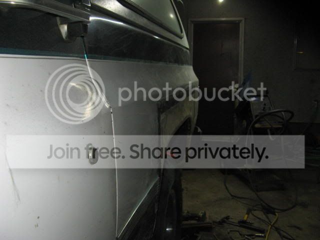

This side will be tougher for sure.
The fuel door isn't so sexy and I don't have a clean straight spare. The crease in the body line at the rear I think I'm just going to cut out. That'll be a lot easier than using a hammer and dolly.

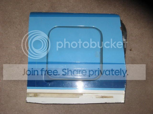

I have a complete boxside for donor stuff for that side too...plus this just arrived thanks to Throttleissues..
Working on house stuff this weekend though, so I'll probably get a start on the passenger side next weekend. Still deciding whether or not to make my own patch panels for the floor, or take a chance on the off shore stuff LMC and the like sell. I'm leaning towards making my own stuff...I do have a surplus of good oem sheet metal here.
