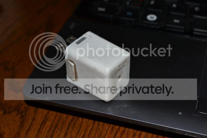

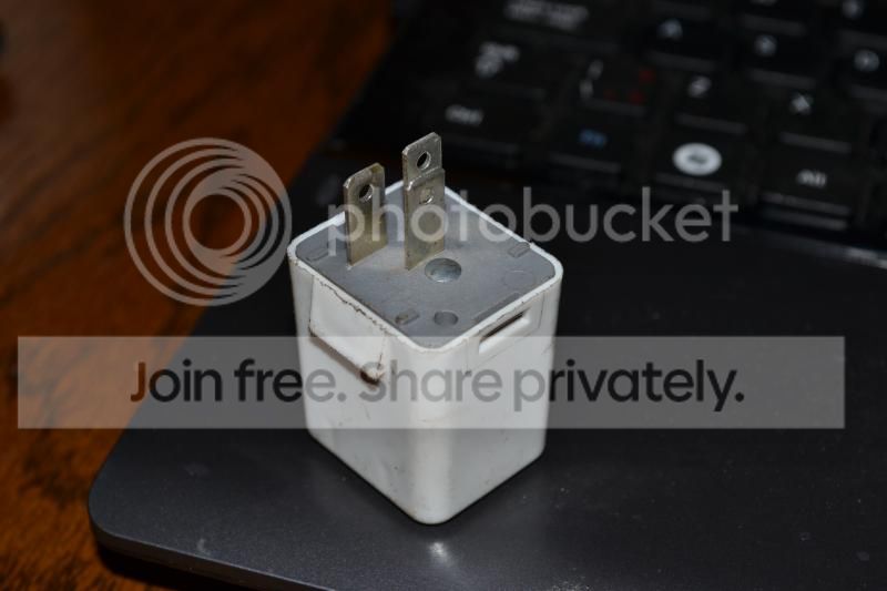

Trying to re-connect all we unplugged looking for the key off draw. I think I got most of it, but found this on the floor...and can't seem to see where it goes.
Anyone know?
Doesn't appear so, and has tabs on the side like it goes into a plug with a couple of grip tabs on it...:dunno:

Seems like there's another little fuse block way up under the dash by the steering column. I think it has the relay for the turn signal and some other stuff. It could be for the windshield wipers or something.
Or that could be on another truck. I'll remember later.
That is your horn relay. Like mentioned above it is on the small auxiliary relay block on the side of the steering column down under the dash.

It may be one that just fell out a while back and has already been replaced. I would bet that it's for something in the cab since it's from a fuse block under the dash.
My wife's Jeep has a loose socket for the wiper relay and the relay falls out and appears on the floor board from time to time.

The little white cube is the horn relay (thanks for chiming in Russ) and plugs into a block near the steering column.
