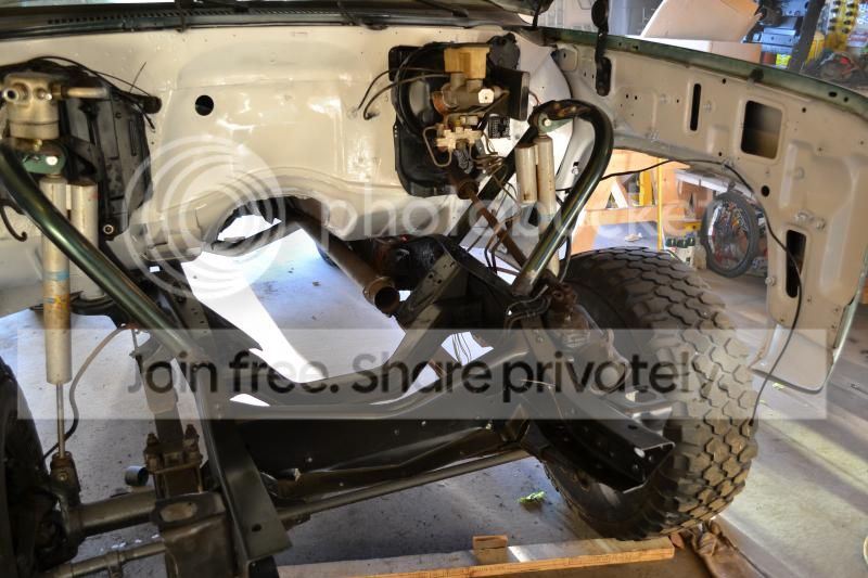

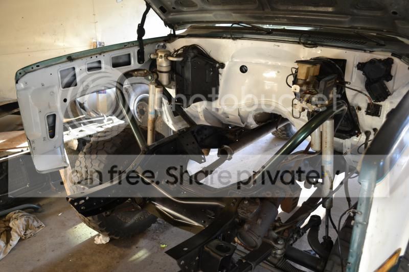

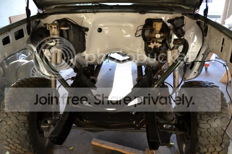

So, update is that the engine is now out, and running really well in someone else's Jeep. I figured before throwing the 5.3 in I'd do some cleaning and painting. So I got a few pics of the engine bay now. Not what I call show quality, but looks tidy enough.
Next up is cleaning up the 5.3 a little and physically get it into the truck. Russel is gonna help me with the wiring.
