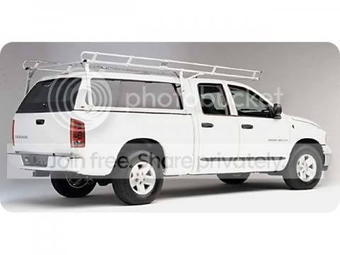

Roof rack thoughts....
A friend of mine modified a pickup ladder rack that actually boted to the top of the bedrails to fit his K5 once to move some long things. He basically shortened it to fit the blazer. However this was a temp thing and was during the summer and he ran topless. I had wondered at the time if a guy could widen it to fit over the topper.
Another idea by the same friend was a light bar that actually pinched between the cab and the topper. I cant give the details because I didnt see it appart but it was basically a plate that he tied into the bolts that go into the cab across the top he then contoured a pipe to edge the plate that protruded from the top and added light tabs to the pipe.
So the idea is to basically build a frame that matched the top contact to the cab with a sort of exo-cage so that the top could slide into it.
Im just kinda thinking out loud here but maybe it gives ya some ideas.
simular to this but with your skills and artistic ability I think you could make it look better
Nice work Colby, the new truck is looking GREAT!
I think he might be trying to support it off the side of the bedrails maybe, between the topper and the bed rail. Put the weight to there instead of the fiberglass.

Regarding the lumber rack, it's going to be awfully hard for me to describe, so you'll just have to watch what's up over the next month. :)
