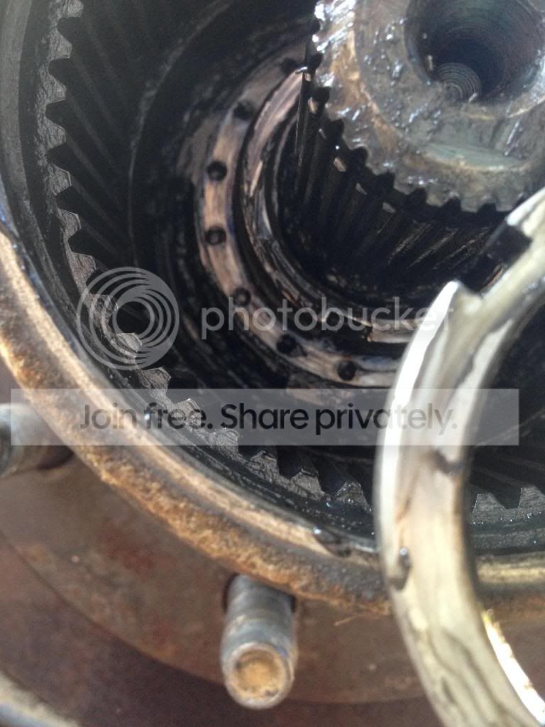

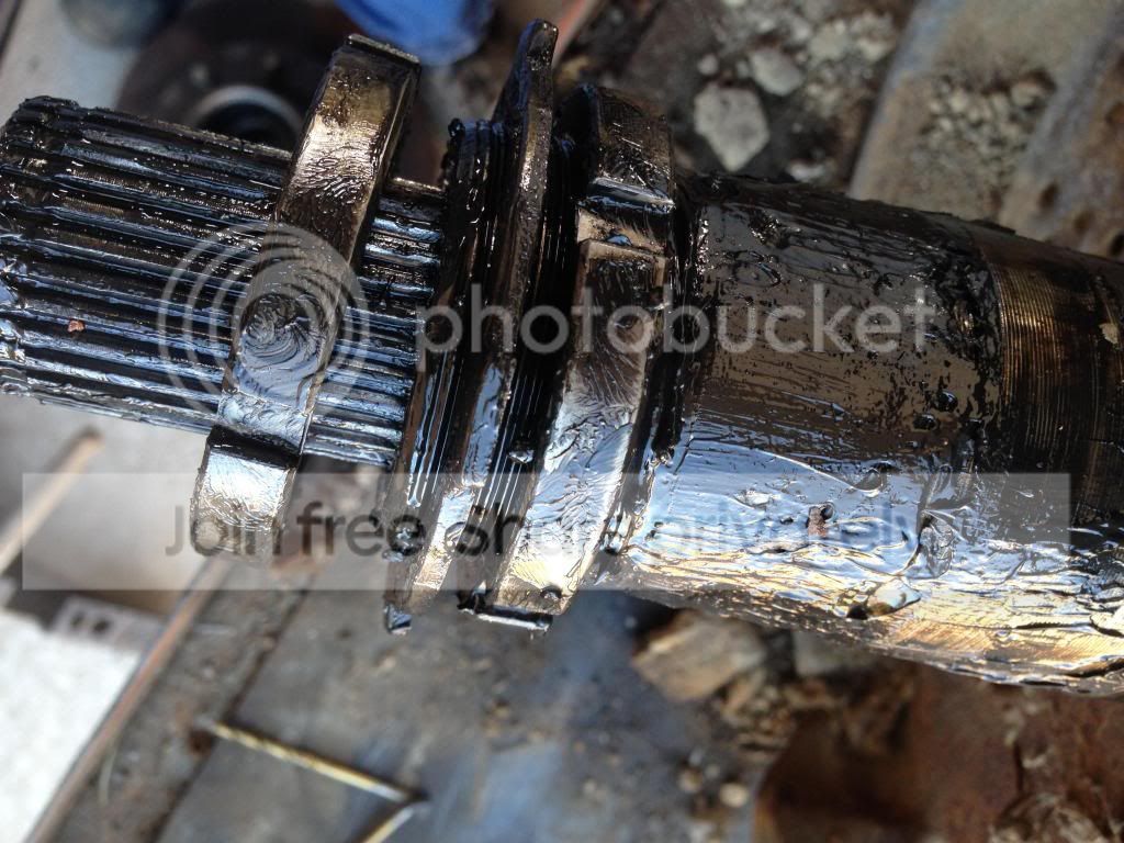

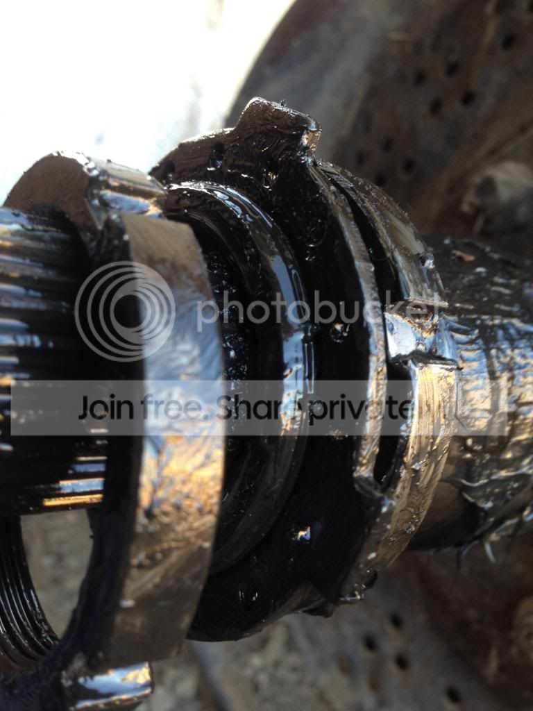

Dude this was too easy. I wanted to use the 'proper tools' but I resorted to the punch and hammer. No problemo Thanks y'all:waytogo: I still want the right tool to set the right torque I'm thinking. Anyone know what the little pin on the first collar is supposed to do? I see what it does but it makes no sense yet.
You torque the rear nut down. And the pin lines up with a hole in the washer, which doesn't allow the nut to back off.

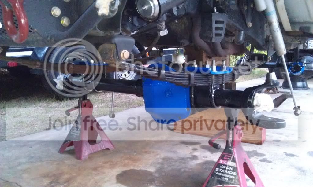

Converting an old score 8s k5 to 4wd with Artec three link and pan hard kit. Full truss and all. Needs to be a pass drop to match the doubler I scored for this :)
