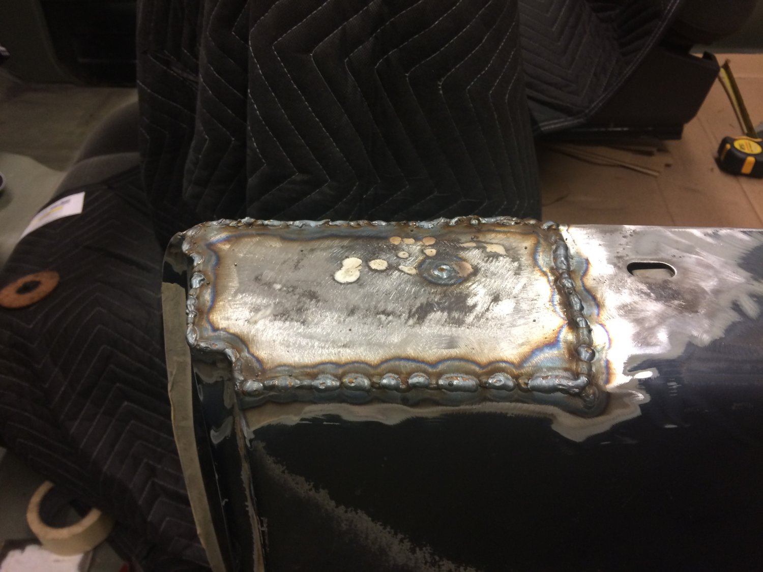

You may have already seen some of these pics from my welding questions thread in the Garage. Here are some pic of the top chop related windshield frame welding and B pillar patching. I'm still slowly getting everything stuck together, grinding and rewelding the pinholes etc. I'm hoping next weekend to finally finish it, get it bondo'd and primed so I can move on to bigger stuff.

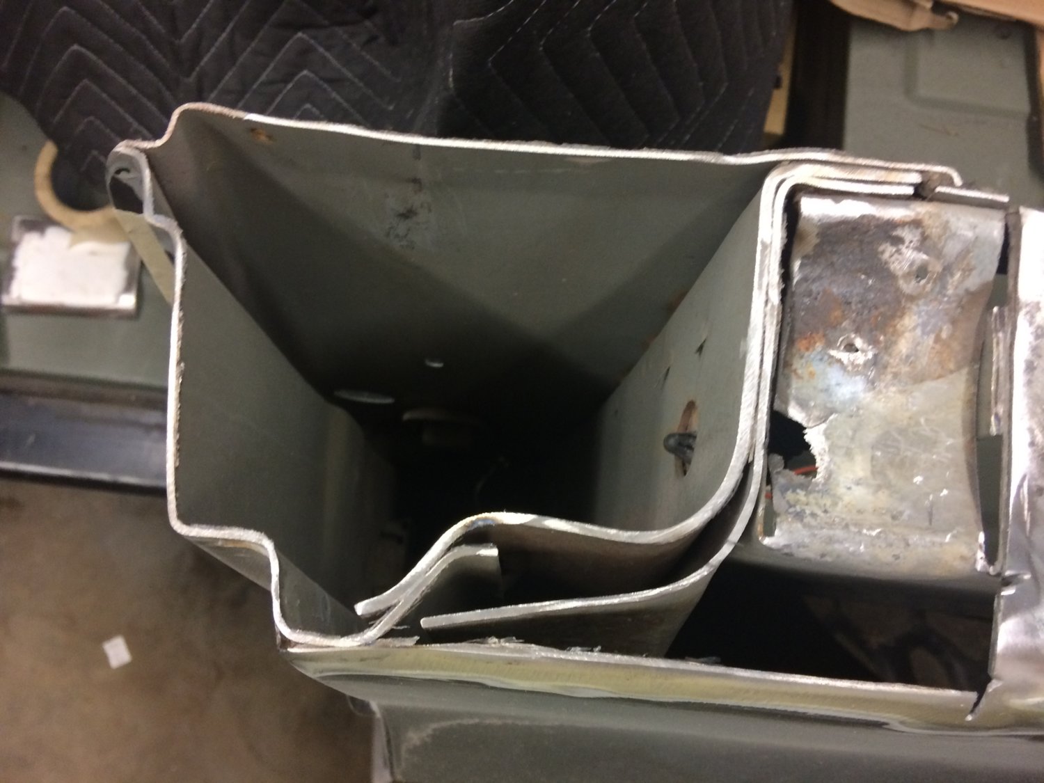

The inside of the B pillar, I assume the multiple layers are the "internal cage" GM referenced with the half top Blazers.
Same spot with a patch partially welded in.

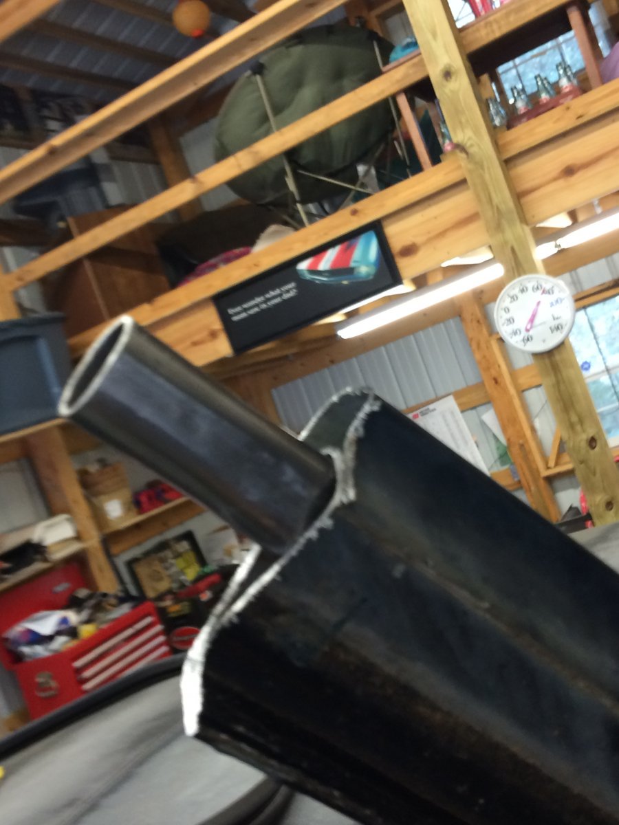

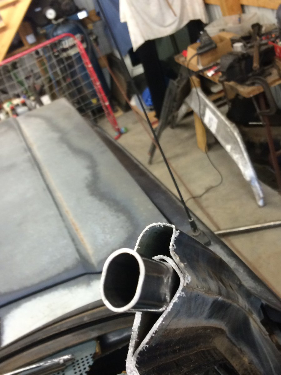

An alignment dowel made from 1" tubing for the windshield frame (old repeat since Photobucket killed everything)
Same

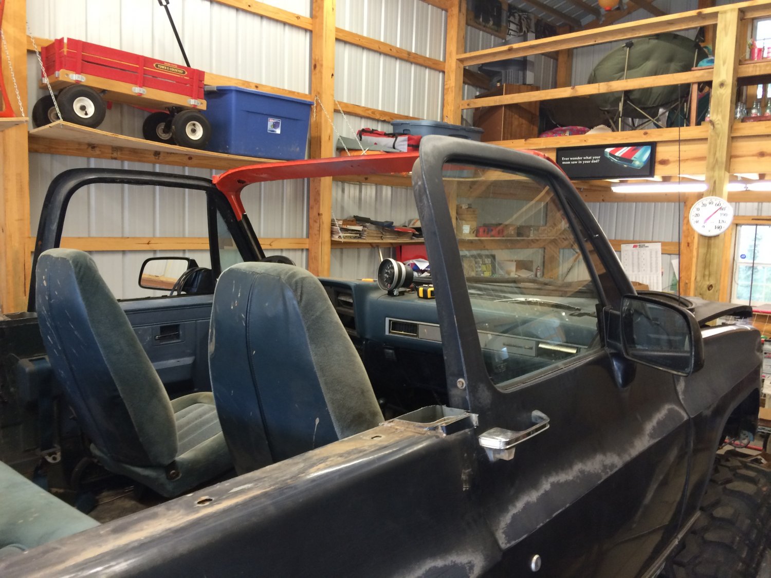

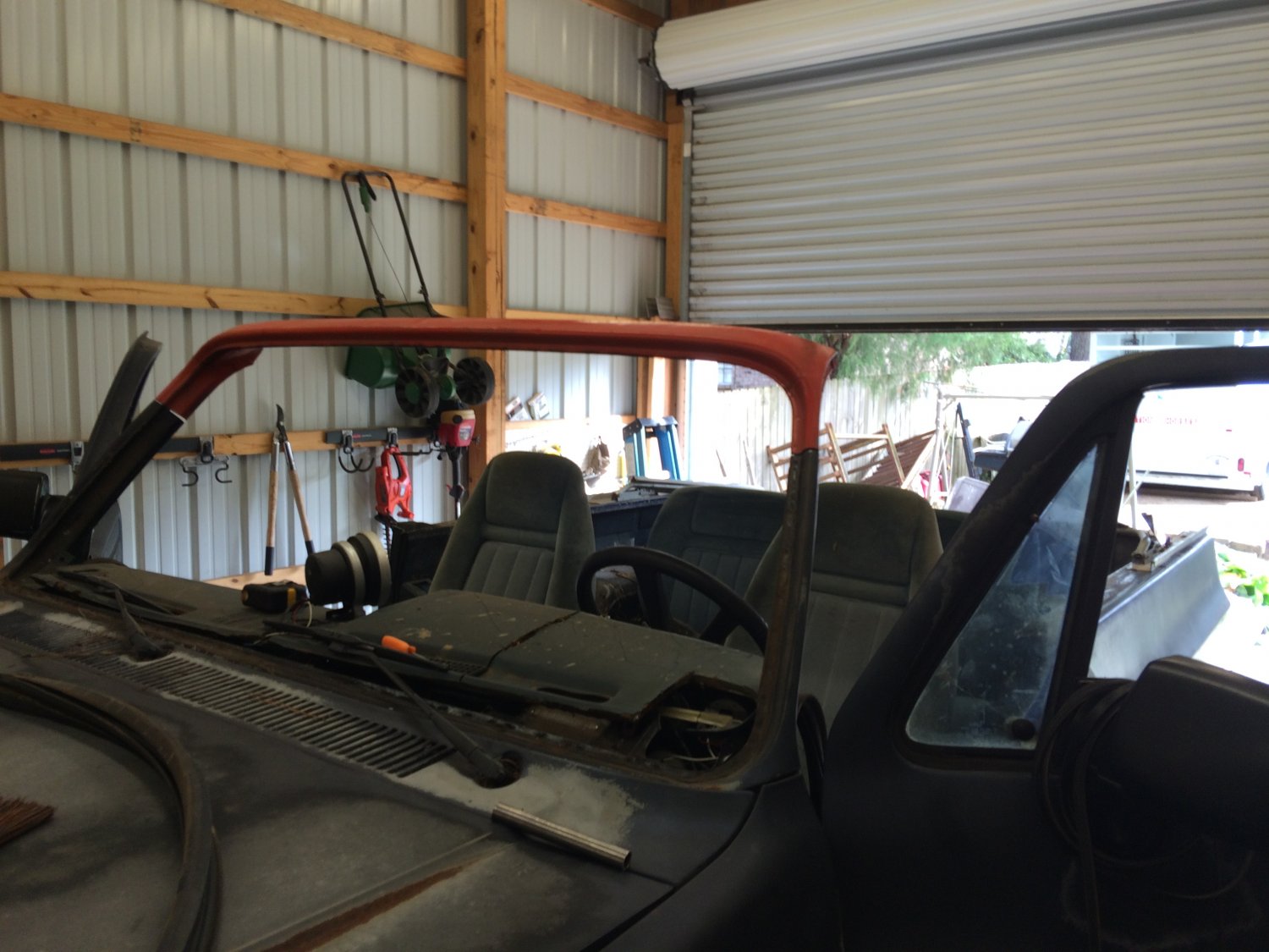

I used the doors to help align the windshield frame for welding
'75 windshield frame
