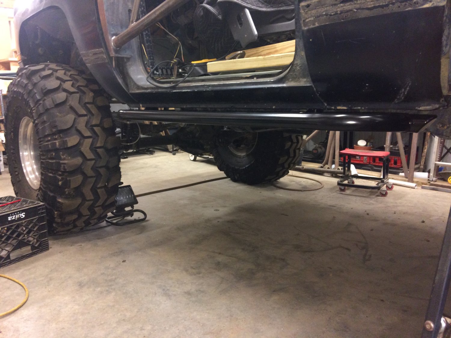

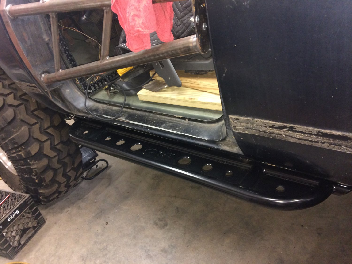

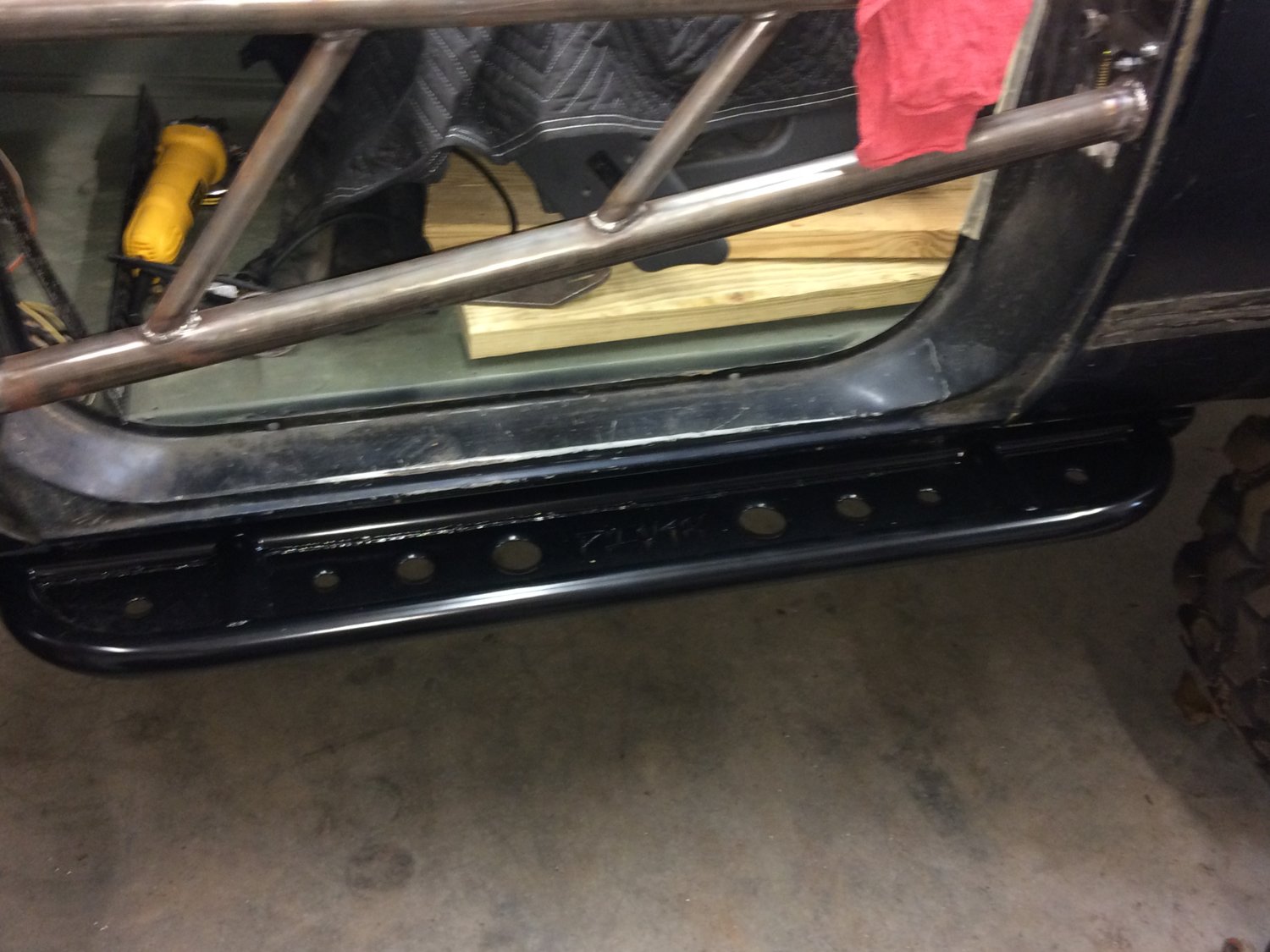

Not a lot to report but I did mess with it for a couple of hours yesterday. I threw some bondo on the B pillar patches and decided to mock up the Diy4x sliders. What you see just has bolts stuck in the mounts, they're not permanently bolted on yet since I'll be taking them back off to paint the truck.
