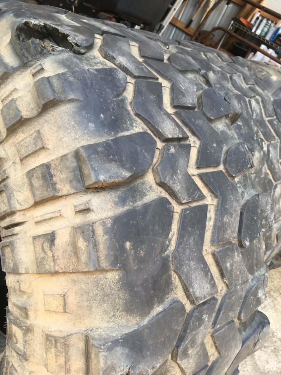

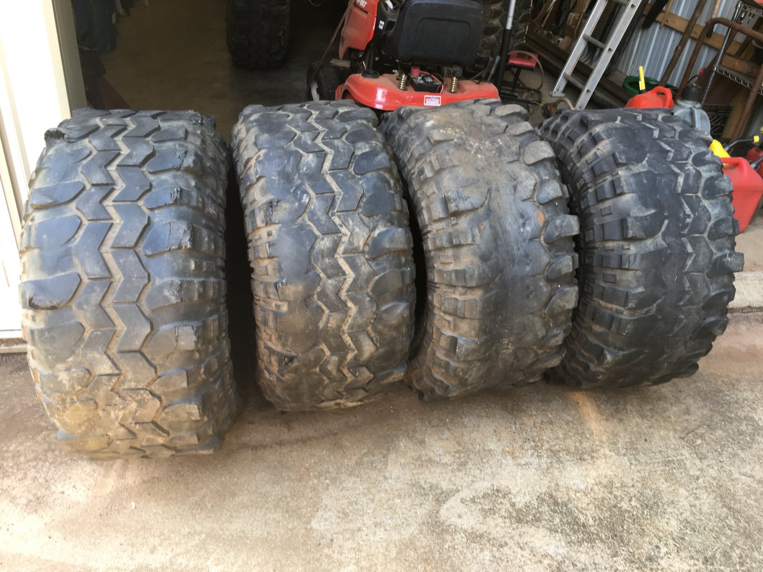

My morning FB score, $50 for the set.
full
They are all either chunked up or bald or chunked up AND bald lol but 1 is good enough for a matching spare.
