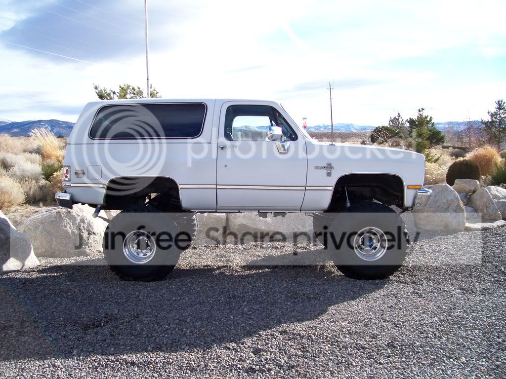

For comparison's sake here's mine. Stock height 52's & b-52s all the way forward. shackle mount moved forward. It's weird, it actually looks like my truck is sitting taller.
ryan yours does look taller and his angle is steeper so his would be a little shorter once he gets the angle fixed....that doesnt make any sense

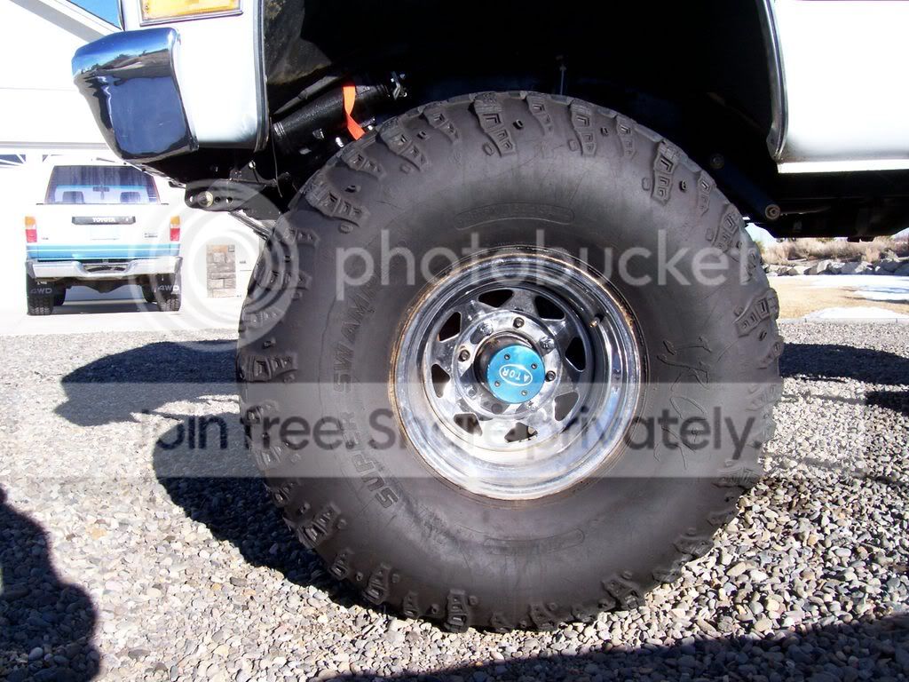

Your looks similar to mine before I cut the fender fang off, I could barely pass my hand (flat on the tire) between the fender and tire.

hmm.. dont mean to jack your thread with a bunch of my pics, but here is mine, w/ a 40" irok, and like i said, i have the b-52's mounted in the most forward position, with the springs in the 3 most forward hole. Maybe its just looks farther forward cuz cuz you're running 42's, and its causing an optical illusion for me..lol
i redrilled my perches 1" so my axle is about 3.5" forward. im trying to get my axle as far forward as possible so the 42's wont fight with my firewall

Cory I certainly don't mind the extra pics, we need them to help get a better idea of what all these combos will produce. It's amazing the differences in these trucks even with similar set ups. :doah:
