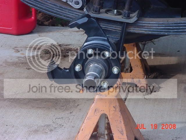

Been real busy lately but finally took some time to work on the rear brakes. Until now, I had not totally assembled everything so there was a little fear of everything working together. Today was the day, it's all together!!
To review; the axle is a D70HD w/ 5.86's and a spool. I had a new flange welded on that will accept a front D60 caliper bracket. The rotors and calipers are also from a front D60. I had to redrill the stud holes in the rotors for the OE 70HD wheel studs. I have Moser axles to go in it but because of the spool it's difficult to move so they wont go in until it's ready to crank.
Looks good, John. Will the H1's clear over those calipers and mounts?
Who made the u-bolt plates?
Yeah, I had the H1's & 42's on it a few months ago but I haven't had the new tires on it yet. I still have a LOT of trimming to do before they'll fit.
The u-bolt plates were made by Blue Torch Fab, I got them before Kert started making his.
