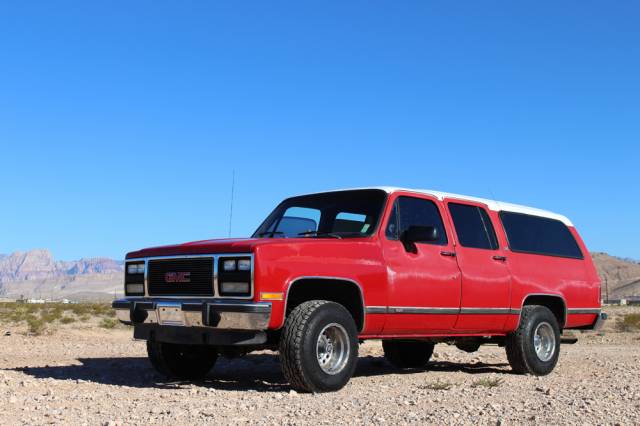

Just picked this up, shout out to muddysub's thread for pushing past the idea of owning one of these to going out and getting one!
Immediate plans:
- Fix Windows (Drivers side does not move, the rest get about 3/4 down)
- Upgrade AC (It's too hot round these parts to not have great air)
- Replace seals (Window, Door etc)
- Paint (No matter what color we go with, he will always be Clifford)
Future plans:
- Powerplant swap (thinking 8.1L)
- Transmission swap (would like 5 speed manny)
- Replace most if not all suspension parts (dana 60 etc?)
Side note, this is my first domestic vehicle.

Thanks! When I was looking at this, I thought the guy selling it was saying there is the rear heat as in it still needs to be installed somewhere! Nope, thats how it was made.
Got the front drivers side window motor replaced over the weekend, it was over 100 degrees outside so I was in no rush to get her done. If you are replacing your power window motor it is a very easy task, getting the regulator out can be tricky. Just take your time and wiggle it out!
Next up is AC + trying to find out why the stereo will not work, There is an issue with the wiring as it stands now. The speaker wires are intact with the stock harness however the power wires have been hacked at some point during Clifford's 25 year life.
