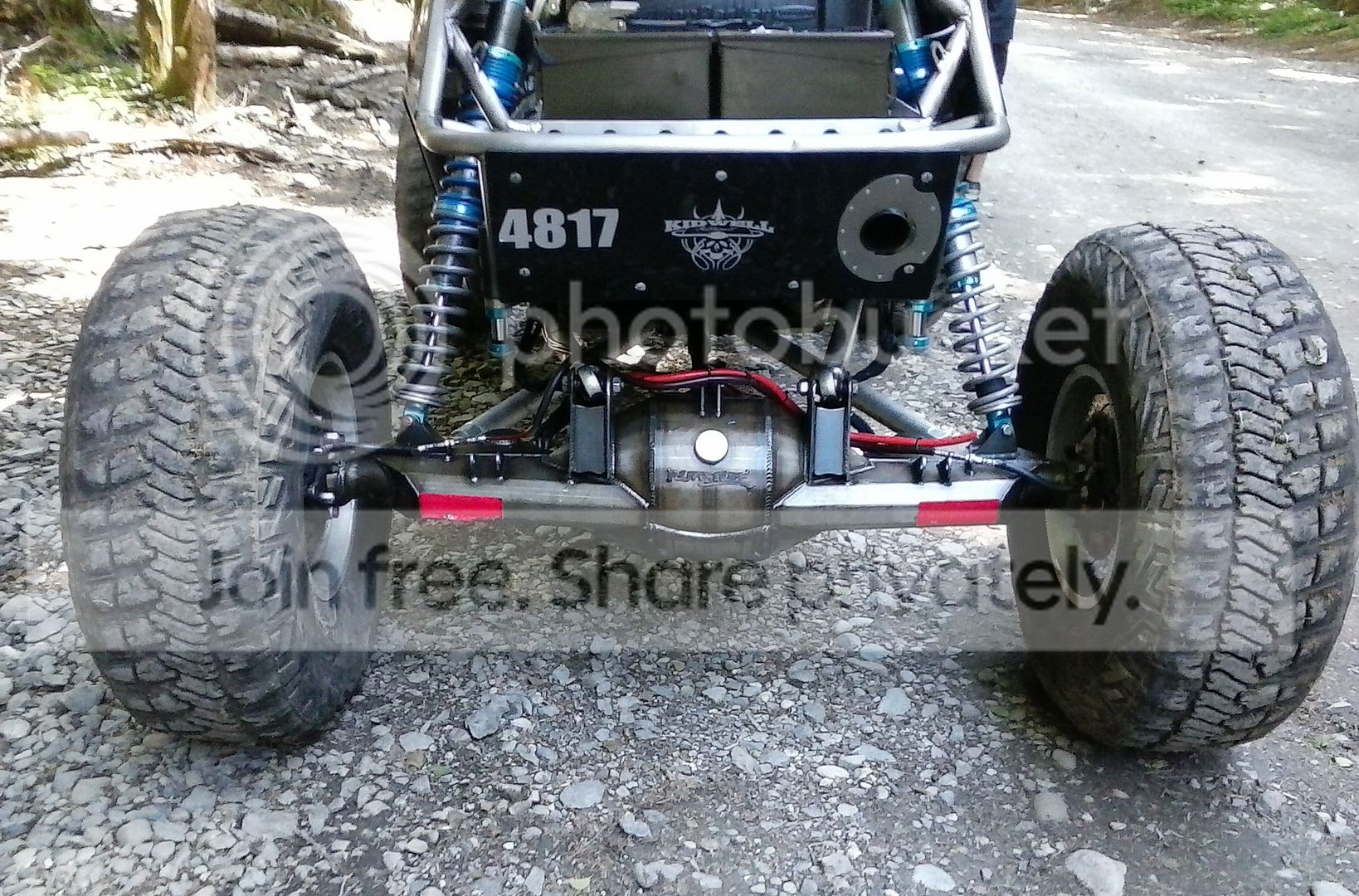

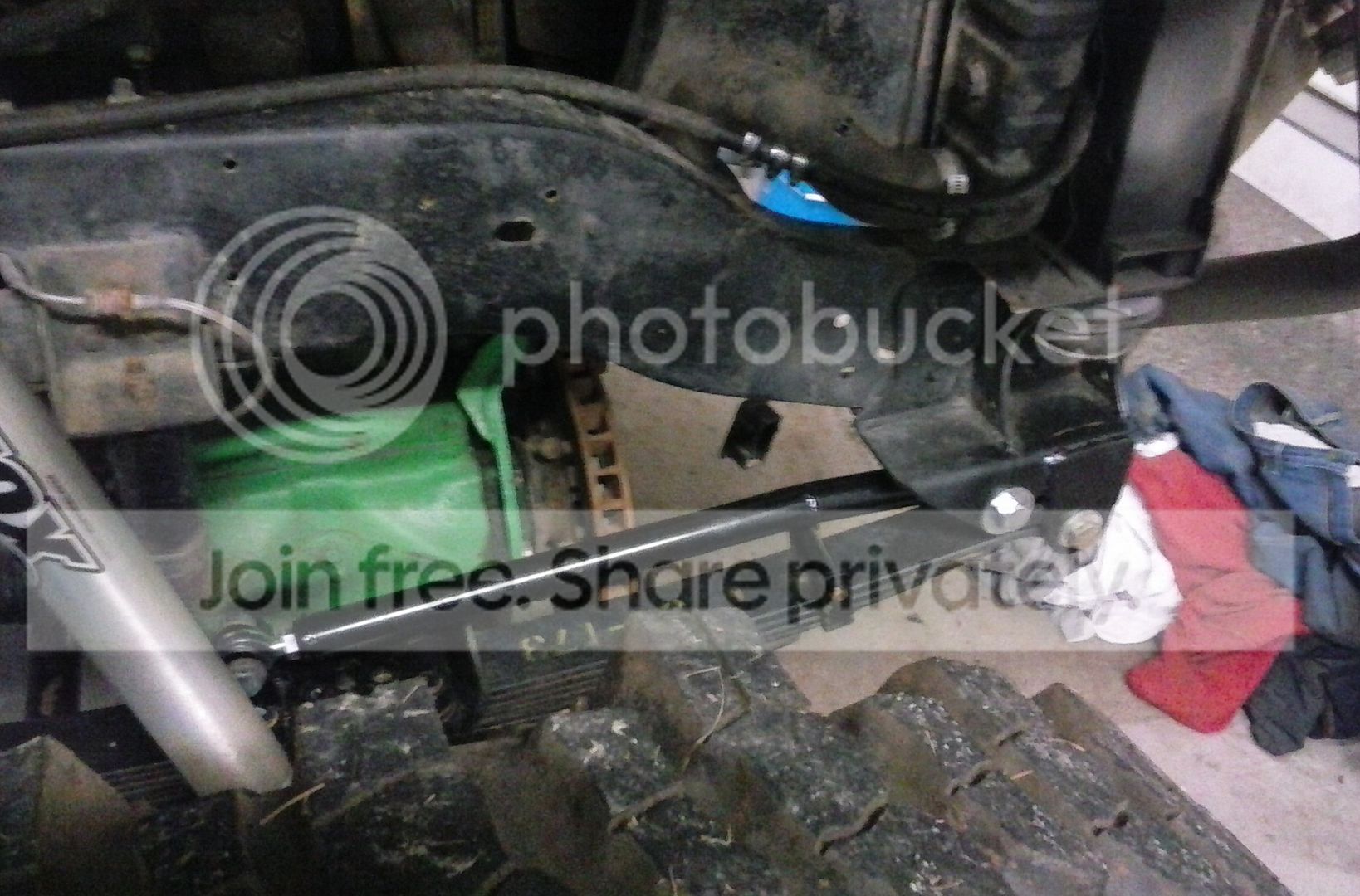

Okay so to finish off the front wrap bar build I did the passenger side as well. The front heim has a 5/8" bolt that goes all the way through the b52 bracket. To keep the heim from walking left to right the bolt is sleeved on each side. I also cut a slit and welded up the tube so it has a slight bend. It doesn't spin around so long as the nuts on the heims are tightened down.

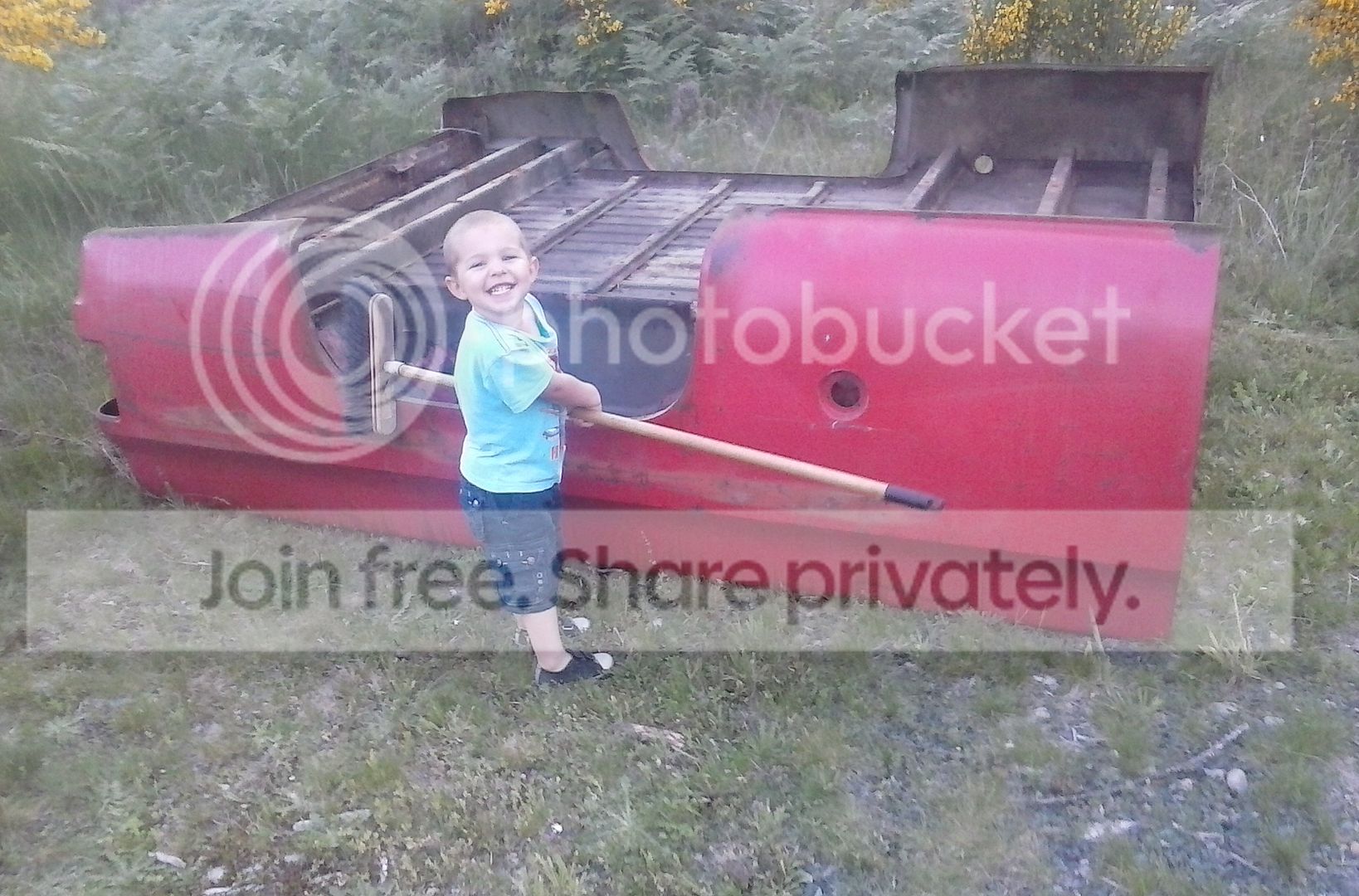

I also picked up a long bed so I can start the process of skinning the rear of this thing to make it look like a chevy again. And that is my middle child, trying to help, but slowing me down.

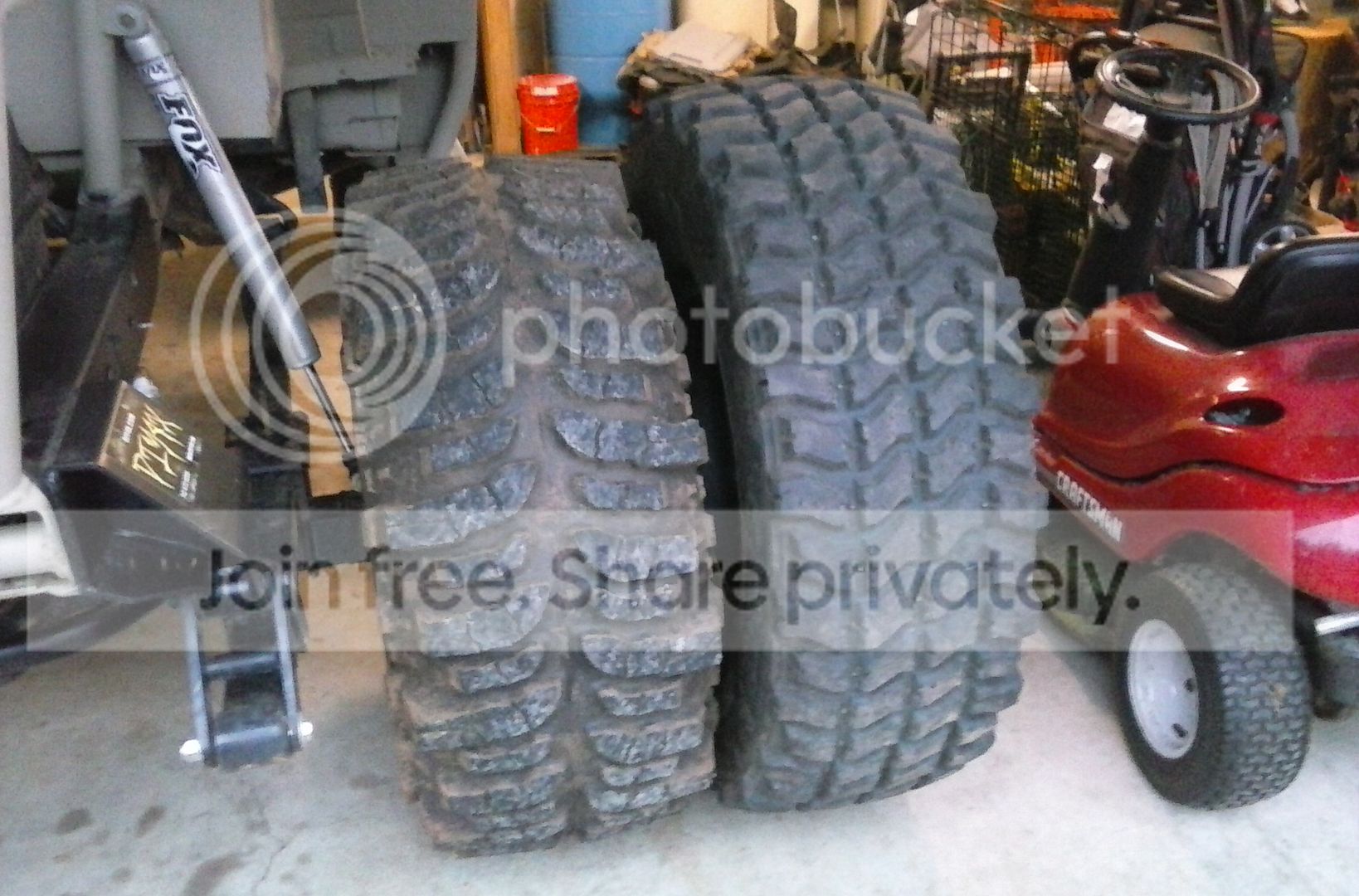

And I picked up some 46" Godyear mvt's in pretty good shape for a decent price off craigslist. Here is a pic for those of you who like tire comparos. 44" bogger vs 46" goodyears (boggers are at 5psi). These will be a snow tire only. I am going to mount them on stock deuce split rims.

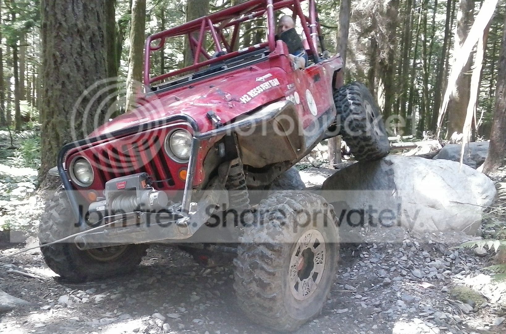

so then I went and wheeled at Elbe hills. I took some youth from my church I work with, didn't do anything too crazy, just showed them the ropes, hopefully it got one or two of them into it. I remember an EJS trip when I was 14 and I got hooked then, so sometimes I try to repay the favor.
and one more

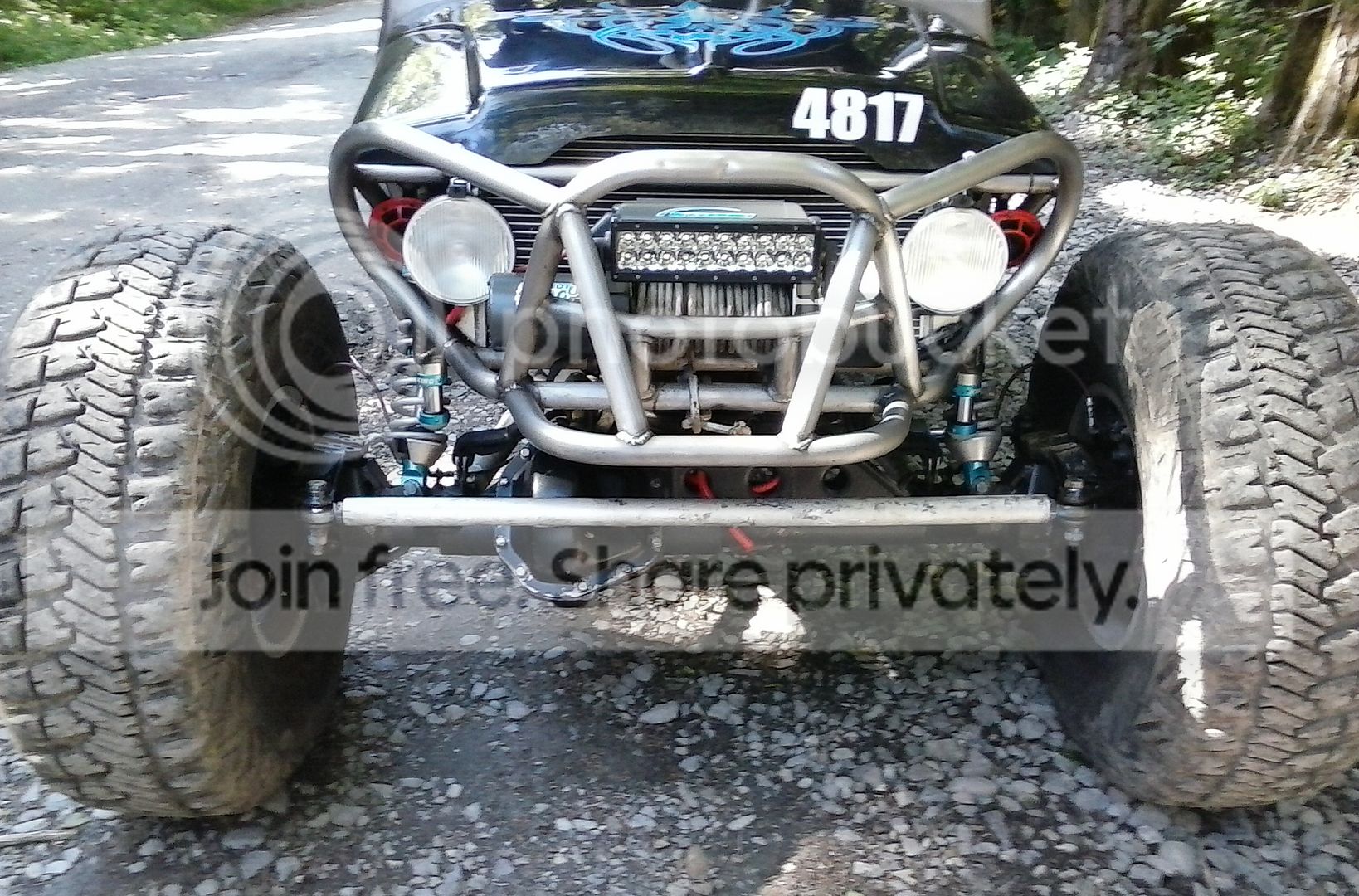

I always hated these $18 harbor freight headlights. Man are they pieces of crap... obviously. But hey, they fit my budget at the time. So time for some new headlights.
These are from sidetracked offroad, they seem to be the best LED's at a reasonable price. They light it up pretty good. I got the flood design and not spot. I want to light up 100 feet fully, not 500 feet narrow. And no this does not drive on the street, no need to be street legal.

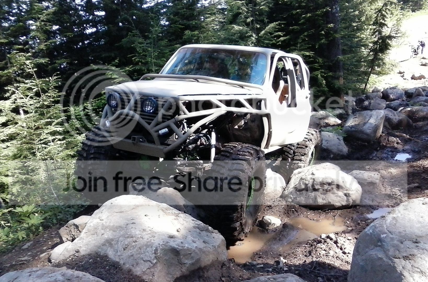

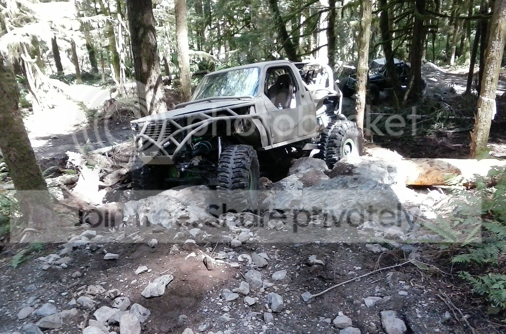

So then the following weekend I hit up Reiter Foothills with a buddy who has a trent fab buggy. I guess this place used to be rediculously huge and had tons of hardcore stuff but they shut it down and have been spending a healthy amount of money and time rebuilding the trails to be less "muddy". They basically are man made trails with base layers of small rock. It's kind of small, but what they have built is really good. Some of the best man made trails I have ever ran. I wish I lived closer so I could give more volunteer time to help build them.
My friend's buggy makes my rig look like a pile of booty fab.... which it is.
Ruff stuff 69... I have a chubby.
A well experienced, very capable tj.
That hill conquered me and the buggy. Once again I wish I had more action shots. I need someone to come along and at every good obstacle jump out and take pics... who isn't my 8 month pregnant wife.
