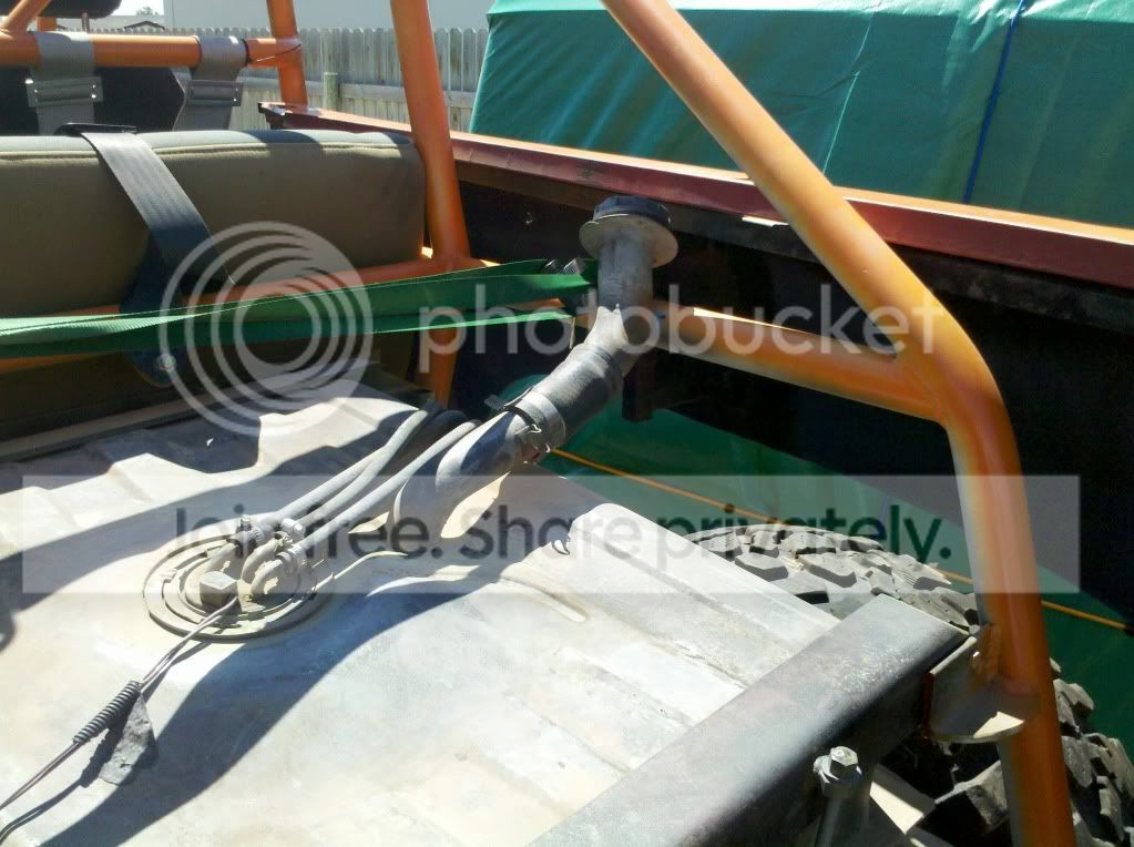

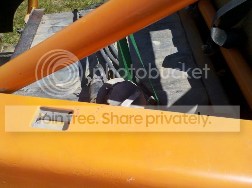

Eric I was looking through the horton pics. What are you doing for a gas filler? I can't quite see it in the pics. I was gonna put a fuel cell in but, I have the blazer tank and everything to make it work. Since I am paying for my own wedding I have to cut the truck budget a little.
It just has a the normal hose just kind of stuck in there with the vent blocked off, kind of a pain to fill but not too bad. I was going to use a fuel cell too, but already had the blazer tank, factory fuel pump etc. It has been good too, I don't think I will do anything with it till I can make my own fuel cell that used the factory fuel pump

Full tube full tube full tube full tube. Heres the pics of where my filler neck is Jess.
Pretty non creative and it takes a while to fill the tank and I doubt I will ever change it until I build a fuel cell
That is the factory blazer hose and stuff didn't even cut it down just took it out of where it was and used it
