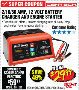

When it comes to battery chargers I just went to Harbor Freight, and bought one of their battery chargers. I got PN# 60581. I do not spend a whole lot of time trying to save dead batteries. I got this one for about $35 out the door.
