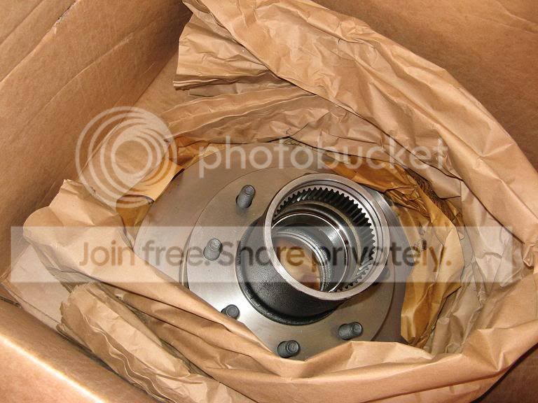

Got some stuff done. Bought some new SRW hubs/rotors for the D60, which will sit until I can sell of some of my extra D44 stuff. The D44 is solid with all wear parts having been changed. I'll keep it for a while if I need to.

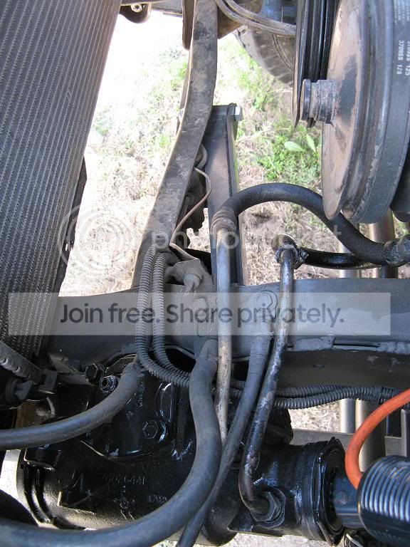

Got my steering box bolt on brace in, which complements the weld in nicely.
The Ford shock towers went in smoothly. Cut out a template to fit the frame, welded the towers to the new steel, and reused the bolt holes in the frame to mount the towers. Came out good but haven't had a chance to "flex check". I took a grinder to the original shock mount, the frame side where the "bubble" is. I ground it down just about flat and made sure the new mounts went around the slight bump. This helped move the shock top forward. Even with the axle moved 1.5" forward, the new shocks are close to or more vertical than original location.
Shock mounts look clean. But what's that orange wire? An electrical cord that's not permanently attached I assume.

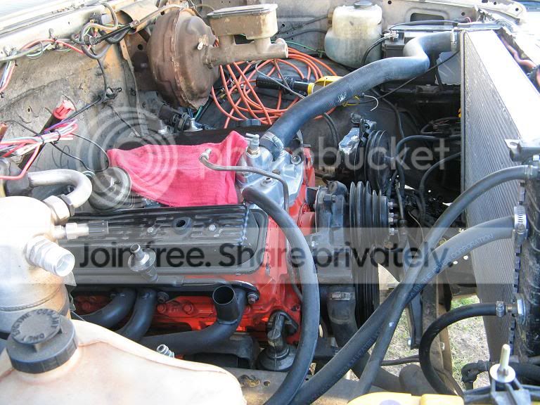

Here is the engine as of this morning :rolleyes: And a quick picture of the remote mount oil filter I put together so I could remove the filter with the new Y pipe in the way. :woot:
yep, it leaks oil from a couple different places so it's getting the "find the leaks" treatment. Oil pressure is around 12.5 psi with 20w50 hot. I don't like it. While it's out, there might be a slight change in things as well :whistle:
Are you getting that 12 psi number from the stock oil pressure gauge? I'm not sure I trust that thing. Mine jumps all around from 12 to 20 psi and I know I've got more oil pressure than that.
Thats a good point. My stock one is all over the place, but i only pay attention to the mechanical one
autometer sender and gauge, also tested with a mechanical gauge
