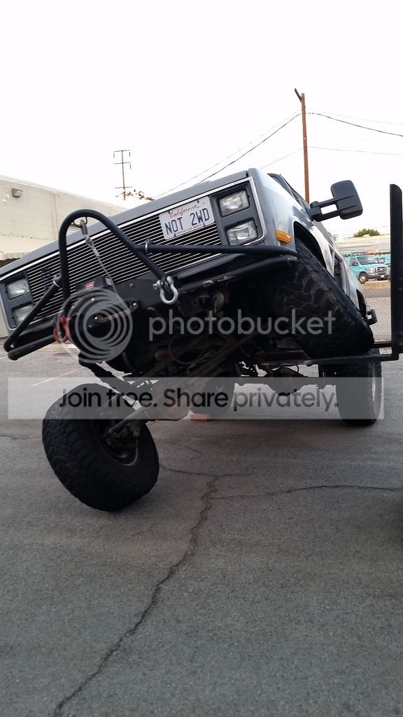

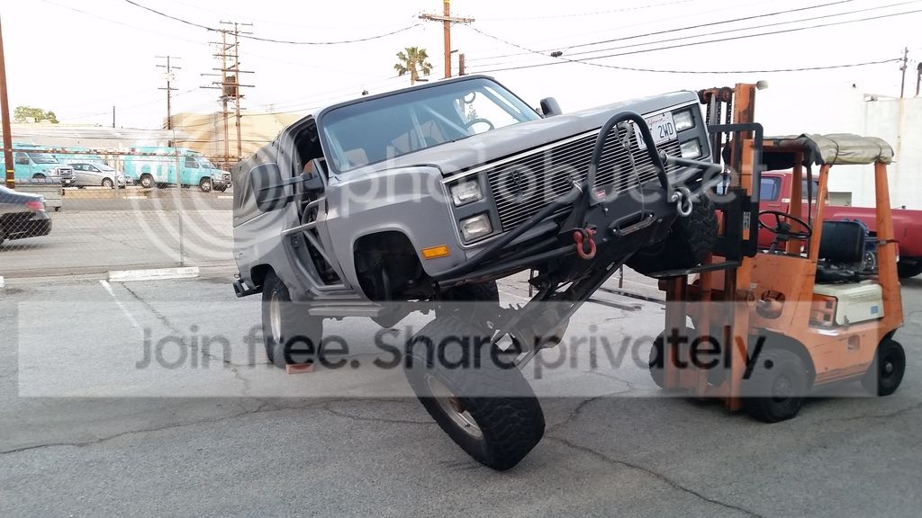

Got 38.5" of tire lift just as the back tire got light. IIRC had 3.25" of DS stroke between lifting driver side vs passenger. There is a difference of 15.5" between the driver and passenger shock lengths in this picture. My shocks are only 14" travel, so I will be fudging the uptravel some. Plus I think I'm going to 40s, so I gotta try to keep them out of the sheetmetal. When I lifted the passenger side about the same height, my draglink was maybe 3/16 from the frame with wheels straight. I will need to limit uptravel a little more on that side so it doesn't make contact when turning passenger. From the bottom of the brakeline bracket, to the top of the spring plate was 6".
Interesting
I guess I can see the axle staying a little more centered under the rig. It tends to shift some when pick it up. I know there is more droop than what I got here, but I only have so much shock stroke.
The question now is, do I struggle to get a hold of the forklift guy again? He's so deaf, he doesnt hear his phone even when sitting on a table in front of him. Lol
